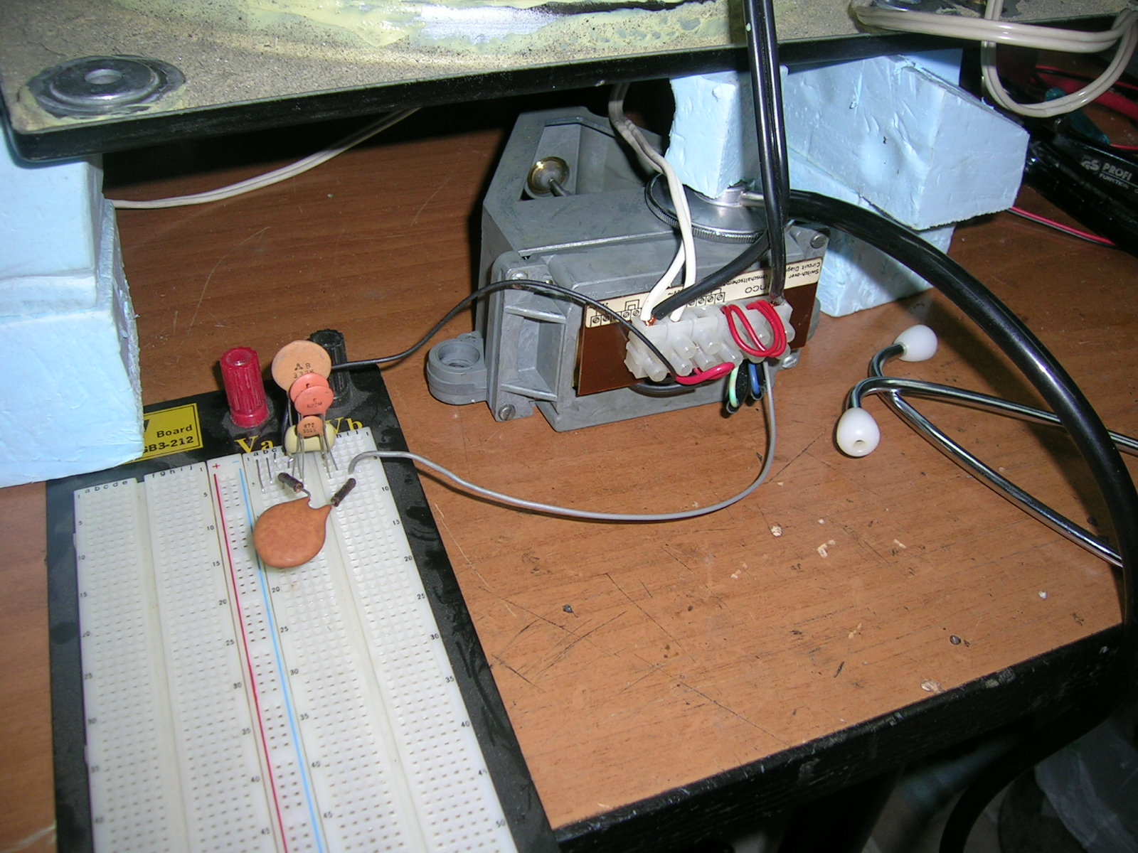

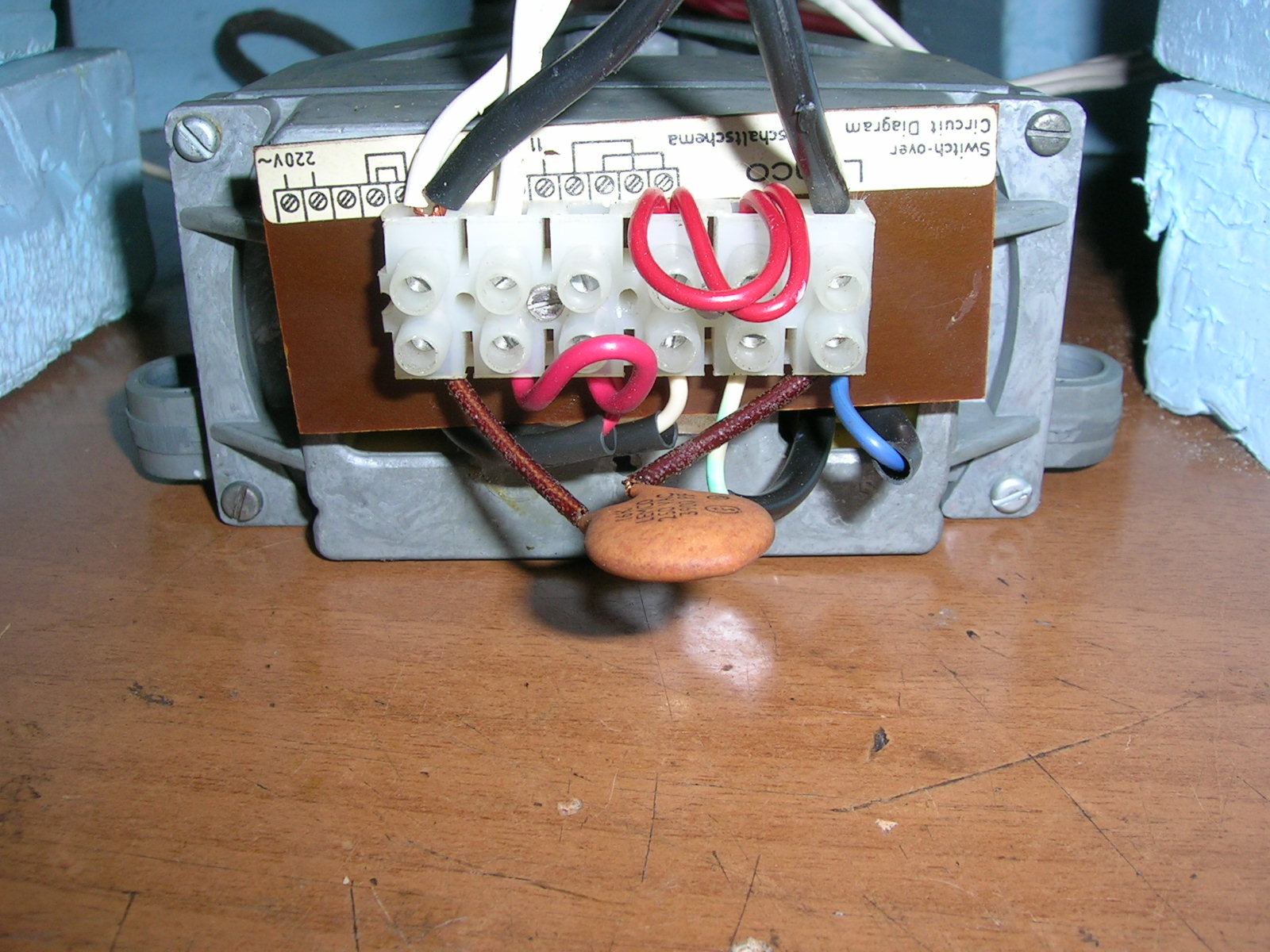

George - the voltage the capacitor can be more than 240V, thanks to LC resonances. Your capacitors look like they may not have a high enough voltage ratingI agree. It worth the effort.
Thanks David.
These test capacitors you see are marked as 500V.
As they are not AC line rated, this voltage marking refers to DC.
The original cap was 250V AC.
Have you checked with an oscilloscope the peak to peak voltage under resonance? ( I haven’t).

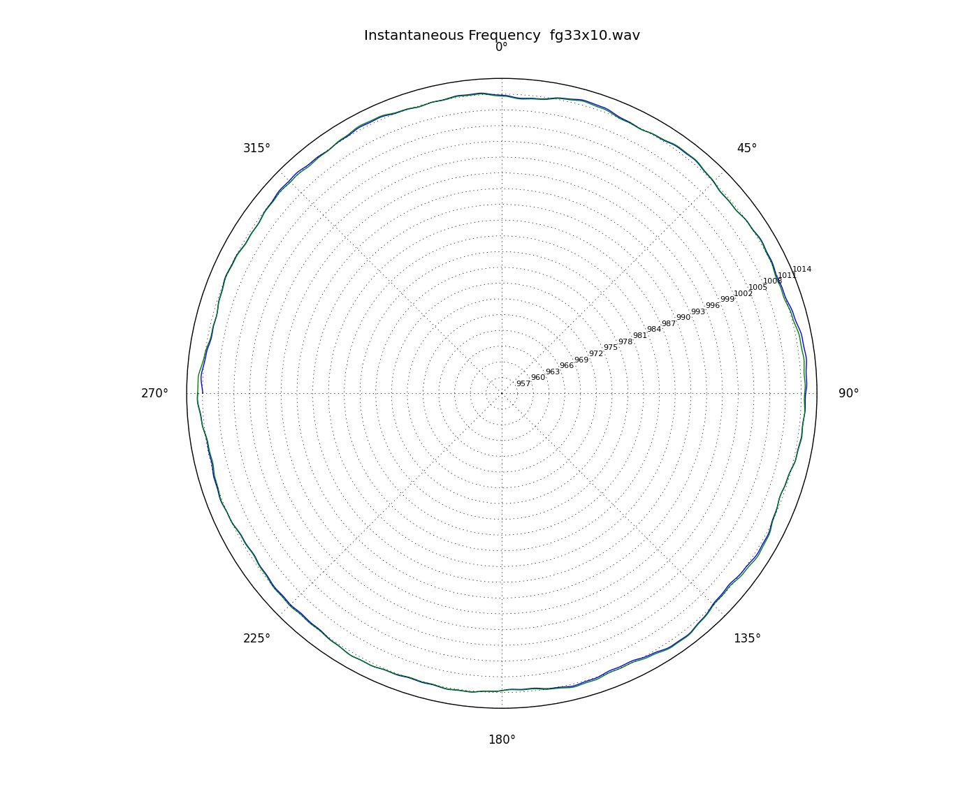

Just playing around with this a bit.
The FG on the MK3 is ~100Hz @33. I changed the speed of the captured file x10 in Audacity, and then changed Scott's code so that .18s = 2pi radians.

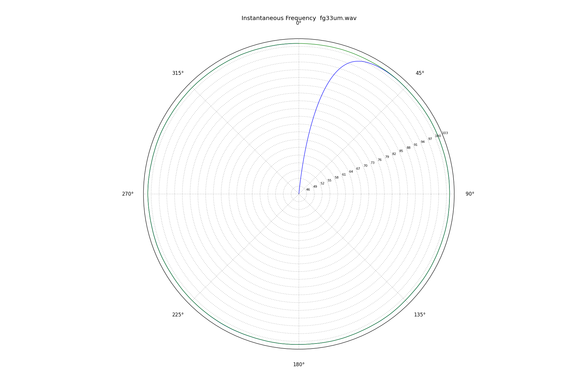

The radial ticks look like they are at the default 22.5 degrees. There should be a line setting them at 90, did you comment it out or skip it? Looks like things still make sense.
My install of the plot library doesn't like set_rlabel for some reason.
I see, the polar plotting is recent and poorly documented folks are gradually trying to get things that don't work x,y the have a radial equivalent.

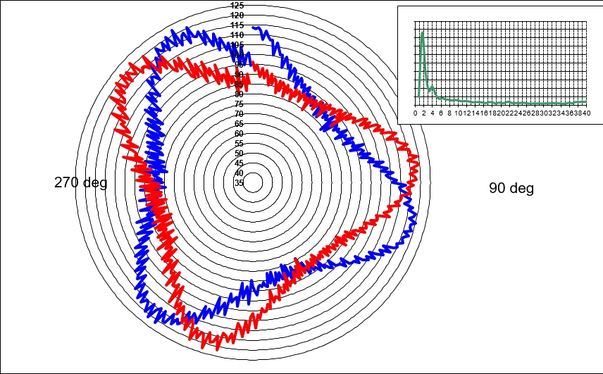

To obtain an inset FM frequency spectrum graph, I just take a FT of raw display data and display the result. IMO, this is essential to help diagnose causes of pitch instability, and I have some time today to get my head around displaying the magnitude units sensibly...... I've got by because knowing the frequencies at issue is the key to diagnosis IME.

If I wanted to run the ~100Hz FG signal without manipulating it, is that possible? If I change the filter to 10Hz the plot looks too good to be true:
At 10Hz the filter transient gets pretty long for one thing, also as Pano said to make a large frequency range useful one would want to adaptively adjust the ticks. You could try again changing the 3's in the tick step formula to something smaller. Another problem is that group delay in the filter starts to distort the positions of the wiggles at low frequencies. Trying the linear phase back and forth IIR is also on the table.
The filter transient issue is important enough that the signal processing package has several functions to preset the filters to reduce it, I might give that a try as well as adding the no need for quotes.

Thanks, the FG signal is very interesting JP.Just playing around with this a bit.

Here's the FG signal polar plot, directly from your raw file JP using my software. 2 successive revolutions.
I'm not sure if the dither/flutter is real or an artefact of working at such low carrier frequency - I haven't tried it before this thread but it should work and the result looks plausible enough.
Very interesting, and very pretty 🙂
