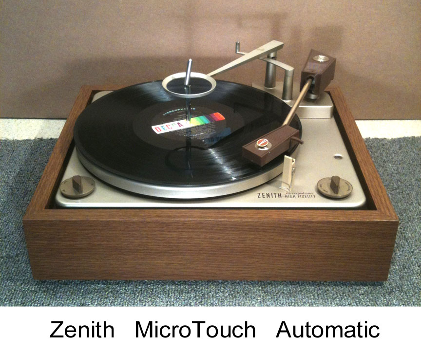

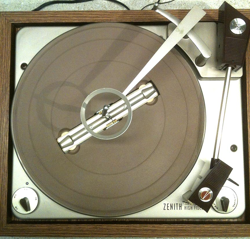

Chris, back in the early 1960's, (1961-66) Zenith made a hybrid record changer featured in their top-line console stereos. - The "MicroTouch 2G"
It had a two pole motor with a stepped shaft, which drove an idler, the idler drove a small flywheel, which in turn drove a belt to turn the platter.
The platter was a two-piece affair also, with three rubber isolation "bumpers" for the record platter to sit on.
While sounding complicated, it worked extremely well, with very low rumble/wow/flutter.
Friction-free knife-edge vertical bearings and ball bearing horizontal pivots on the tonearm allowed for that 2-gram tracking.
Some nifty features were a retractable 45 RPM stack adapter that literally folded down into the platter for LP use, and a retracting soft stylus dust brush that exposed itself from the tonearm rest post every time the arm moved over it.
That era of engineering was marvelous in my opinion.
I recently sold one of these changers to a guy who wanted a stacker machine.
Taken from a console, I made a nice base for it to be used as a "stand alone" model to be used with any MM phono input (original "floating" ceramic wired with an equalizer network to drop level for mag inputs.)
And I will say that after my servicing/overhaul/upgrades, this machine played records as nicely as a modern machine.
This is the turntable I sold...
