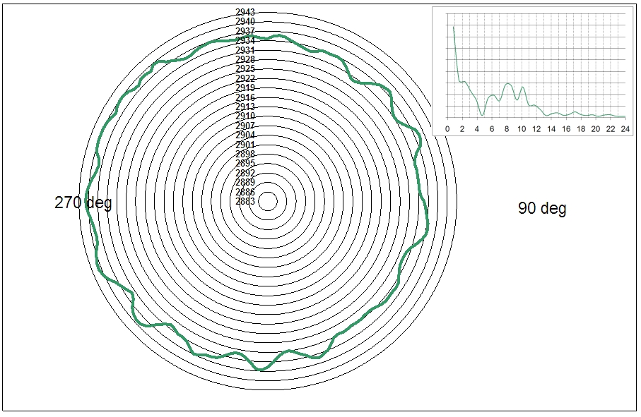

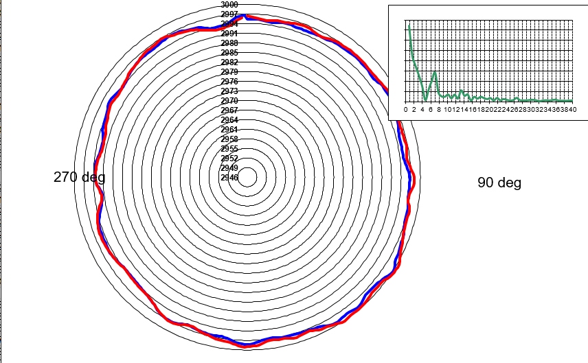

Now whilst I agree that all turntables have a distinct signature the great thing about 2019 is that we can measure it and work out what needs to be fettled to make it better. Hopefully in time we can work out how to repeat what Korf is doing with tonearms at home as well.
Attached are speed stabilty plots of an SL1200 vs an LP12 done on this forum. The SL is well fettled and I think the Linn needs a bit of service, but you can see there are a lot more modulation sources on the Linn. If you put those side by side the Linn would be more coloured. It might be preferable but certainly not more accurate.
What we should be looking at is how to improve ALL tables with the tools available rather than rehashing old battles 😀

That is ONE function of a turntable. There are others! As I have stated, once people climb out the trenches and step into the 21st century you can actually measure this stuff and fettle your turntable to the best of its ability.
