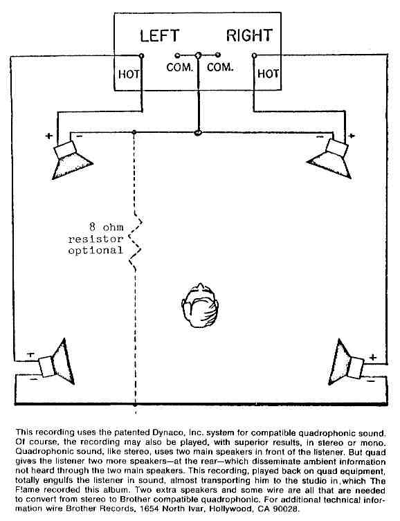

Do you remember the 'Quadraphonic Synthesisers' like this one from QED?
They fed the out-of-phase information present in all recordings to a second pair of loudspeakers placed at the rear of the listening area.
I experimented with such passive DIY surround sound circuits back in the day. The rear speakers did provide some extra ambience, but the results were ultimately dissatisfying.
You look at the stuff people are doing on ambience on here and there is still an interest. The problem is it only works on certain programme. But Hafler surround never really caught on...
You surprise me Chris!That stuff is still out there and being used.
I now wish I hadn't thrown an unused factory built unit into the bin some years back!
The attached circuit shows how to produce 'surround sound' on the cheap. Note that the two amplifier channels must share a common ground.

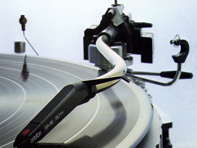

Lightweight/super tracking certainly was a thing in the 70's. Everyone wanted to track the cannon fire in the 1812 overture. That's when the compliance race took off, with cartridges from ADC, Sonus, Shure.
The SME III arm was designed specifically for a high compliance cartridge, namely the Shure V15 type III.. The competing tonearms were the infinity black widow, Grace 707, Mayware formula IV. I owned all but the Grace. ( and not the Hadcock either ).
My pal was using an ADC XLM on a Vestigial tonearm. The vestigial boasted that tracking forces as low as 0.1 gm were possible.
Then along came the Japanese with the Dynavector 505 and the Fidelity Reasearch FR-64s using very low compliance moving coil cartridges.....which was another "thing".
I think you mean V15 type IV? I have two SME arms, a Series 3 and a 309. I reckon I have most sane bases covered for effective mass . I also have the 30H armwand for the series 3. 4.5g effective mass including the cartridge.
Personally I think most modern cartridges are still too high compliance for modern arms, but that is entirely my view and I don't expect this to be shared by many!
