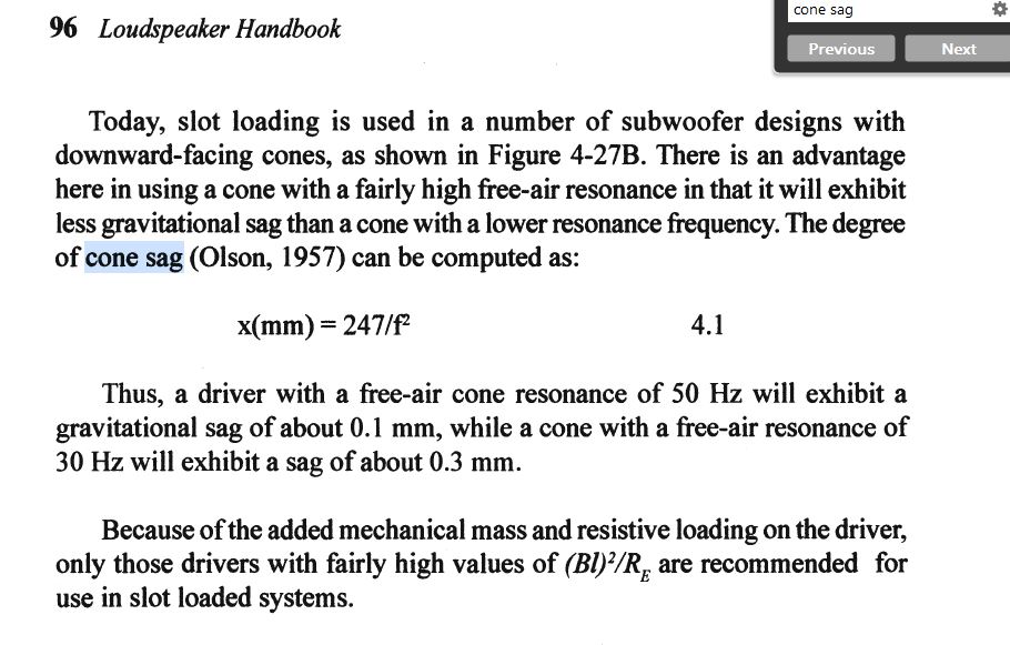

Cone sag is a very real, commonly acknowledged phenomenon, with prosound sub drivers.
15"-18" are defintely susceptible, don't know about smaller drivers.
I found some decent engineering data, a formula for assessing cone saq, tha i can't find how i saved.
So here's the best I can offer...a cut from Eargle's classic handbook...
I can also say, from asking BMS engineers if I should be concerned about cone sag,,,,
.... the answer was drivers can't help but decenter their resting position over time, when horizontal. That ideally, drivers would play 24/7 continuously !!

This is not what I disputed, anyone who had some physics will understand the effect of gravity. My inquiry was about support for the the claim that (emphasis supplied):Cone sag is a very real, commonly acknowledged phenomenon, with prosound sub drivers.
as I have never seen such data. In other words, is the (alleged) suspension failure a fact, and even if so, does it manifest itself during the driver's lifespan? Does, e.g., Danley - to give a pro-sound driver application - advise to rotate the Unity/Synergy so that the suspension on the bottom and top drivers are not ruined?gravity will ruin the suspension over time

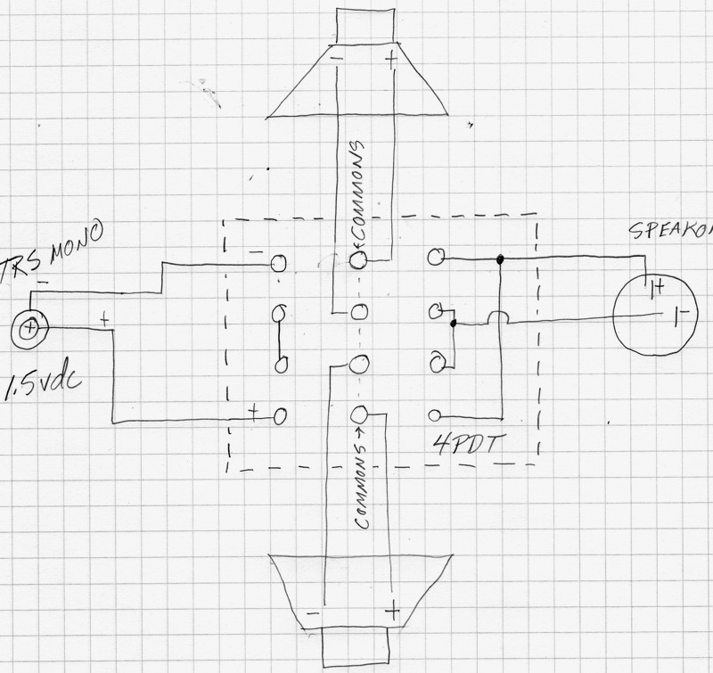

I made a low voltage, DC gravity offset switchable when not in play, for my PPSL subs with horiz 18"s.
It has as proven to work well over about 6 years now. Keeps the cones "gravity free".

H, ha, how did you determine the voltage needed to return the cone to the neutral position?I made a low voltage, DC gravity offset switchable when not in play, for my PPSL subs with horiz 18"s.

Hi m,H, ha, how did you determine the voltage needed to return the cone to the neutral position?
this guy got me started me on how to determine the voltage needed. https://forums.prosoundweb.com/index.php/topic,166841.msg1538797.html#msg1538797
He was correct, with 0.6v for one driver. I just needed it to work for 2 drivers, one inverted from the other. No biggie to work out.

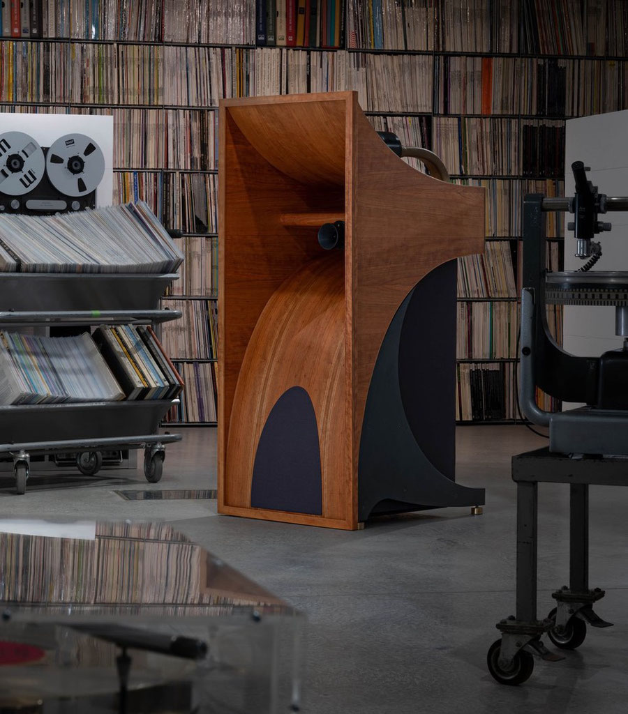

-How did the Tune audio Epitome got away with a relativly norrow horn, asymetrical so it seems.

Seems to sound great 😀 got some directivity right there. Recorded with phone? Is it mono setup?
Listened with phone, sounded great, doesn't sound like it was a recording of loudspeaker playing a recoding 😀
Sounded amazing!, a 97 year old speaker, playing a vinyl record, recorded by myself on my Samsung galaxy, through all this one can still get the presence and speed and ease this speaker gave. I think it was a mono recording...
Any way an easy best of show
- Tune audio Epitome
