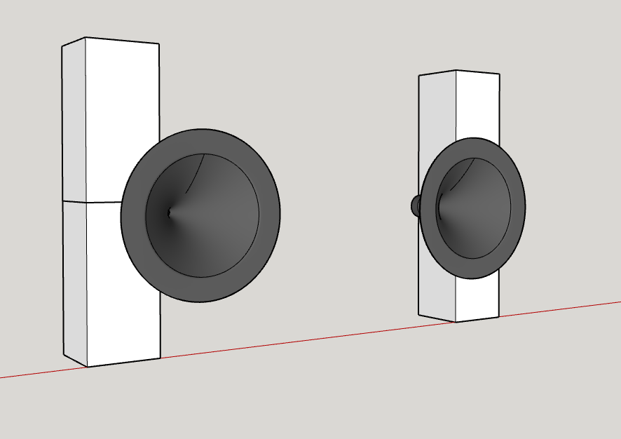

Follow what others have done. Read the Unity horn patent. Do lots of experiments changing one variable at a time, port lenght/shape/location, volume under cone, distance from hf source, etc. You will quickly learn how these things work. Learn VituixCad and ath4.Congratulations on an excellent project 👏, where should I start tackle such a feet? If you have some reading sources that might help, I would highly appreciate it
This is what I did. It's not hard, you just need to go through all the steps and realise you will be making a lot of prototypes.
Thank you for the advice, truly appreciate it.Follow what others have done.
I am very new to horns and as for now it seems like a mountain (a scary one) of knowledge I'll have to tackle...
What brought me actually to horns were the last Western Electric presentation of piano play I heard in this year munich... a 97 year old loudspeakers play faster then any modern speaker I heard at the show. Maybe the Silbatone equipment helped a bit as well
But since then I'm hooked!

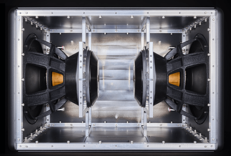

By the way, are you familiar with this type of bass horn loaded construction?Follow what others have done
Would be interesting getting the benefits of closed sub- two woofers opposing each other and well load them with a horn to raise Efficiency and sense of speed?

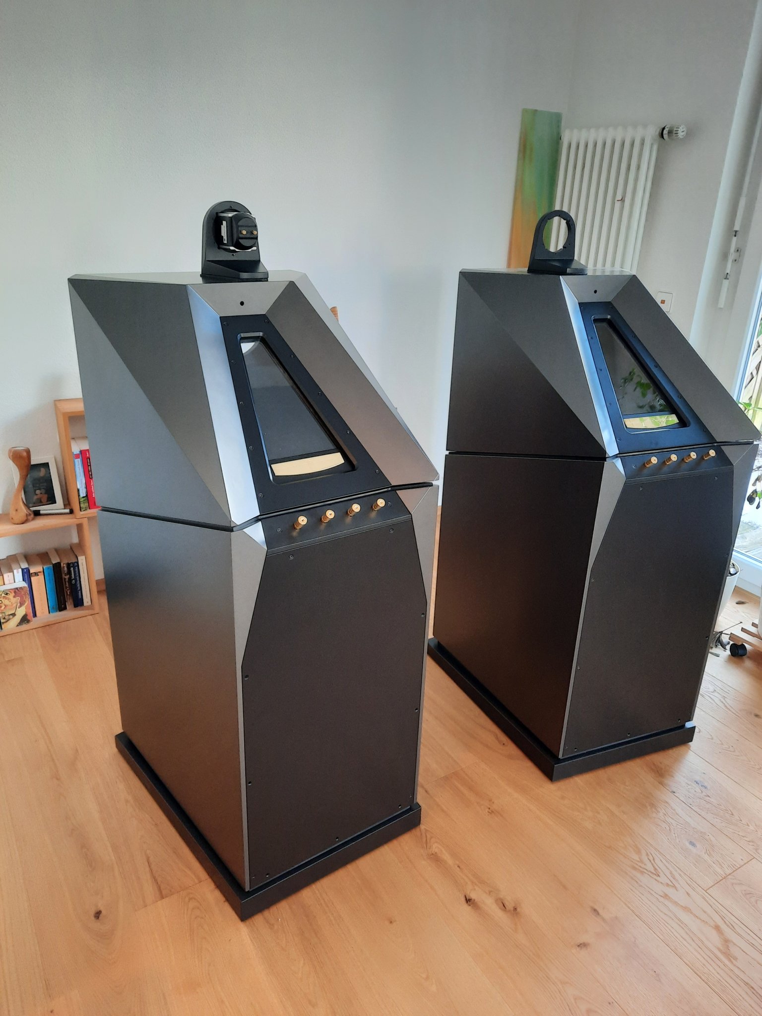

I like the approach of targeting a €140K speaker as your first one to make.
have a read of this thread loosely based around Tune Audio Anima
Tune Anima

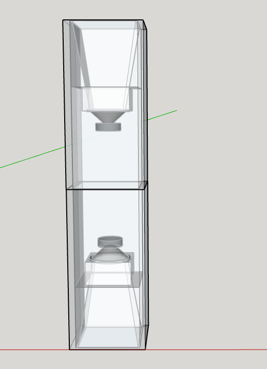

All hypothetical, I am aware that something of this magnitude may take a life time.like the approach of targeting a €140K speaker as your first one to make.
That being said, I have a bit of experience on building speakers, but not on developing them, I know that's a big difference 😉
please do not mount drivers horizontally ... gravity will ruin the suspension over time
keep acoustic centers close together
account for minimum delay between drivers to get good summation at maximum bandwidth
SPL MAX at distance X should meet your requirements depending on input power , lower cut-of frequency vs driver area/Xmax ...

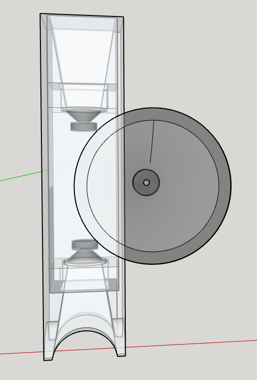

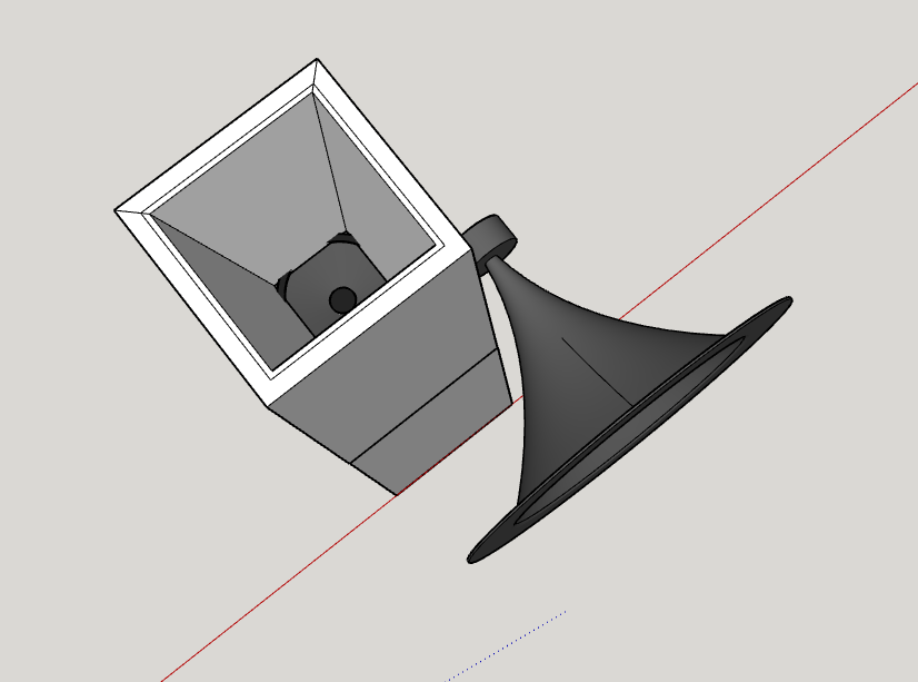

YES it is a NANO horn 🙂Horn loaded, am I wrong?
when thinking about horns please think in WAVELENGTHs!
Maybe into the midrange you can consider what you drew as horn loading or a waveguide.Horn loaded, am I wrong?
Size required for a classic horn design that goes into the low bass region:
https://www.passdiy.com/gallery/speakers/the-kleinhorn-part-1
Also consider things like the Klipschorn that used the room walls to extend the bass horn to reasonable frequencies. Bass horns get big fast.
There are more modern ways to shrink them some with limited degradation, but even those are much larger than what you were thinking.

Got it 😅 I'll call it a waveguide and be done with itYES it is a NANO horn 🙂
