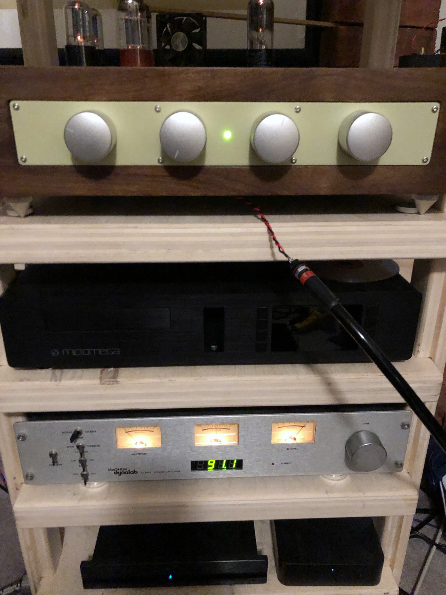

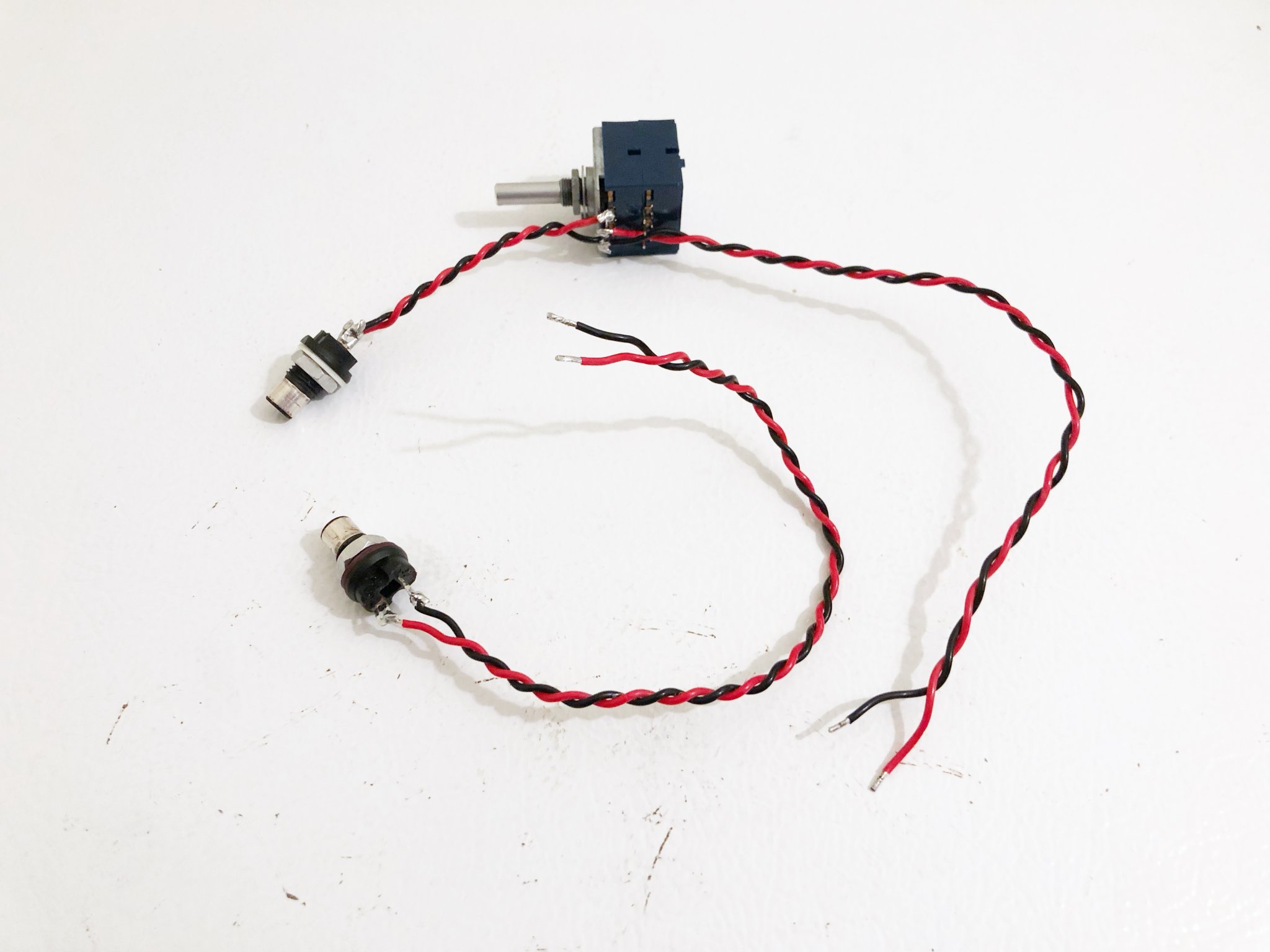

I’ve started making the wires/RCA’s to try bypassing the rear panel/RCA/wires there.
Going to just run the new in/outs to the outside of the chassis so I don’t have to disassemble the rear panel completely.

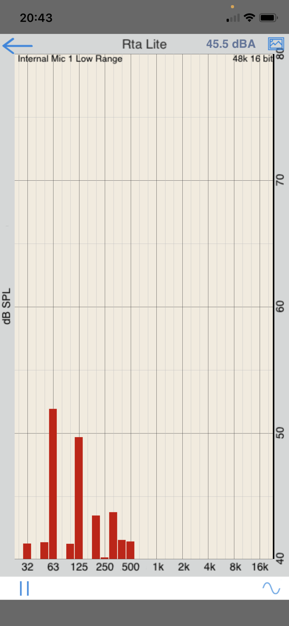

Yeah, guess I gotta figure out this scope…We need a systematic approach here, I am afraid.
The hum waveform can tell us more.
Suspect I could build a new amp by the time I figure out how to use it 🙂

Going to just do one channel.
Will disconnect all input/output wires, and connect this to the right channel input, and the right channel output.

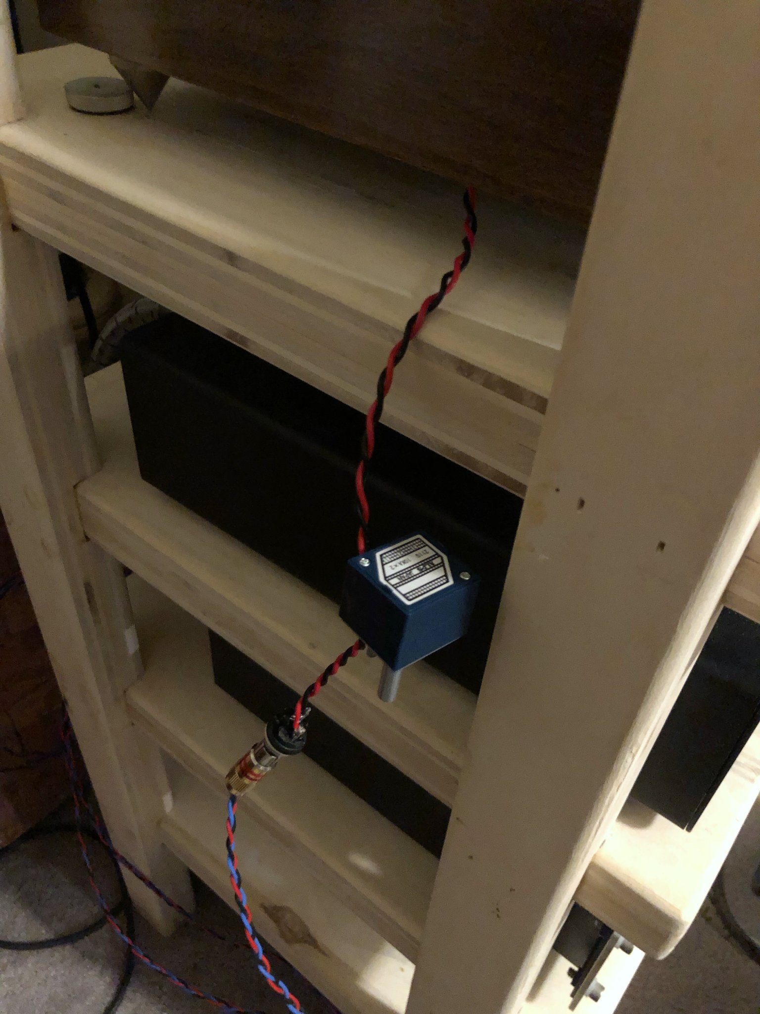

Hooked up the twisted wires, ran a single line to the right channel and much less noise. But it’s still there…
Now, these wires are outside of the box, so are subject to a lot less noise from the amp.

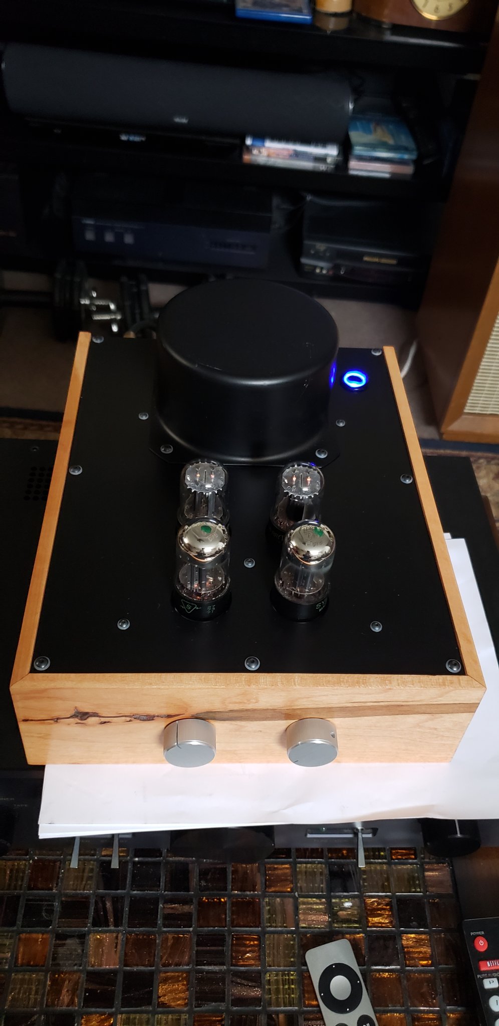

I’m starting to feel like I’ve thrown everything except the kitchen sink at thus to try to fix this hum…
I’ve moved the power supply caps L/R - noise remained in right channel.
Gone through this again and again. Trying different things w the ground.
As the unit sits now, it is grounded exactly as the instructions say to ground it.
Through this process, the two things that have helped are grounding the top metal plate, and moving the input/output wires outside of the box.
Aside from that, using the DIY Audio VFet, with the supplied SMPS and a non grounded power cord has provided the sound w the least noise, only barely audible with ear pressed up against speaker (102db sensitive…)
