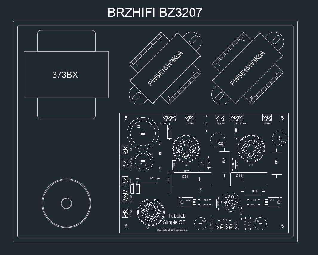

Can you guys see any issue with the OT's mounted 45° rotated? I am just wondering if it might cause any additional interference with the power transformer?
If mounted vertically, the fixing bolts would be under the PCB, very close to B+ which makes me feel a bit uncomfortable.
