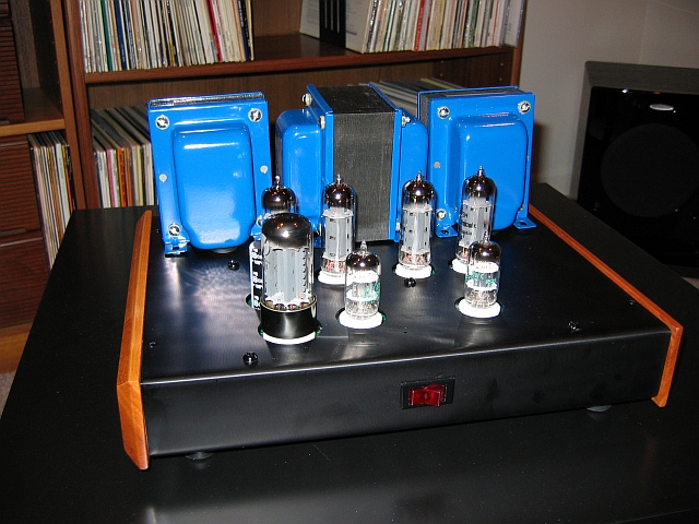

Before I put them on my new Millett DCPP, I just sat them on the unfinished Tubelab SP-P, to see if they fit (they are the same physical size).
Tight but they fit. My wife says the amp looks "cute"...:rolleyes:

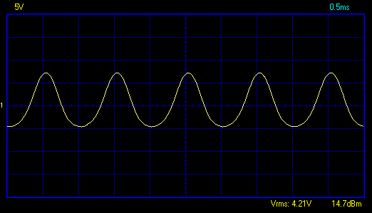

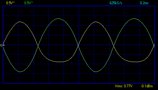

Well, I don't think there is anything really wrong with them per se. They are not working like NOS tubes do, though. Those all seem to work fine in this amp...at lest the ones I tried and the ones George uses. A strong JJ tube also works fine, but as they wear this is going to be the result.
The problem in this case stems from the fact that the input stage is DC coupled to the phase splitter. So the operating point of the input section sets the bias of the phase splitter. At least that my take on it.
I got all the "bad" tubes to work by replacing the 75k input plate load resistors (R106 and R206) with a 120k or 150k. 150k helped the most. It had an overall positive effect on the distortion spectra of the amp, but I don't know if it had a negative impact for tubes that worked well before.

Neon, nice build, thanks for the pic. Hope the new tranny's arrive soon.
Ian.
Hey, Ian, thanks for that nice comment!
Yeah... as the rest of you get your SP-P boards playin' music, I'm waiting on Edcor (sigh). At least they do seem to produce a quality product at an unbeatable price. Those xfmrs in the SP-P picture are now making amazing sound in the Millett amp. If they do the same for the Tubelab P-P, I'll be surrounded in great music.

I find (especially in the Simple SE) that most NOS 12AT7's will generate less distortion when fed more current. That is the case with the Simple P-P too. It is also the case with the Simple P-P that the current in the splitter is determined by the bias conditions and the tube characteristics in the input section of the 12AT7 since they are direct coupled. The resistor values on the parts list work great with all of the NOS 12AT7's that I tried. Russ found some distortion in the signal at the output tube grids when some new production tubes are used. This is more evident with worn tubes. It is possible to make the signals look better on the scope traces with these tubes by changing resistor values, but this doesn't seem to translate to a better sounding amp.
My FFT analyzer is not running at this time since the old computer died. I plan to experiment with this a bit more and at least come up with a set of resistor values to use with these tubes if it makes an audible or measurable difference in the overall amp. Unfortunately I must make a trip to West Virginia next week and I will be gone for about 10 days. No experiments until I get back. On the bright side I should be able to stop at the Dayton hamfest on the way back so I should get some new stuff to torture.
