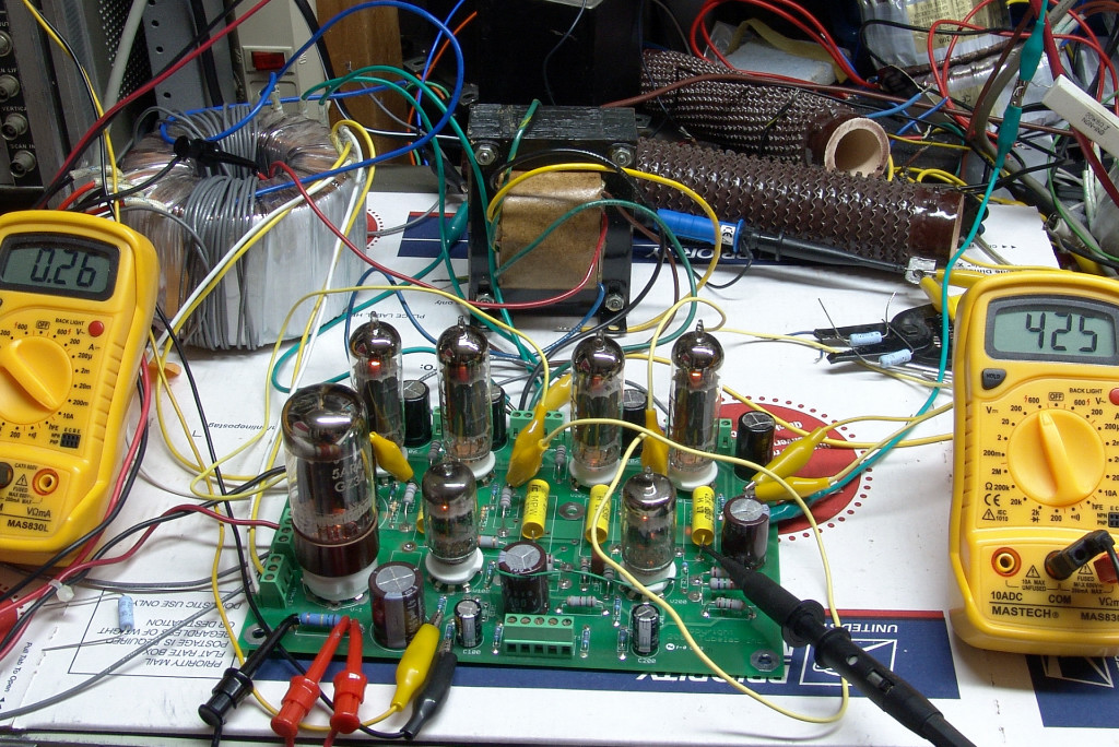

My boss went home early with the flu today, so I left early to work on my Simple P-P. This is the first time I have worked on it in about 4 weeks.

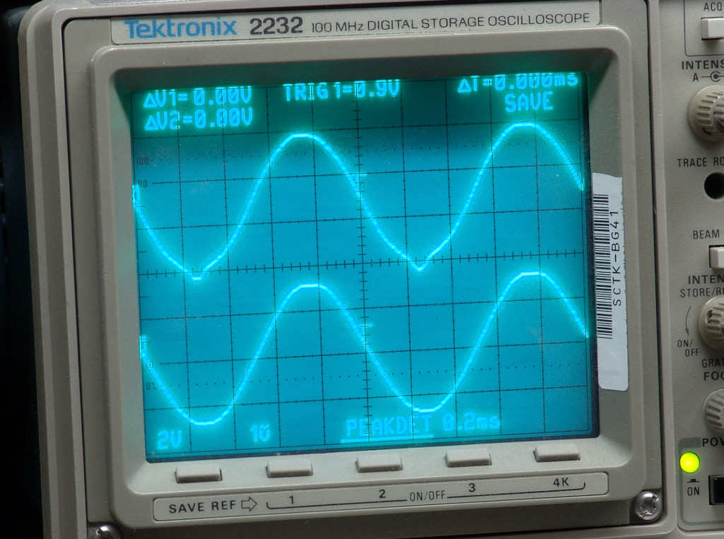

There were two issues I was seeing. One was the weird "nipple" distortion effect that looks funny but is probably not that serious since the output tube in question is already in cutoff. It looks better with bigger stoppers, but I didn't compare distortion spectra between them.
The main reason I sent the tubes was because I noticed a lot of asymmetry even at low input levels with them...especially those two used JJ and the two brand-new EH tubes. Did you notice this? When I put a meter across the grid and cathode of the splitter at idle, I always saw a nearly zero or even slightly positive Vgk. That explained why it had no headroom on the upswing and gave the amp higher 2nd order distortion even at 1W output. Increasing R106/206 addressed that for these tubes and gave the splitter the headroom it needed.

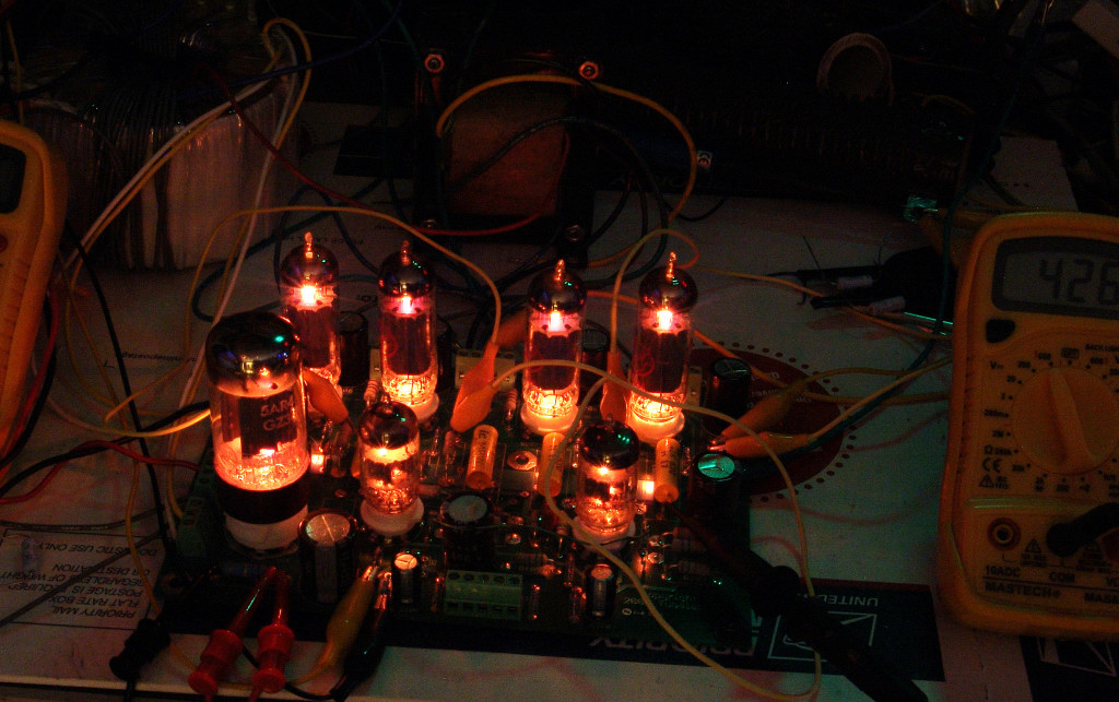

OK, it finally rained today. In fact it was rather nasty outside all day, so I got to experiment with the Simple P-P.

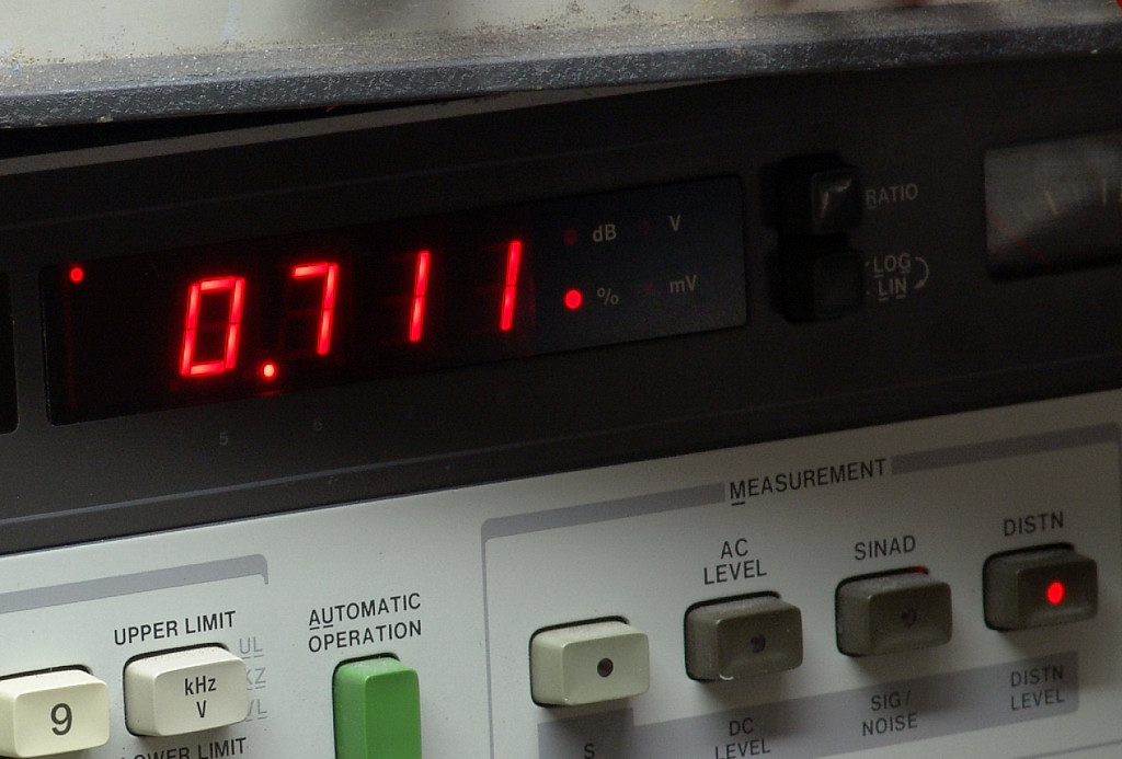

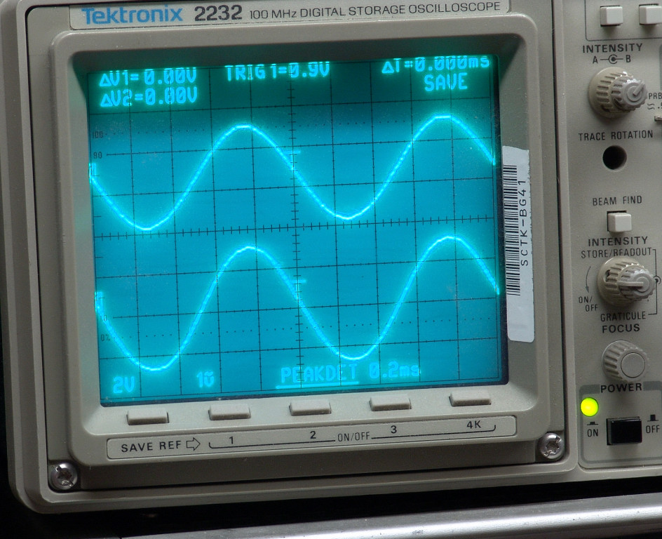

I compared your tubes against a randomly selected pair of old GE's that were on my bench in the amp that I have been working on. This amp has been modded a bit, but ALL of the components in it are as per the published parts list. The mods are in the output section and intended to increase the power just a bit. Both channels in this board are wired in parallel through a single OPT, so this is a PPP setup. I first tested the amp at 10 watts with my GE tubes. The total distortion was 0.46%. I tried several combinations of your tubes to find that the worst in this amp are the EH tubes. With these installed the distortion at 10 watts is 0.97%. The scope traces for the grid drive on one output tube and the speaker output trace overlay perfectly after adjusting the gain on one channel.
So I cranked the drive up until I could see some obvious distortion on the drive going into an output tube. The first photo shows the obvious assymmetry on the top trace. The amp was making 3.4% THD at 58 watts output at during this photo.
Next without changing anything, I simply replaced the EH tubes with the GE's and made the same measurement. The second photo shows no assymmetry. The amp is still making 58 watts, but the THD is now 1.1%. Clearly something is not right with the EH tubes, but the numbers would have appeared acceptable, until you tried the GE's.

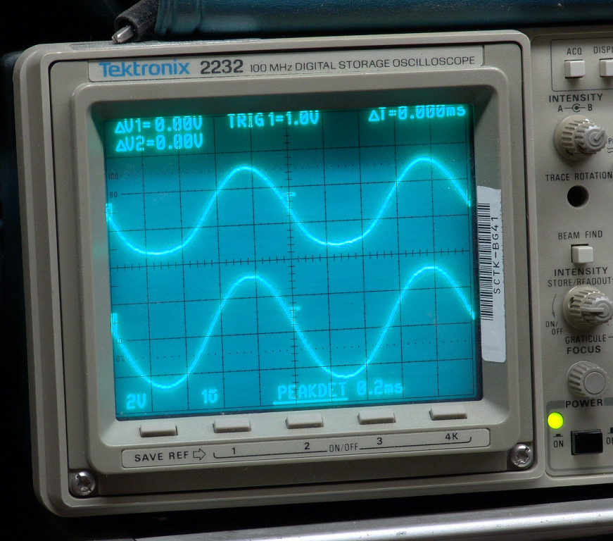

THe third photo shows the nipple effect. Here I cranked the drive up until the nipple appeared. The power output is now 60 watts and the THD is 1.8%. The amp is entering clipping.

The trigger seems to be a cold biasing input section. There is not enough drop across the plate load to properly bias the phase splitter. The JJ tubes are (unexpectedly) worn, as I mentioned in my other thread and they test in my tube tester that way. However the EH tubes are not only new but also test strong in the tube tester. So they have good transconductance but bias cold in DC. The Chinese tube I sent you isn't that great either, but it is better than the EH tubes.
......Clearly something is not right with the EH tubes........
