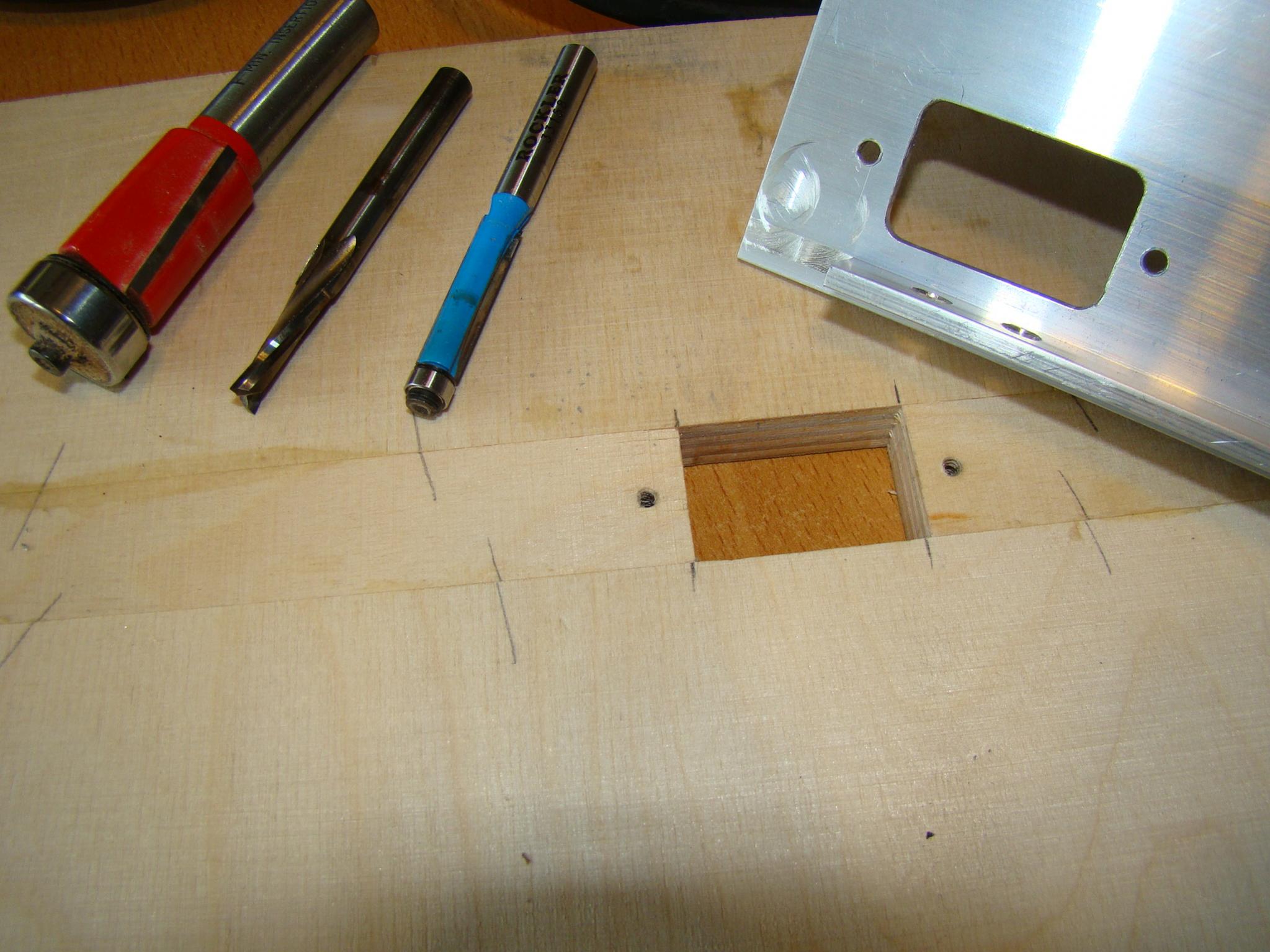

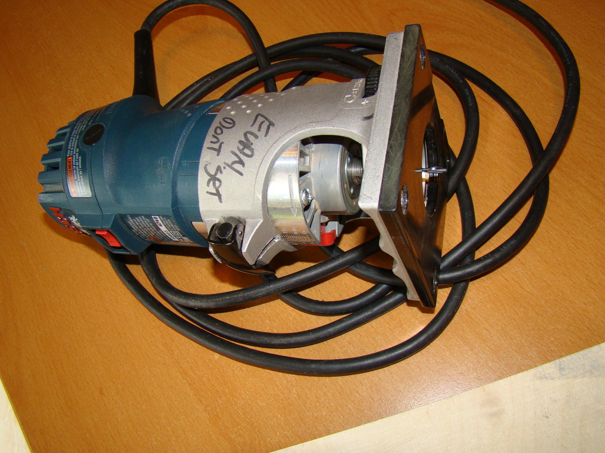

This is how I would do it.....Not the only way just my take on it.
I would not try to get the center and surround from the same piece. The kerf from either a reciprocating saw like a jig saw or a cut off wheel are going to be too thick as well as too raged for my taste.
I would make a pattern and cut out the hole with a jig saw staying well back from the line and then finish to the final size with a router. Either the bearing riding the pattern or the shank of the bit riding the pattern.
Make the center section from a separate piece cut on a table saw or again roughed out with a jig saw and trimmed to a pattern with a router.
Sorry I don't have more/better photos.
That looks great, Evan. Love the rounded corners of that rectangle. Thanks for the pointers.
