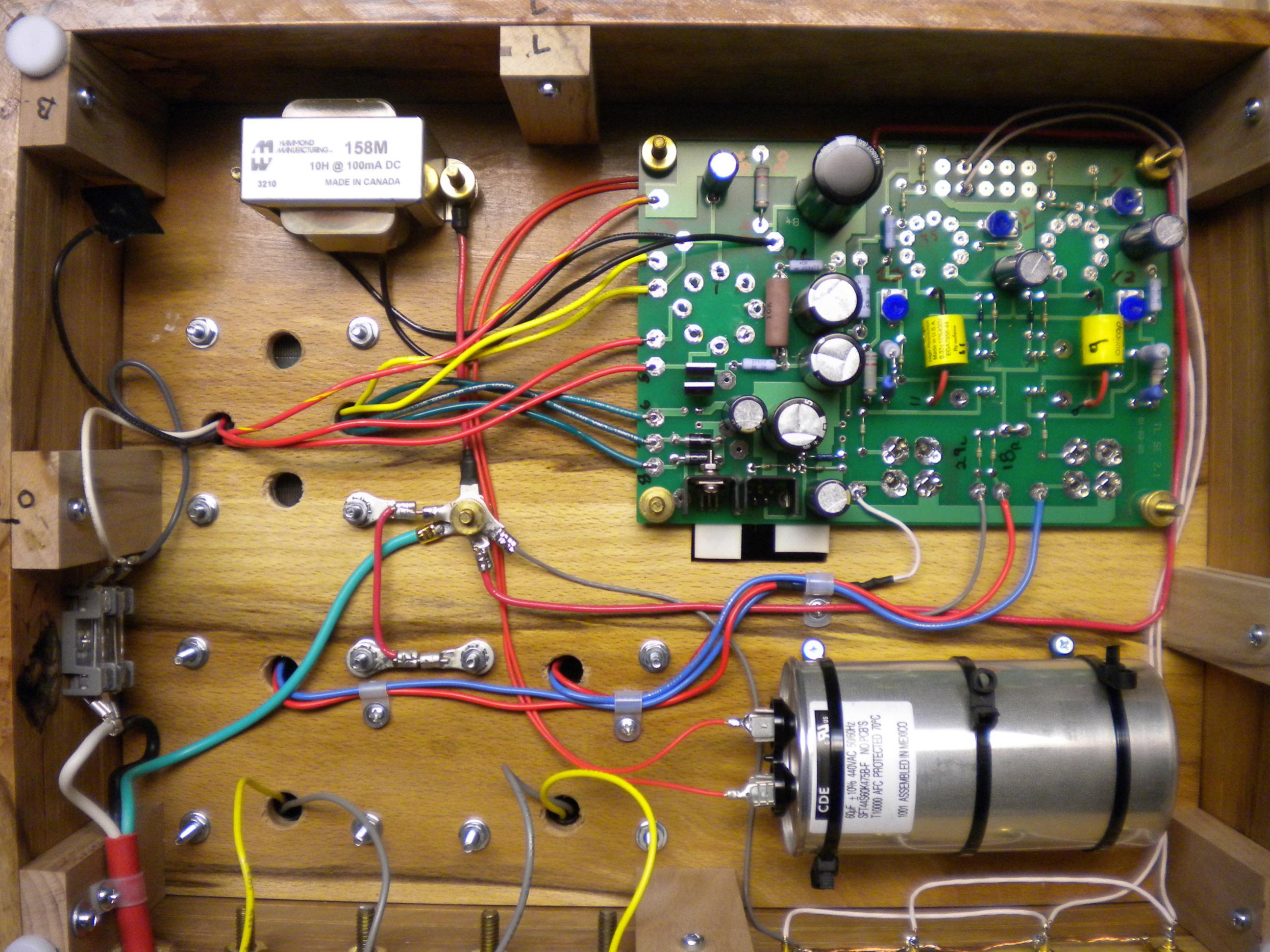

I've finished wiring the board and magnetics based on how I understand the TSE and PT schematics.
Wired PCB by jeffdrouin, on Flickr
I still have to ground the speaker binding posts, PCB, wire the tip jacks, etc., but am now turning my attention on the power inlet.

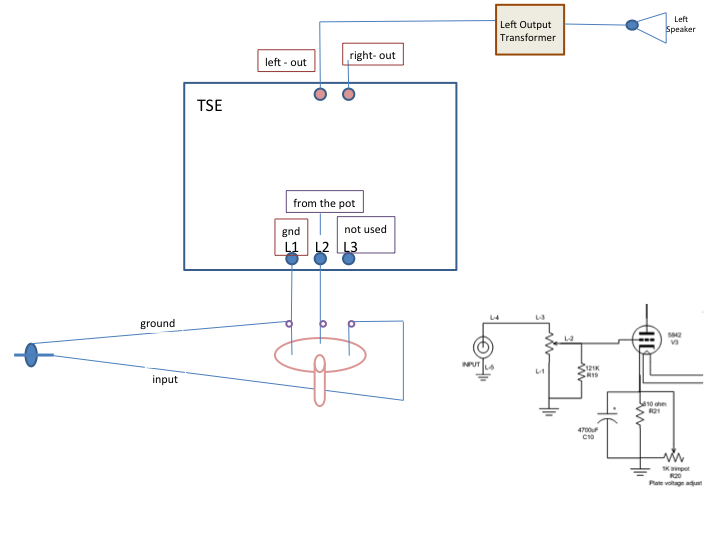

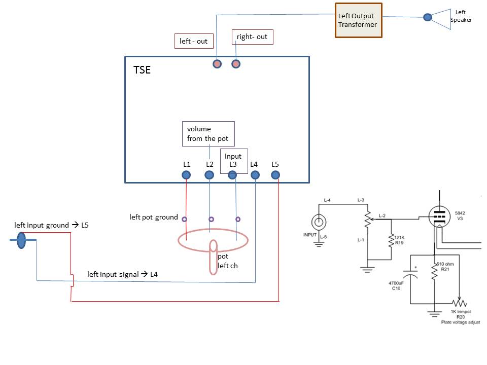

I'll be playing the TSE directly from a CD player at first and have been thinking about volume pot wiring. I haven't been able to turn up much information about it by searching the forum, except for this thread initiated by gmonno.
There are two possibilities that I'd love to get some opinion on.
This one from gmonno, which uses all five pads in each channel:
And the one attached below, also from gmonno in a private message, that uses only pads 1-3 in each channel. He used the attached one for a time but felt the amp was too quiet, so he started using a preamp and removed the volume pot from the TSE. He doesn't remember if he tried the first version above, as it was a while ago, and suggested I post them both here.
Thanks for any advice you guys might have on this.
