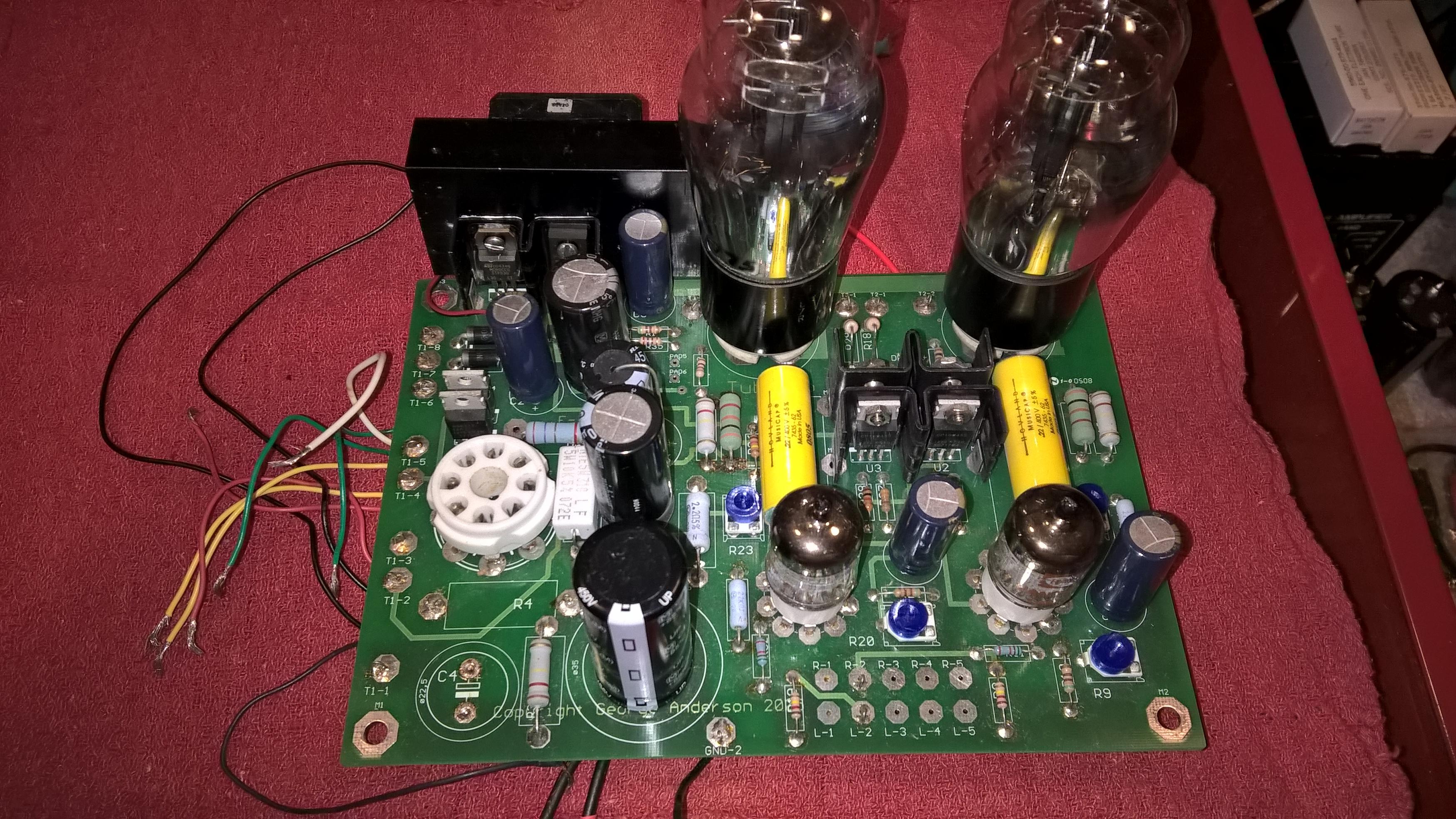

Tonight I soldered in the 4-pin sockets for the 300Bs and then tried to install tubes in all of them to make sure they fit. The GZ34 and 300Bs went into their tubes just fine, but I couldn't get the 5842s into the noval sockets.
It could be bad alignment between the female pin receivers and the ceramic cover of the socket:
5842-top by jeffdrouin, on Flickr
Or perhaps some bent pins on the 5842s:
5842-pins by jeffdrouin, on Flickr
Any suggestions on how to remedy this? I figure my options are:
1. Try to reheat the solder and minipulate the pin receptacles into alignment from the lead tips sticking out on the bottom of the board or at the legs between board and socket (i.e. by nudging with needlenose pliers, a screwdriver, or somesuch).
2. Leave the solder alone but try to bring the pin receptacles into better alignment by gently nudging the legs with a screwdriver or somesuch.
3. Try to bend the tube pins--without placing stress on where they meet the glass housing--so that they are straighter and more in line with the socket receptacles.
Kind of wish I had soldered the 5842 sockets onto the board with the tubes in them. I really didn't think they'd deviate that far.

If you solder tube sockets unto a board with the tube in the socket, you stand an excellent chance of soldering the tube into the socket.
To straighten pins, it is best to use a pin straightener made for the task. My tester has them, I'm told they are also available on eBay.
You can do it with needle nose pliers - if you are very careful. I've done it dozens of times. But it's not a good practice.
Some of your solder joints look cold. In particular that one due north of the 9 pin tube socket in the above pic. Try to find some online pics of good solder joints and make sure all of yours look like that. Bad solder joints, from cold soldering or insufficient solder, will cause you problems on down the road. Often intermittent problems - the worst kind.
Win W5JAG
OK, thanks. Wow, I had no conception that something like a tube pin straightener would even exist. Learn something new every day.
That solder joint just north of the noval socket is actually stranded wire from the Auricap coupling capacitor, which is located under the board. I tried to cover the wire I couldn't clip off with some solder to keep the copper strands from oxidizing. I will look over that one, as well as the rest, to try and improve.
What would you say is a good solder joint? Something like the "north" one at R28, perhaps?
Solder did not flow through all of the holes to the top of the board, and I didn't worry about it because I preferred a minimalist approach.

I put tubes in the sockets when I solder the sockets......
I've never had any issues with soldering a tube into the socket.
The way I figure it, if you soldered the tube into the socket then you would have filled the pin with solder anyway.......

The north one at R28 looks fine.
On a pcb, the solder joint is both the electrical connection and holds the part in place. Personally, I don't use a minimalist approach with it. If the hole on the board is plated through, I use enough solder to flow through to the other side. I think the tubelab boards are only one layer, so it probably doesn't make any difference. It's just what I do.

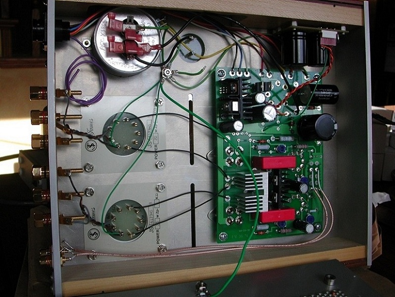

OK, now I'm learning myself on heat sinking by reading through the forum threads. Seems a lot of TSE 300b builders have problems with the regulator shutting down due to overheating.
My enclosure is aluminum, fairly large at 17 x 10 x 3, and will have plenty of holes drilled into the bottom and top (directly over the PCB) for ventilation. Do you think I'll be OK with the originally spec'd heat sinks?
If not, I think I can add a larger heat sink to U1/D1 with thermal paste and a bit of aluminum flat stock as a shim. That would allow the larger sink to hang over the side of the board and protrude down, which is desirable since there'll only be about an inch of space between the board and the chassis top plate.
Do you think I'll need more heat sinking for Q1/Q2 and U2/U3?

I dug out my old TSE board last night and took a photograph of it.
You can see my heatsinks, including the regulator chip heatsink. My regulator chip never shut down, but even with the heat sink pictured, it got hotter than I was willing to tolerate, so I installed the small fan seen attached to the sink.
It ran cool to the touch after that.
You can also see how I dealt with the c6 c7 spacing issue - I used a cap with leads at opposite ends of the cap, and then just bent the negative lead over the top and soldered it to the board. edit: maybe the positive lead - whichever went to ground potential.
