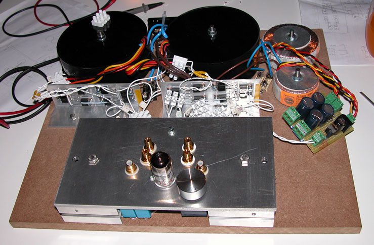

prototype
This is my Tubed GC prototype following Joe's schematics.
The amp is assembled using industrial standard components.
PSU is 2x220 VA xformers with 25 V rails for the LM3875, one 15VA
for the heater and one 50VA for both sides of the triode.
I mounted the PSU in a MDF sheet, whereas the amp is built joining
an aluminium plate with two heatsinks for the chips. I used parts
that I had at hand. Also the tube shares the same plate, so it is
a very compact arrangement.
I was exactly in the same situation described by Tor Martin in his post,
i.e. first experience with tubes and hum in both channels either with
input connected or not and independent of the volume pot level.
Yesterday night I split the supply of the left and right channels
of the tube buffers (separate bridges and caps, still sharing the
same transformer). This has helped in reducing the hum,
which is still present but much more acceptable. I have not
tried to change the ground routing yet.
The amp has worked few hours, and I think it needs to break in
properly. I just compared it with my other diy amp, which is a
10W Son of Zen. I found the deep and mid bass performance of the
tubed gainclone very impressive. The bass is deep and very controlled.
The Tubed GC made me discover how powerful can be the bass performance
of my speakers. It was much better than the SOZ bass. In the mid and
high range I found that the SoZ is much more forward and lively.
The Tubed GC provide a much softer sound, may be some people could prefer it
(and my wife likes it very much!!). But sometimes seemed to me a bit dark.
I also find that overall the dynamics of the SOZ is much more superior.
Another point is that as a "summer" amp the Tubed GC is much more fresh
(my SOZ produce an awful quantity of heat).

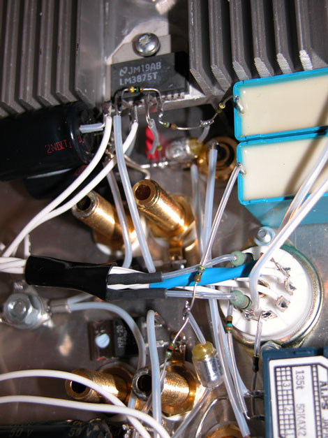

I would appreciate some suggestion to tweak the project in order to
clarify a bit mids and highs. However, I think that I should listen again
after the break in.

Hi Carlo.
Good to hear that I`m not the only one having problems, but sorry for you.
I think I will rewire the tubebuffer this weekend and try split supply also and se if it can help my amp as well.
I actually have a spear transformer I can use. I ordered one 25 V 30 VA transformer, I payed for one, but RS sent me two!!😉
Maybe they knew I was gonna need it!!
If I get the time I`ll try to bypass the tube section to night to see if the problems get less without it. Then, maybe I know what to focus on.

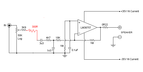

Hi folks!
I bypassed the tubebuffer in my amp by disconnecting the two trafos and inserting two 330 ohm resistors in the tube socket between K and G. Now the amp is absolutely 100% hum free!
Now I know for sure the tube buffer is the problem. That helped alot!
Tor Martin🙂

Hi Tor,
Not quite sure exactly what is was you did here...
If, as you said, you bypassed the tube buffer stage and ran the splitter xformer straight from the source (as I understand it) then I am at a loss on how putting a 330 R between cathode and grid of the CF is going to have any influence?
Or lets's just say that I don't have the foggiest on how a 300R between cathode and grid is going to solve a hum prob.
Probably my ignorance but I'm curious nonetheless.
Do you mind elaborating on this?
Ta, 😉
Ta, 😉
This is what he did to fix his hum:
All this does is prove the tube buffer portion is the issue and not the chip portion, as he stated.
Exactly Leadbelly.
Just unplugging the tube powersupply trafos, uncarging the capasitors in the tube powersupply and inserting a resistor from grid to kathode.
Tor Martin
