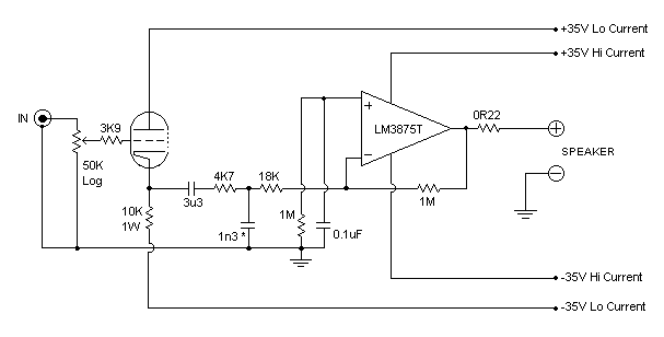

Naive question(s) for Kuei and Joe.
Given that a CF is referenced to B+, and B+ is powering the entire circuit, something like Alan Wright's SLCF circuit is there for the purpose of isolating the anode from the B+. Must this be a voltage regulator, or would choke loading accomplish similar results?
I currently use a CCS(ink) on the cathode of my CF, and have been thinking about implementing Alan's SLCF. If tossing a choke in there got me most of the way there, I might lean that way.
...or would VR tubes be another alternative?

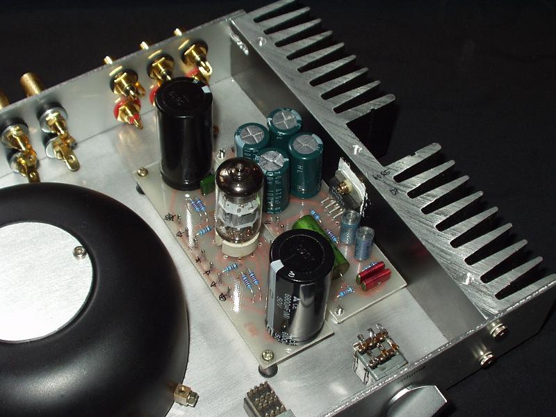

JasonL said:Any one got the final schematic.
Any one do a PCB.?
Shema posted earlier in the thread, and why would you want to ruin it with a PCB?
dave
Joined 2002
JasonL said:because i like the nice neat layout of a nice clean pcb.. NOT a rat's nest..
Hoe neat P-P is depends on you... and it won't cmpromise the sound like a PCB.
dave

Konnichiwa,
Okay folks. Now I don't want give Joe troubles and it is not per se my aim to better the JLIT either....
HOWEVER, if you WHERE to ask me what I would do if I wanted to build this using a Follower (not that I want), here it is:
1) Buy a separate Torroid to drive to the Tube frontend. You can get some with around 110V CT even at fairly low power levels.
2) Use the 110V with a Voltage Doubler to get +/-150V (appx.) and use decent Valve style CLC filtering, DON'T SKIMP. Make sure the final pair of PSU Capacitors is of the Film Type, with a Resistor filter the final supply.
3) Cascode the Follower Valve and use another whole Valve as Cascoded Current Source in the "tail" of the Cathode follower. You can see a suitable schematic here:
http://www.vacuumstate.com/
Look at the schematics section and the various cathode follower implementations, I'm sure someone can draw it out....
Try it like this, but use a Valve instead of the lowest FET in the CF, plus dual rail supply instead of single rail....
I'd probably use the 5687 or 6H30PE as Valve in all positions, it is one of the better sounding options for followers. Alternatively the 6SN7 can also work okay, octals look prettier.
Anyway, I would also (of course) hardwire the whole shooting match....

Joe,
I see where the confusion comes from now...
You're talking bridging stereoamps while I'm talking of using a balanced inputstage for the schematic as you posted.
Which is one channel of a PP amp that I (mistakenly as it turns out) took for a single channel amplifier.
By Jove, it even looks like one...
By doing so it would render it balanced from front to end since the PP stage is by its very nature a balanced symmetrical stage.
In my book a bridged amp isn't necessarilly a balanced amp as it often still driven in SE mode.
Now if we take the venerable Dyna once again and bridge it for mono operation we would essentially have a 140W Class Ab1 amp from what was once a 70W/channel stereoamp.
Nothing's really limiting it but you could never squeeze out 280W out of that amp regardless of the OPT you'd use for it into an 8Ohm load.
Back to the schematic you posted and assuming the same 70W of output for one channel and it's still a monoblock would it magically turn into a 140W amp by making it balanced?
And I mean balanced without adding any further output modules to it which wasn't implied anywhere anyway.
Of course it wouldn't.
Regarding CF: please don't shoot the messenger (in casu me) and nobody implied at any point that the rails would be shared between the CF and the output, the question was if the same voltage could used.
My philosophy about CF implementation is pretty straightforward:
use them only if you absolutely need them...I'll refrain from further comment.

Kuei Yang Wang said:Konnichiwa,
Now I know you wouldn't give me troubles and I do welcome your input...
As far as building a better JLTi, I could do that too!!! Give me some $$$. But what've presented here is not the full JLTi, a more basic version that actually does an admirable job when you listen to it. Note the [suggested] separate power supply for each CF. A few extra pennies well spent. Now it could be regulated, externally and internally (CS). If they are capable of figuring that out, and I don't mind pointing them down that road, then go for it!
What you describe is a super Super-Linear Cathode Follower!
HEY, THAT MY PREAMP!
Now, you do realise that I have had not a little to do with this design even though it bears Allen Wright's moniker at the lower right corner. Indeed I did a major selling point on this buffer to Allen and he saw it my way. I think the first time we did the boostrapped device on top of the anode was mid-80's.
Yep this is a high performance buffer, and complex at that (that won't go down well with everybody) and can it be improved upon? As a thought process... I think you answered that.
But, tell me honestly, just where do you stand when it comes to Cathode Followers (or any follower?). Do you prefer to avoid it altogether... as some do. Nothwithstanding that it can be made to sound better than its reputation that seems to precede it, and maybe some of it unfairly?
Are they just a necessary evil that we have to debug as much as possible? And it seems that takes added complexity - not running away from that. Then the fact that most SS outputs are followers... ???
A penny for your thoughts.

Hi fdegrove
Ah... what's in a word? Bridging, of course. It's such a long time I used that word and in this case it is more specific.
Yep, I see where you are coming from now. I do believe in balanced interfaces, indeed I prefer the term differential.
That sounds about right.
In SS speak, the power quadruples. Tubes double. It's the nature of the beast(s).
Not usre exactly what you mean. Two active SS amplifiers driven by a diff source (or phase splitter) with the load across the two active outputs. This is same as bridging, as you say. IF the balanced input already exists, then maybe all that is needed is to buffer it before the inverted circuit. Provided you have those two compatible identical signals the principle applies. It's just that SS can near double the current while swinging twice as much.
Probably not far from my sentiments as well. It's just that a good CF is not half bad at all. In fact the best are indeed complex but also quite superb. The one I supplied here is rather basic. It seems oh so simple but is actually a deceptively good design that can be improved upon even more.

- Chip Amps
- Tube with Power IC Output Stage - JLTi
