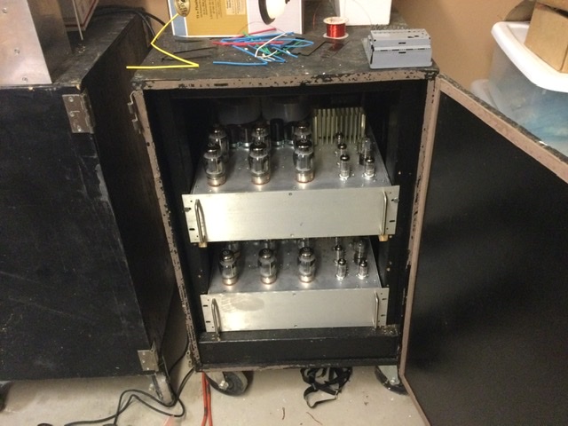

Well it s a *tube* amp, is it not? Mine will do 210 watts. Haven’t left it on all day like that, but one of them did run for an hour or so, with nothing overheating or any nasty looking glow inside the tubes. I call it good enough.

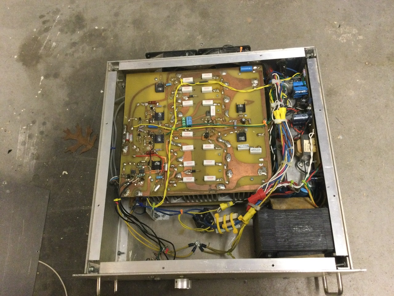

I did leave my “CS800 clone” on at full power into dummy loads for two days back when I developed it.
Low frequency output below 120 Hz tends to be limited by the main filter caps. The pole frequency between the cap and the load resistance needs to be about 2Hz in order to approach full power at 20 Hz. It’s easier to do this with tube amps because the load impedance is high and it doesn’t take a ridiculous number of microfarads.
