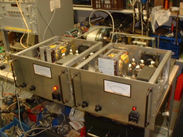

I build 2 MC-3500 clones the other day. They easily able to drive 2 ohm load at 4 ohm setting. They are real arc welders and heavy as a tank. (70kg).
The sound of the amps is incredible , you feel the power of the amps, even at low levels. The amp employ 8 x 6P45S , the soviet pendant ofthe 6LQ6. But they ruin your power bill if you use them all days.
I used it once as a ac power supply to run an old military aircraft radio , a old collins 618 hf transceiver which need 115V/400Hz to fire up , the output was set to 32 Ohms an the input driven with ma audio generator to clipping level. The amp did the job without grumble.😀
Homebrew MC-3500 clones
