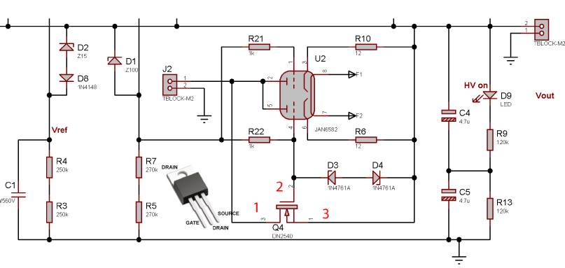

That'll work fine, looking at the specs. I haven't checked the pin-out though, so that's something you'd need to verify.
jd
jd
Ok! And filter before your cricuit ??
C-R-C/ C=?, R+= ?? the value of C, R is enough, And is good filter??
In your cricuit DN2540 is wrong foot. What do you think??? yes or no??
See in the image
Se in the image
