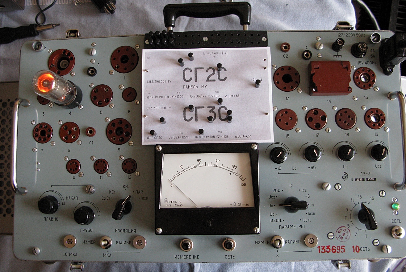

Russian L3-3 Tester
I would like to vote for Russian L3-3 tube tester. L3-3 allow test emission, transconductance (using Sergeev's topology), leakage and reverse grid current of almost any commodity tube. Its quite cumbersome to use, at least for the first moment (mostly because of scale with relative, not absolute values), but it does its job very well.
It uses as much as 3 regulated stabilized voltage power supplies, and DC filament for small signal tubes.
I assume only those who read Russian can operate it.
There are manuals in English and German floating around net, so nothing to worry about.
