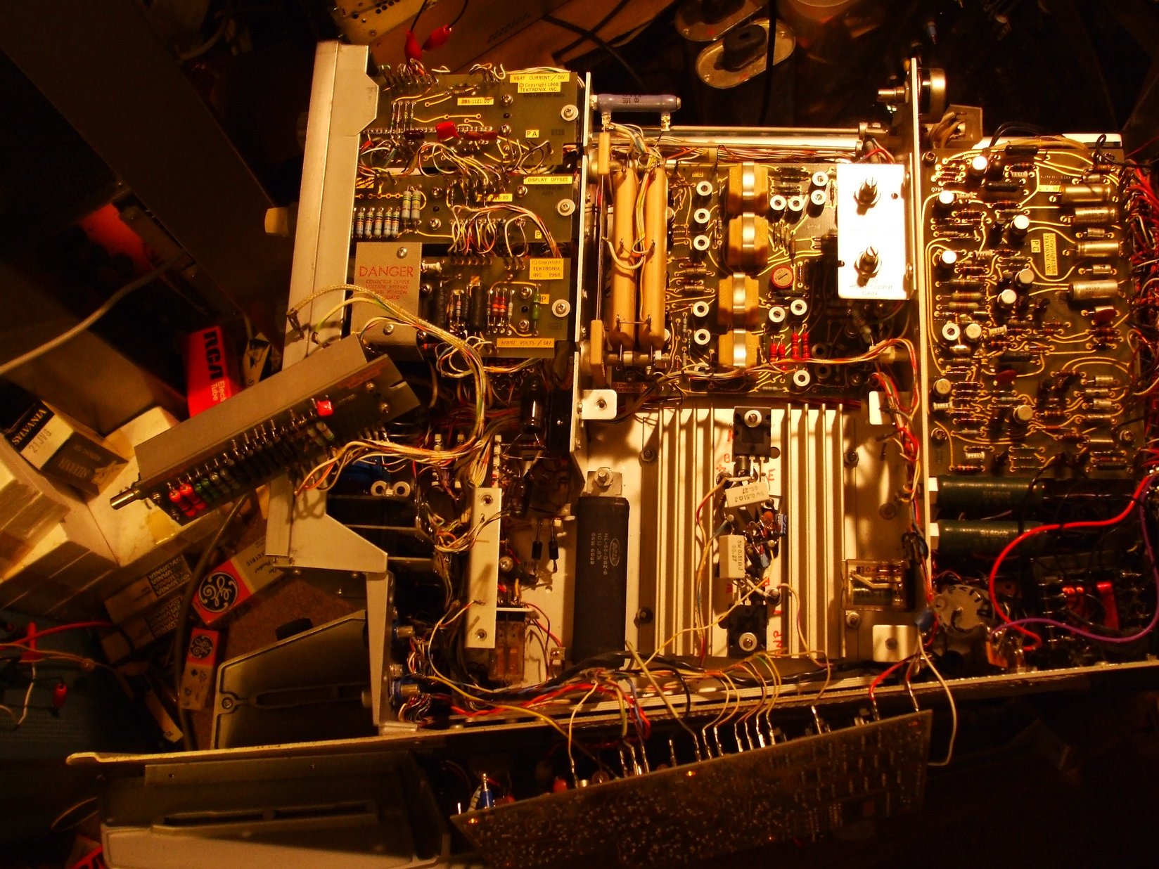

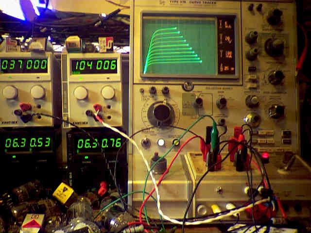

For serious tube analysis I agree that a curve tracer is the way to go. I have picked up relic Tek 577 and 576 carcasses on the cheap, and made working units out of them. One must provide a tube socket interface plug-in fixture, and an outboard heater supply. For tetrodes and pentodes an outboard screen supply must also be attached. A 576 can provide all the plate voltage and current one could ever need for audio projects. Restoring these old Tek beasts is not for the faint of heart, especially when one encounters a bad CRT or a failed power transformer, as a friend of mine experienced. Newer Tek curve tracers are frightfully expensive though.

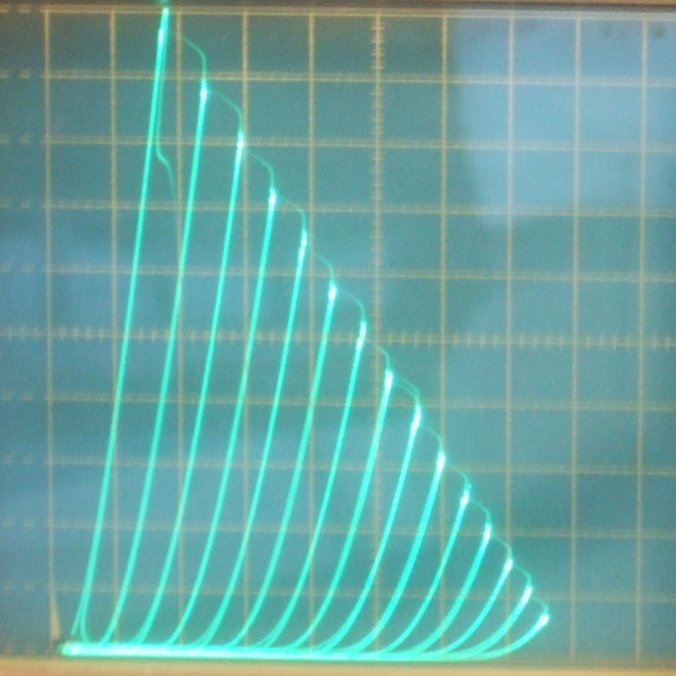

This could be a very simple, yet very accurate set up. I've had to rig up simple test fixtures in the past to measure the characteristics of RF power tubes requiring high voltages not available on tube analyzers. I used separate variable power supplies for plate, grid bias, heater and (maybe) the screen. An ammeter is inserted in the plate lead. You can, somewhat tediously, vary the plate supply and grid bias and trace out the plate curves, one point at a time. Or if you simply want to check mu, rp and gm at a specific operating point, set up that point and vary grid bias in small increments from that point to calculate gm; likewise vary the plate voltage to assess rp. Of course, having any two known parameters yields the third.

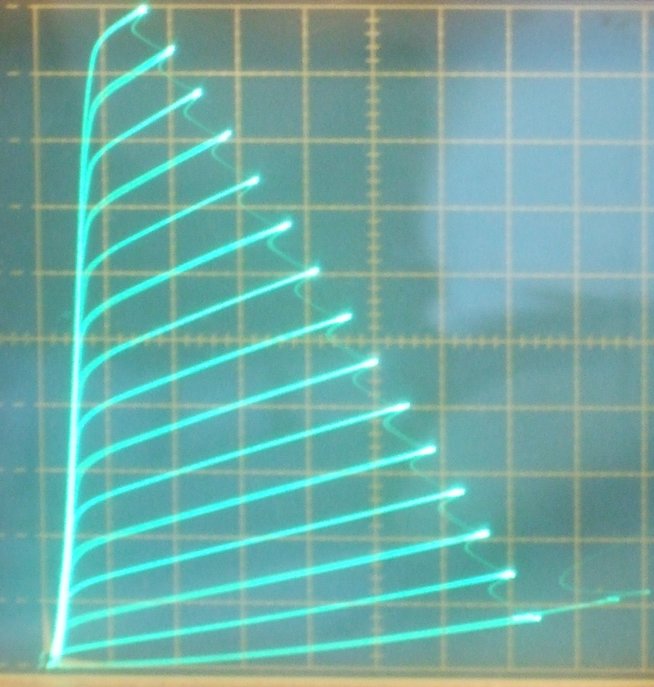

With the price of tube testers being up where they are, you would be better off getting a much more capable curve tracer for less $$. The Tek 576 can be converted for tube use (below), but requires a fair amount of work and extra expenses. (I have the revision work mostly documented on the one I converted)
The online Mu Tracer kit is much more affordable and easier to get going, plus it lets you save results on the PC. It doesn't give you the high currents needed for many output tube tests. (Each rev. has been getting more capable though).
