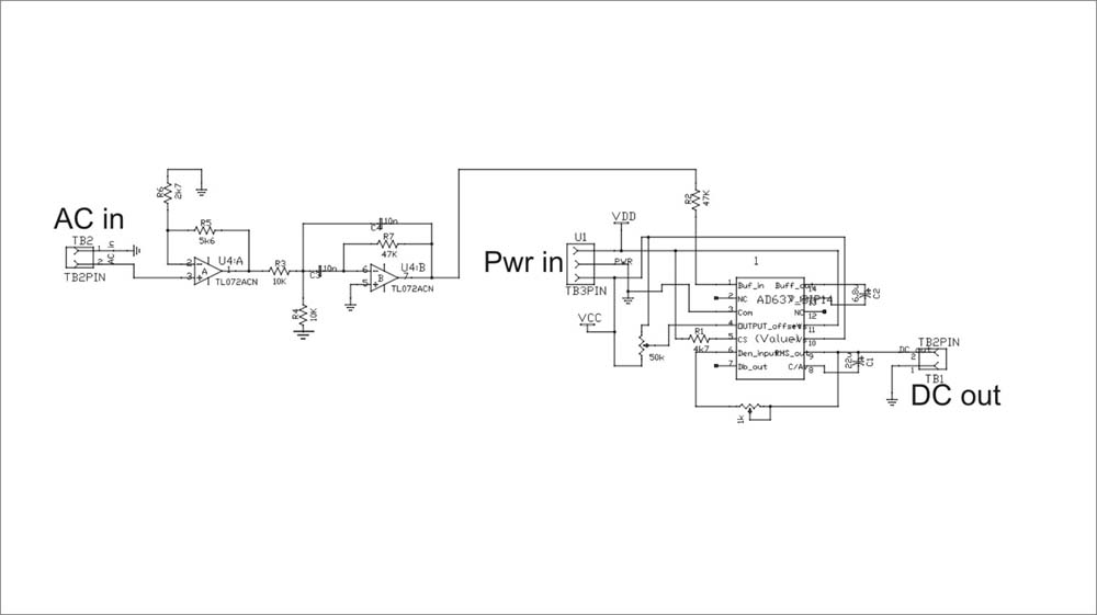

This the millivoltmeter with the precision rectifier it is tested and working; yours looks OK. I have drawn a circuit but not yet built a prototype of the true RMS millivoltmeter I will post the circuit if you want.
It is better to use 10 turn type trim pot for both they will be easier to set. I put C4 on the RAT tester board then shielded cable to the range switch. R7,R8,R9 mounted on the switch, and more shielded cable to the millivoltmeter board. If you use a moving coil meter for the output indicator you can leave out R10 150R, it is part of the feedback circuit and internal coil resistance of the meter is used instead. I used a LCD panel meter because it has much better resolution than moving coil meter, it is cheaper ($AU9.95) and there is no need to draw a scale for the meter face. As it is my circuit is set for 200mv fsd you may need to experiment with a series R with a moving coil meter. The down side to using a LCD panel meter is that it must have its own power supply, it cannot share a power supply with the same device that it is measuring (ie the millivoltmeter circuit). At first I thought to use a 9v battery, current comsumption is very low and the battery should last a long time, but in the end I settled for a separate regulated 9vdc supply for the LCD meter, no need to open up the tester to change the battery, also battery always seems to go flat when you need it the most. I'm attaching a pic of my tester, I wound my own mains transformer and only used common filament voltages 2.5, 5, 6.3 and 12.6. The two small transformers are for millivoltmeter and LCD panel meter. Millivoltmeter is at the right made on veroboard. Valve sockets are on top. The three meters are for valve current, anode volts and screen volts. Valve current meter is switchable to read 0-10 and 0-50 mA.

I´d insert some mods (with your permission!) in the millivoltmeter circuit. C4, C5 and C6 across input resistors could provide some frecuency correction at AC input. C7 and C8 would block any dc current from TL072 and finally, the two zener D5 and D6 could save TL072 from shorts. Please, comment.

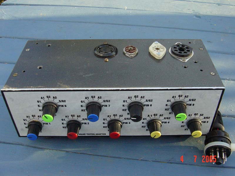

From reading Steve Bench's text about the tester, it seems the valve under test finds its own bias. I have put two sockets on the front one wired to the cathode and the other wired to the grid, I can plug a DMM into here and measure the grid bias voltage. I tried this with an EL84 and the cathode to grid voltage was around -7 volts which matches the data sheet. I used this idea to match a box of cheap Russian EL84's matching them for anode current, Gm and bias voltage. From a box of 20 I was able to get 5 pairs, each matching within 5% for all 3 parameters. Of the remaining ones I was able to make some pairs with anode current and Gm matching. These I would say are close but not matched like the other 5 pairs. I plan to add a LCD voltmeter for this function on the front panel of my next tester so there is no need plug a DMM in, also I have a preference for it to be self contained.
I have also added a octal socket on the top panel which has anode, screen,grid,cathode and filaments. An add-on box with switched sockets plugs into this so I can test any valve that fits the sockets. There is a switch for each valve pin, the switch can connect anode or screen or grid etc to the pin that it is connected to. Here is a picture.
I have seen capacitors such as C4,C5 and C6 used in audio millivoltmeters for frequency correction at the voltage divider and they certainly wouldn't hurt, but I assumed that as we are only interested in one frequency namely 1Khz that they are not needed, so I didn't bother. As for C7 and C8, it didn't even occur to me that there could be a DC offset at the output of the TL072. During the testing of the meter circuit I checked it (using a signal gen.) against my FLUKE 87 series IV in 10mV steps up to 200mV, I recall it was within 1% or 2% all the way up to 200mV, perhaps the DC offset trim control on the TL071 takes care it. The two zeners are probably a good safeguard in the event of a shorted valve, as my tester is at the moment, the anode voltage meter dips as I increase the valve current if the valve under test has an internal short. I've seen some good fireworks inside shorted valves but so far no damage to the op-amps. (hence the need to add a shorts function)

Retailerretailer said:jmsegui
You are rigth, it makes no sense to grow up the original design with non necessary items. I encolse my pcb board in witch I put the rotatory switch. Because it was already eched I´ll put some jumpers to cancel that new items. I´ll test this precision voltmeter this weekend.
About matching tubes, I misundertud you when you said you put a couple of sockets. I was thinking in a couple of octal sockets to match tubes, no binding post! Now is clear.
Yes please, post the true RMS millivoltmeter circuit.
here is my true RMS millivoltmeter, input voltage divider is not shown as it is the same as other. You can dl data sheet for the chip from Analog Devices web site. I have not yet tested this circuit but don't envisage any problems.

retailerretailer said:jmsegui
I´ve found some component problems with the 7812/7912 to run the precision AC voltmeter beacuse I always got +12-14volts. Changed that components with simmilar results I´ve just decided to use LM317/LM337 regulators instead. I´ll check it today.
About 100mA RAT cathode current how did you get them? I´ve changed R16 down to 90ohm, R6 to 5ohm and R12 to10ohm but I have some dubs. Maybe I´d better change CR17 10volts zenet to a higher value...What do you think?
