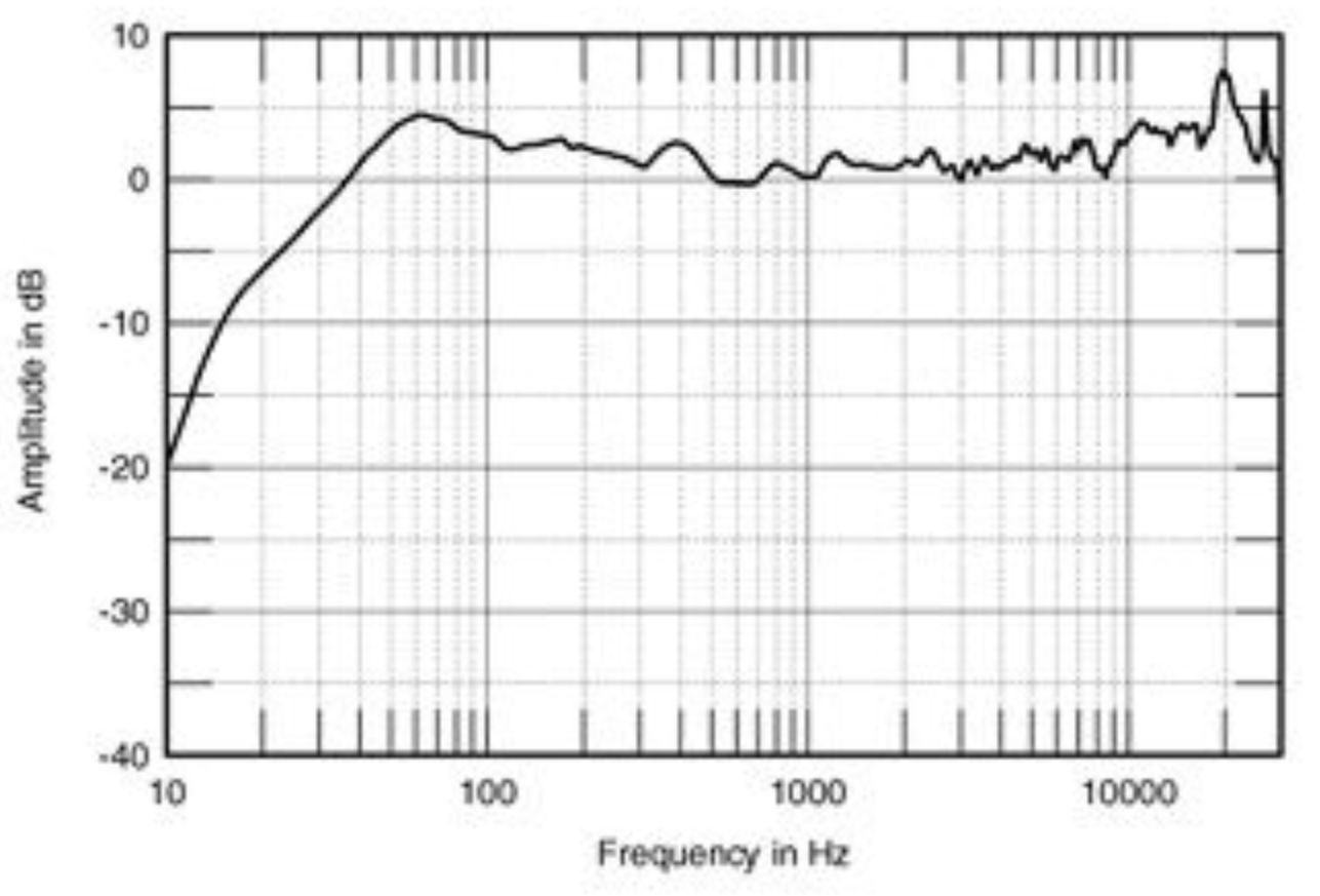

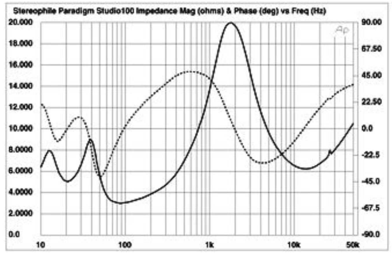

First issue is speakers. I am unfamiliar with the speakers that jdrouin owns, but somebody needs to post a frequency/impedance plot.
Paradigm Reference Studio 100 v2 floorstanders. 88-89db sensitivity @2.83V
Stereophile: solid line is impedance 3-Ohms @90Hz 20-Ohms @1800Hz. Dashed line is phase.
jdrouin" I mean, they're not bad at all; they just don't have that effortless, airy, transient magic that I've heard from simpler speakers with tube amps.
But with more power/current or a different amp their character might change."
(This is the bet jdrouin wants to place on a high power tube amp)

It's a hot and expensive tone control you can't turn off. To get an idea of what it will sound like with your speakers, stick a 5R resistor in series with the output of your amp. If you like that sound, you can either EQ to get it or drop $3k (plus ongoing costs for tube replacement, maintenance, and electric bills) on the Cary. Distortion on your speakers will be quite high- this is an amp much more suited to high and relatively flat impedances. The drop in impedance right in the middle of the bass range to 3 ohms for your speakers will greatly limit power delivery.
Thank you LineSource for posting the data.
With the wrong tube amp you could be unhappy with the low end using those speakers. I have a feeling these speakers were designed for low Z high power (>100watts) modern amplifiers. Others and I have suggested you could get a similar effect using some series resistance with your current amplifier and speaker, if you like what you hear then that will give you a better idea of what is acceptable or even preferable to purchase.
