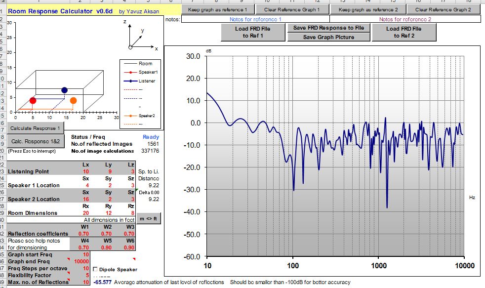

Sketch out the size of your listening room with the best speaker placement options. Visualize the largest speakers you would put in your room. Tall & narrow? Classic golden ratio box? Open horns or fully enclosed?
Download one of the free speaker room placement programs like Baffle Edge Diffraction Simulator by Jeff Bagby Version 1.20, and run a few sims to understand wall and floor interaction. ALSO think about controlled directivity horn/waveguide patterns in your room which push more of the sound to the listener and less bouncing around the room. 90Horizontal x 40Vertical. 60H x 40V. 60Degree round. Finalize your listener and speaker placement locations. Post your goals.
NOW you have the info to get good speaker recommendations.
Personally, I would spend the $3500 on high'ish efficiency speakers, and NEW 24b/96Khz high definition digital music files which you run off your PC. FLAC format has free hi/def player S/W. You could build great speakers which only require straight cuts and a router. If you do not want to build, Craigs list for efficient Klipsch Cornwall or Heresy, Altec, GPA(OK speaker company), older JBL monitors(15"-18" woofers).
Huh. Room simulators. Thanks! Didn't know about those, and will *definitely* start playing around with it. Now we're cooking with wood!

VERY BASIC 2-speakers in 20'W x 12'L x 8'H room simulation provides some rationale for controlled directivity speakers. Waveguide. Dipole. Cardiod. More audio energy directed to the listener, limiting excessive audio energy reflections around the room which could confuse the soundstage. Long wavelength bass equalization is more effective than reflected short wavelength high frequency equalization.

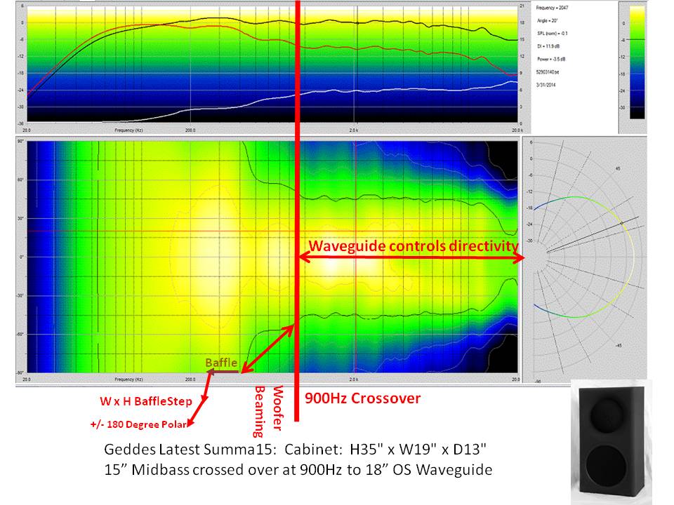

Controlled directivity plot from Geddes Summa illustrates what is possible with just a tweeter waveguide. A 3-way Synergy horn offers controlled directivity down to 200Hz.
That's why I still like:
Spend $3500 to buy/build new ~95db/watt efficiency controlled directivity 30-20Khz speakers.
Borrow/build a 24b/96Khz FLAC playback computer.
Now you can borrow/build a modest wattage tube amp for evaluation.
