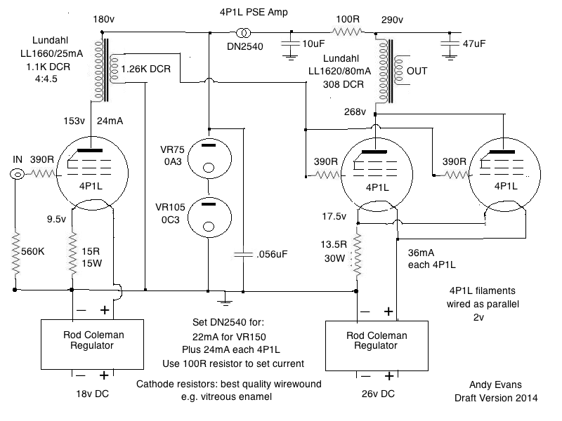

I've been looking for this for a good 35 years with many builds, including the usual 300b and 2a3 amps, SET and PP. My conclusions are paradoxical, because two entirely different systems come close.
1. Apogee full-range ribbon speakers. Caliper Sigs or Duettas if you find them. Nothing really comes close for micro details and timbre. Absolutely amazing. But you then need a more chunky amp. My brother uses this system, with Nagra PP 845 amps. He uses a Schitt Gungnir DAC which is wonderful, and Audirvana+ software on his iMac source. Again, state of the art. The sound is magical.
2. My system - full range Mark Audio Alpair 10 units in columns. I've had them a few years so they're well played in, and I use them infinite baffle because the bass is just about there and the mids are better. I'm totally in love with the amp - an all-directly heated PSE 4P1L circuit with Lundahl iron. Schematic attached. The sound is holographic - micro details and really good timbre. Voices are spookily good, but really it's all good. The circuit is about as simple as it gets - two 4P1L stages IT coupled, no coupling caps, no cathode bypass caps since it uses filament bias and small cathode resistors. The power supply is quite complex, especially the filament supplies which are all choke input. I have a large box of 4P1Ls so I'm set up for life - no more tube buying. Source is my Mac Mini with Audirvana+ and a ES9023 DAC, battery powered. No preamp - volume control in software on the Mac.
The two systems are very different but both are satisfying. I have no desire to build another amp. I've found what I want.
