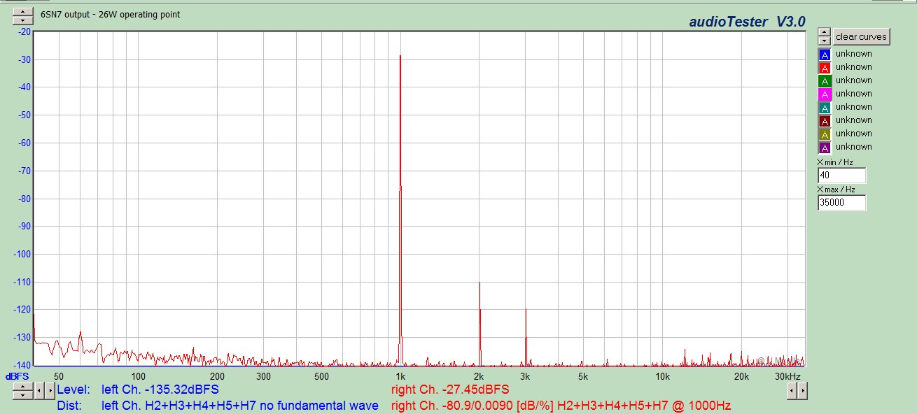

Off the cuff, 2-3 V (would have to go back to get exact) feeding the grid of the next stage, which was a 46 triode-connected. At around 20V output the distortion was twice as high (which is still near perfect in my book). Most importantly only 2nd and 3rd; nothing else could be found. Differential stages throughout for full disclosure.
That's quite interesting. In my *SN7 measurements using a CCS load and Morgan's using a mu follower load, we saw roughly -55 to -60dB at 19.7VRMS, dominated by second. If we scale that by a factor of 10 to account for the difference in level, we would expect to see something like -75dB second. Now if I understand you correctly, you're looking at this differentially? That would largely null second, so we're down to third. I got about -90dB there (depending on the brand and the sample), so your data are pretty consistent with ours. 12AU7 is about 20 dB worse.
What was bias level and current for your measurement?
9 mA set by fixed CCS. Grid at -7V set by 390 shared cathode resistor, so plate voltage varies between 220V and 280V depending. Yes, this was a differential amp measured with a differential probe. My entire system is differential from DAC to speaker (until the speaker common gets grounded). Can provide a schematic if it helps. It has been posted in other threads already (Beyond the Ariel).
This was my output at 20V (differentially). And with flying leads all over the place; I suspect when the amp (now 85% built) is completed and dressed well, hum will be lower and perhaps slightly better performance.
I have over 120 12SN7, and each one was tested in a test jig. I have THD and individual harmonic data for each, if you are curious. Yes, some of us actually test. The SN7 lives up to the hype. Morgan was correct, smoked glass is the way to go.

Small bins and an appropriate window function.
I am not strongly versed in sampling theory, but that sounds about right. I use an M-Audio Profire 610. All balanced ins and outs. Additionally, at least with these specific measurements, you have a differential probe in the mix. As frustrating as the firewire interface has been, the front end measurement of this device has been stellar.
Would have to boot up the XP machine to get the specifics, but I typically set the sample rate at 96 kHz. FFT window of Blackman-Harris, 16k points, and number of samples either 16 or 32, depending on my patience level.
When the amp is fully built, I will likely start a new thread and begin some measurements. I would appreciate suggestions on how to best measure with the hardware I have.
Think of it this way- assume that the noise energy is evenly distributed with frequency. If the bin is narrower, there's less noise energy in it, proportional to the bin width. Bin width is set by sample rate (the lower the sample rate, the narrower the bin) and number of data points (the higher the number of data points, the narrower the bin).
bin width = sample rate/(2*number of points)
