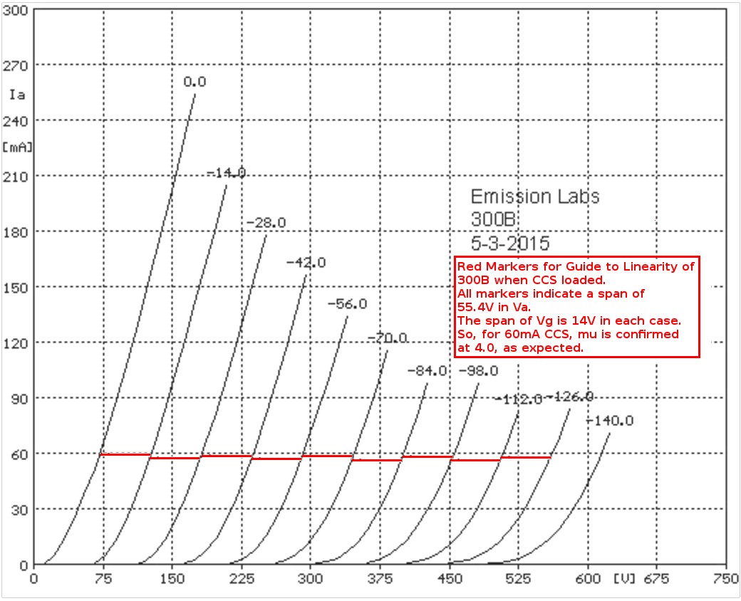

You'll find you don't get 0% distortion at constant anode current
Back to technical matters.
Your choice of a 12AU7 triode, and your choice of anode current of 4mA to run it at may well show large distortion, when a large signal at the output is expected.
But that merely illustrates a poor design example.
A CCS loaded stage can give vanishingly low distortion if the right choices are made.
In particular, the use of Directly-Heated Triodes allows a performance level very close to theoretical perfection.
To illustrate this is the clearest possible way, I have taken the curves for the most recent modern 300B and overlaid exact equal markers on the curves. Each marker is a constant Va span of 55.4V, aligned to its data-sheet operating current of 60mA and around Va=360V.
We can see that the Va spans of 55.4V align with no visible aberrations of linearity, right across the usable swing of the anode voltage - IOW - stable mu right across the operating voltage range.
Now, I am not suggesting that every DIYer needs to pay the price of a 300B for each gain stage. But most high quality DHTs give similar performance, including a triode-connected Svetlana 4П1Л (4P1L), an excellent low-cost valve, a real high-performing bargain.

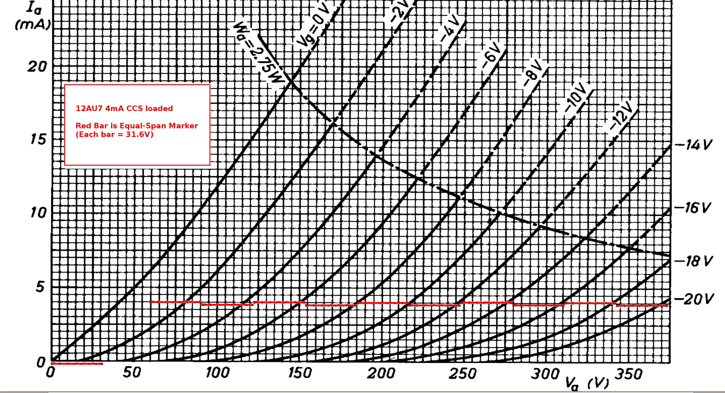

In the interests of fairness, I have applied the same graphical technique to the Mullard 12AU7, for comparative purposes. Watch out for the poor performance.
Is the comparison of a small signal tube and a large output stage tube a reasonable one?
Indeed, the 12AU7 is not a very low distortion tube, there are far better choices if linearity is the goal, but I wouldn't slap in (say) a 6L6 and try to draw any conclusions. Perhaps a 6SN7 or 7N7 might be a bit more appropriate.
No.
But my object is to challenge the claim in the quoted post: i.e. that the theoretical performance of a CCS load cannot be realised in practice.
