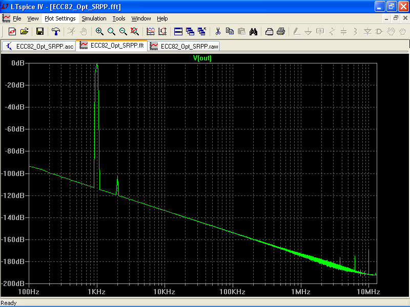

a differential probe to null out the fundamental
I missed that part- where was nulling mentioned?
Nope, no nulling. However, I do have one of Victor's oscillators, and made up my own notch filter, so that is certainly an option. But really, for measuring a power amplifier, I don't think this degree of accuracy will be needed. By the time I am measuring at the speaker output, I am sure there will be plenty of easily measured distortion well above the noise floor.
He didn't use a notch filter here and he's not measuring below the noise floor of the sound card. It's all about bin width.
Here's another example, where I can personally attest that there was no notch filter or nulling:
http://www.diyaudio.com/forums/ever...fier-measurement-analysis-22.html#post2429720
Also see my measurement series in AX, where I present lots of other spectral plots with similar or even lower noise floors.
Ah, I see. You're confusing signal to noise with noise floor. Not the same thing. To get signal to noise over a bandwidth (and it is bandwidth dependent), you power-sum the noise voltages in each bin over that bandwidth and use that as the denominator. So the noise floor ends up considerably lower than s/n by definition. A differential measurement is irrelevant to that.

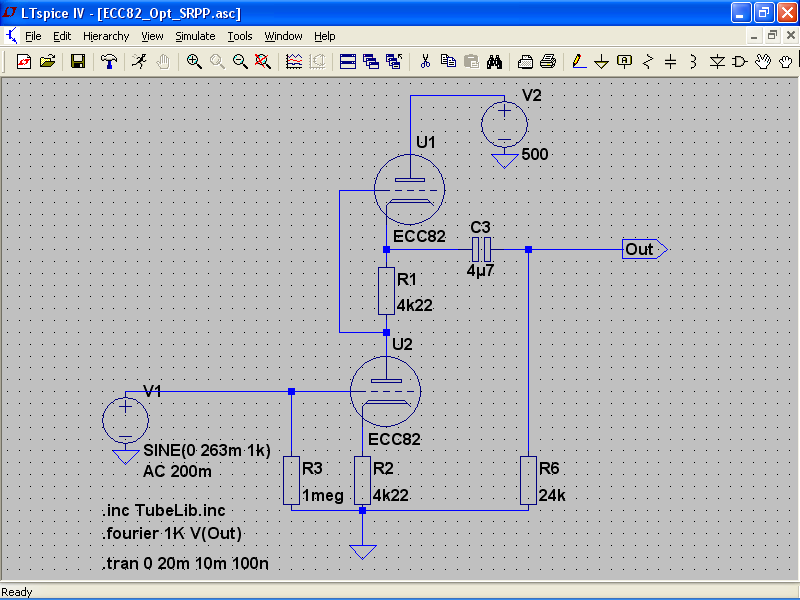

The industry has always regarded the 12AU7 as a miniature 12SN7. The basic ratings are the same same mu, same Rp, etc
The noval similar of 6SN7 is 6CG7/6FQ7, then the noval similar of 12SN7 would be 12FQ7.
My own suspicion is a bit more cynical.
Your suspicion might be wrong in at least some cases. Certainly was my reason for going that route. There are certainly plenty of difficulties to be overcome. Mine hide in side of cans to prevent electro-static coupling to nearby chassis..
Yes!
Err.. They make these things called "twin triodes". Two identical triodes in the one glass envelope.... Of course they also make dissimilar triodes as well.Will it? First, in real life where do you find two triodes which are very well matched across their entire curve?
For any given triode type, the departure from the three-halves power law is very consistent, being due to grid wire diameter, grid configuration, etc. Emission charcteristics of different cathodes can cause variation. The two tubes must have the same service history (cuurent). This will all be automatically taken care of by using new twin triodes.
An unloaded circuit cannot be balanced. As you said, without a load the signal current in both tubes is forced to be the same, however you ned a load to enable the swings to be in opposite directions. The SRPP must be engineered for a specific load resistance.Second, are we talking about the 'unloaded SRPP' or the 'optimum loaded SRPP', as these rely on quite different distortion cancellation mechanisms. For the first case what signal current there is goes through both valves in the same direction; in the second case the signal currents are equal and opposite. In both cases the anode-cathode voltages of the two valves are going in opposite directions so you have to consider how ra/rp varies as a function of both current and voltage.
Again, you need a load to get opposing swings - the circuit must be engineered for the specific load resistance.Let us take the naive view that the ra/rp of the two valves will exactly match, so the unloaded voltage at the anode will be undistorted (assuming constant mu). Add a load (there is always a load, otherwise we don't need the stage at all) and all you have done is halve the voltage gain and halve the anode impedance - so the non-linear anode impedance can still generate distortion into the non-infinite load.
Both mu and Ra vary with anode current and anode-cathode voltage. Mu is not constant. By using the load to get the tube current swings opposite as well as the opposing voltage swings, you get full cancellation.
Do it right and typically the distortion is better than 1/10th the CCS load case. People do what people do, but if the circuit is engineered/adjusted to suit the load, 1/10th is easily achieved. If trim pots are used, 1/20th or better is achievable. I don't recommend trimming though. The balance point will drift a bit, and you don't need it that good. Heck, mostly a simple resistive loaded triode is good enough.Typically, you have halved the distortion. Useful, but not game-changing. It gets more complicated when the optimum load is used, but people in audio rarely do that.
Generally an optimum load has to be of the same order as Rp. Gain is less but not so low as to make it useless. There are myriad ways to reduce distortion - most cause loss of gain or need more tubes. You don't get something for nothing very often in this universe.In many cases the optimum load is much smaller than the output impedance so you get a much smaller voltage gain - OK for a simple power driver before SS was invented but less useful nowadays.

As I am sure Rod Coleman actually knows, from the data I read off, one can curve fit (Microsoft Excel does this well). From the fitting curve one can then calculate the distortion, for CCS loading, for any desired anode voltage operating point, and anode signal magnitude.
An interesting thing though: While it is the norm that the distortion generated in a triode gets smaller the higher the anode load impedance is, in the Mulllard Technical Handbook, for the 12AX7 (Ra ~ 70 kohm), there is on page D3 a table showing the distortion for a cathode biased 12AX7 for various HT voltage, anode current, and anode load resistances of 36K, 77K, and 166K. The table shows that distortion is not all that dependent on the anode load, for all cases of HT below 400V. The distortion improvement in going from 77K to 166K (a 25% reduction) is less than the improvement going from 36K to 77K (at 32% reduction). It is evident that there is a law of diminishing returns and thus it's rather pointless to use a CCS load.
There is also a note that says for contact potential bias, distortion falls slighly with increasing anode load resistance. The note says that as anode resistance is increased, distortion assymptotes to about 80% of the amount you get with 36 kohm.
Clearly, the idea that CCS anode loading results in zero distortion, or even distortion all that much better than a simple anode resistor of value several times Ra, is nonsence, for this tube. However, distortion cancelling in an SRPP topology can be fully effective.
