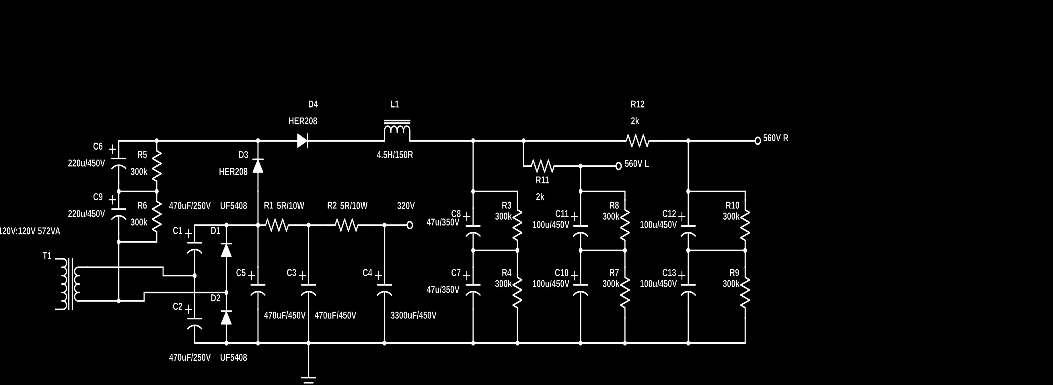

...Now the supply looks like:
SiC Bridge → 27Ω [20W wirewound] → 820µF/550V → Cap-multiplier → 820µF/550V → small L → 100µF Audio MKP → PT...

Hi John,
1. small L: 0.5-2H with <30Ω ESR.
2. I prefer separate supplies for each channel;
> For a PSU in a separate chassis, I assume you would make the split after the second big cap, adding a bleeder in the PSU chassis - correct?
Yes, that's correct!

But you have decoupled this capacitor from the effective signal path via the choke (which has reactance cca 250 ohms at 20hz if its 2 henry). In this path there is an 100uF MKP cap which has reactance of 80 ohms.
so what is the difference between "effective AC path, the cap nearest the output transformer" vs "better energy storage of the 820uf caps " located further away from the OPT in the power supply?
wouldnt that choke prevent rapid discharge of the 820uf caps into the load if that would be necessary?
I dont have much education in this. Thank you very much.
Cheers, Michal
