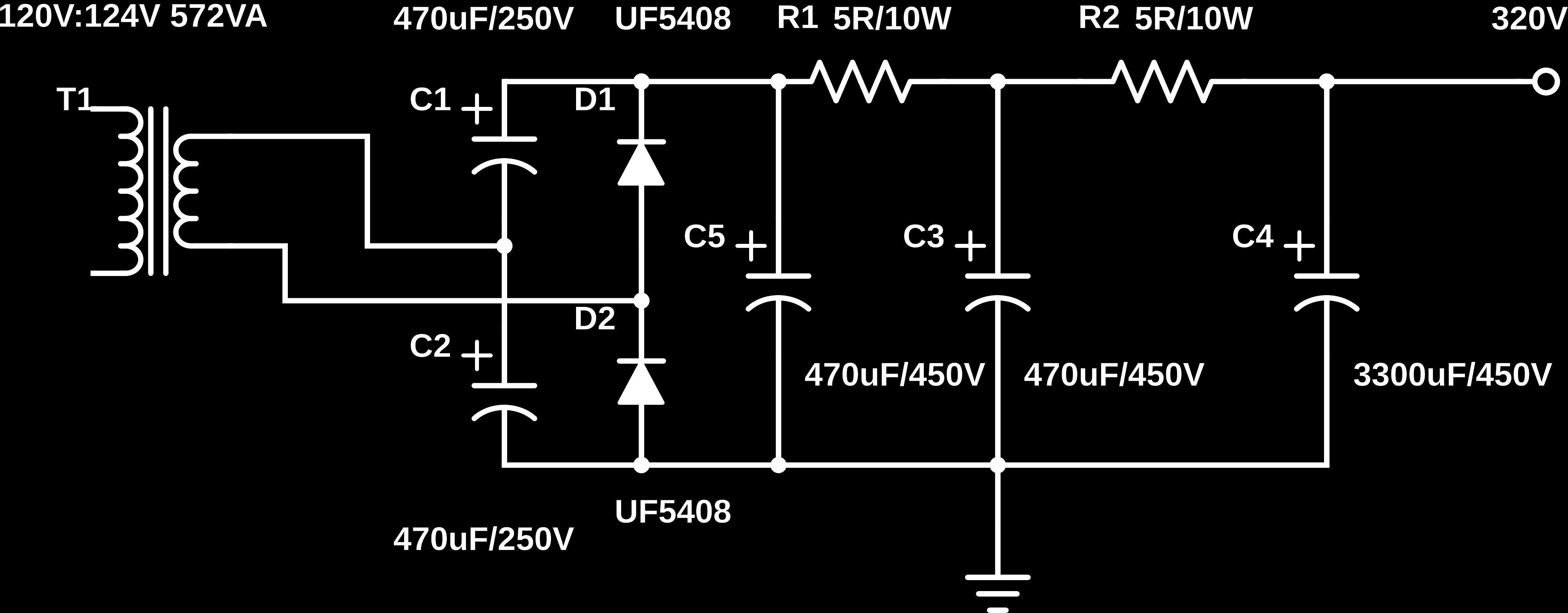

My speakers don't go down as far as deep bass, so that's not a priority for me. The mids and treble are much more important - clarity and smoothness. I listen to a lot of classical and opera.
This is what I use for my monoblocs that use 4 6P45S in push pull for 115 watts @ 30Hz working into ~ 1k plate to plate. ~480mA idle current.
No hum, excellent dynamics and bass.
Too easy?
Too easy?
