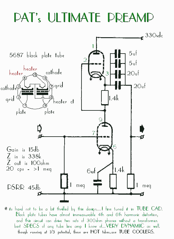

Hi Miki,
The E88CC is quite different..
You could use the ECC99 only made by JJ tubes instead of the 5687..it is quite a similar tube. And I have heard very good things about that tube. Shall try it soon myself.
Yes I would leave out the Cathode bypass capacitor..but the nice thing about being a diy'er is that you could always put a switch on the bypass cap and listen to the sound with or without the cap.
Generally it would sound better without the cap. But the cap does lower output impedance! There you have it spec's are great up to a point.
Good luck,
Bas
PS..If you have troubles finding the ECC99 in your part of the woods..send me an email..

Hello Joel,
You're right... Sorry for duplicated threads...
I asked if Pat's design could be modified for my needs (e88cc tube).
Bas Horneman, I allready have two e88cc tubes, so I want to use it somehow... Maybe I have to look out for another design (maybe SRPP too...). Anyway thanks for the tube offer, and I will contact you if I need them.
Miki.
Miki.
