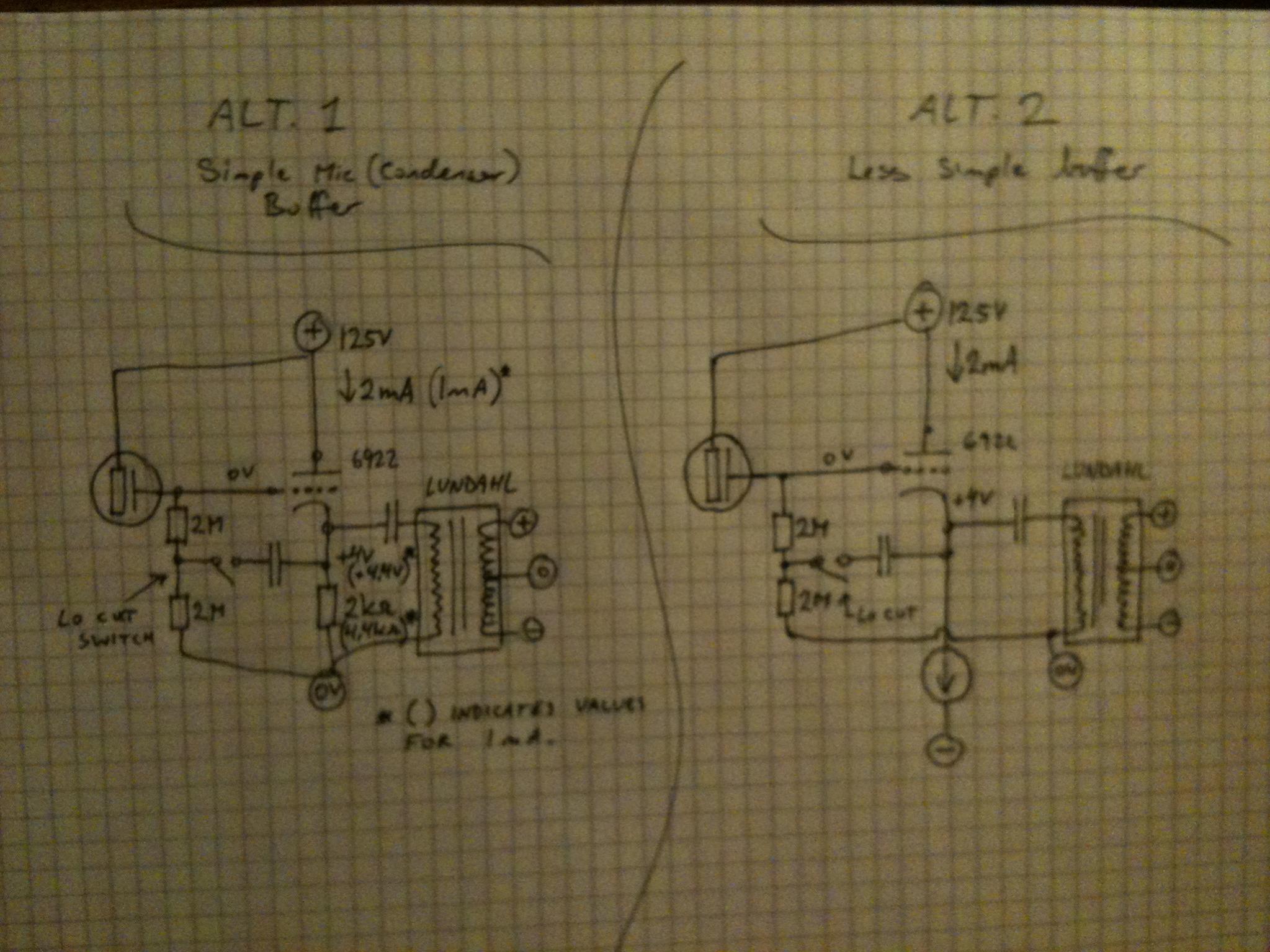

If cathode and screen are at the same AC potential, it's a pentode. If the plate and the screen are at the same potential, it's a triode.
A pentode CF would look like the attached.

I think if the g2-cathode voltage swing is approximately equal to the plate-cathode or output signal swing, it's going to follow the triode characteristic.
By contrast, a pentode follower would swing g2 with the cathode, much like a cascode or triode ACF would swing the plate with the cathode. I have a sketch of one of these I'd like to try...
I vote "triode".
Oops lots of posts... SY has the pentode version in #44.
Screens bypassed to ground with unbypassed cathodes will produce UL behavior. As plate falls, cathode rises, so G2-K voltage falls, but not as much as A-K.
It doesn't matter if the cathode is driven by something else (like NFB) or itself, cathode voltage is cathode voltage.
