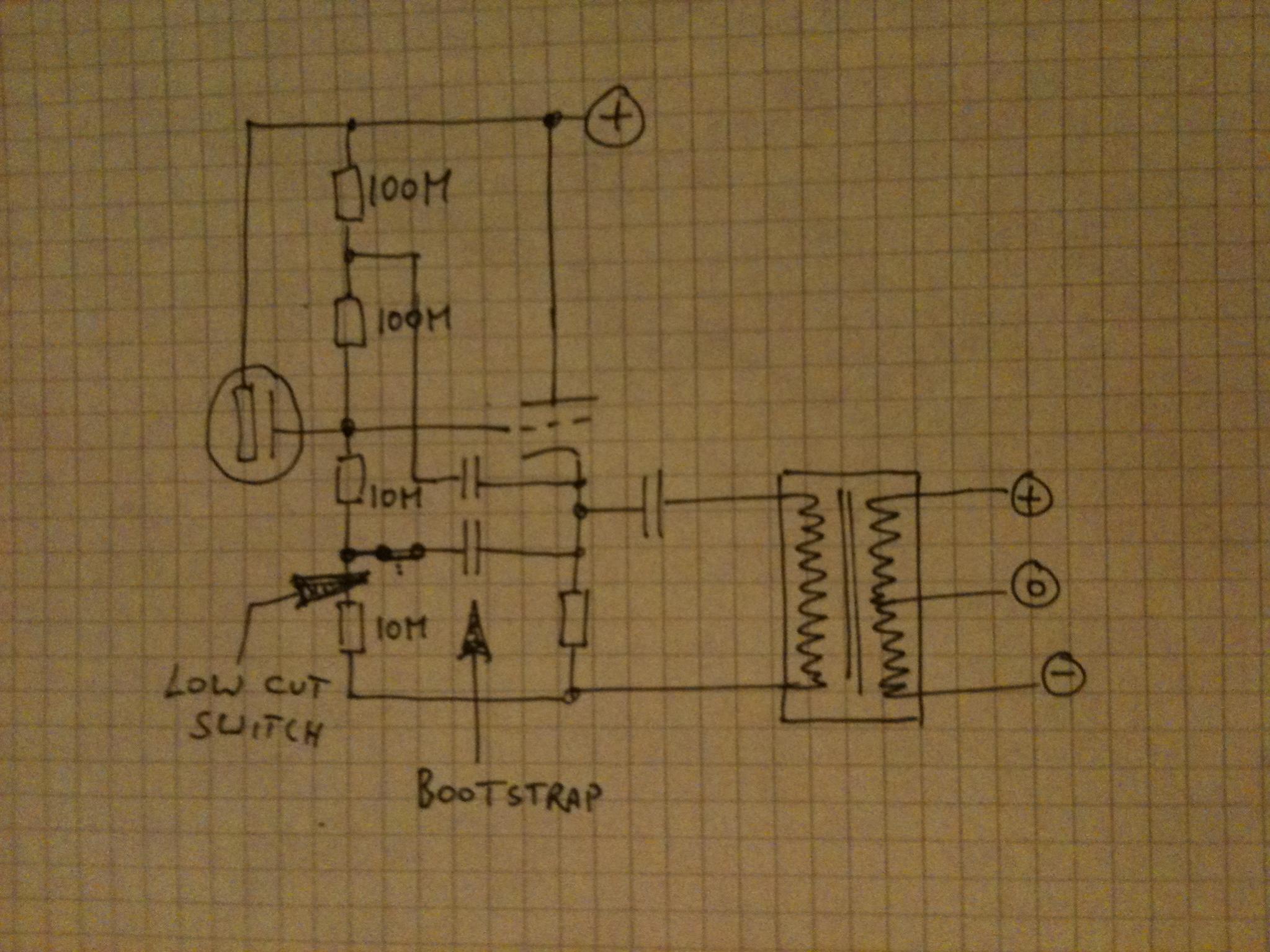

Just to clarify, the bootstrapping capacitor can be switched out to make a low cut filter. But that cap is there to bootstrap the input resistors.
The CCS will allow you to bootstrap that input resistor. You don't need a negative rail if you capacitively couple the input.

So if I try something like this?
I guess I can use higher resistance values, but I'm scared. Ok, seriously, it's b/c then I need to throw in another order to Mouser, and I aint planning any for a while. Just blew this month's budget on 6W6 tubes and a bunch of tolex, among other things😉
For a real 2.5 cm capsule it will be around 400 Hz low cut filter.
Agree, a little high. But I rechecked my stash, and it's 10meg ohms those resistors are😉 That makes the low cut a bit more usable.

No need for expensive ones: just increase 10 times the one that you drew already. As I said before, I use 18 megaohm bootstrapped.
Edit: 10 megaohm may be good, if you don't intend it to be used to measure woofers. 😉
A hint: one resistor from a bootstrapped divider.

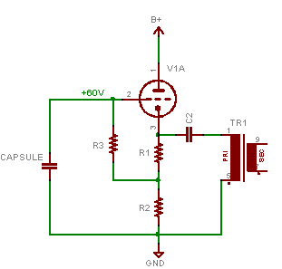

The capsule should be polarized with ~60V (assuming a "typical" large diaphragm capsule). I don't think it will work as well if the voltage is too far off that.
Here's a recreation of the AKG C60 schematic; my paper copy is barely readable. It has an idle current of about 0.5mA which I think is a good starting place. From that you can work out R1 and R2, then R3 can probably be on the order of 10's of Mohms because it will be bootstrapped.

Some more gratuitous comments and ramblings..
The AKG C61 uses the 7586 tube with the same circuit, at a little over 2mA standing current. This would improve the output cable drive capability of the mic. The grid resistor on the C61 is 200M even though it's bootstrapped.
The 6922 and 7586 have similar gm and mu.

Reading up on the noise question a little, it would appear that it's difficult to design a vacuum tube preamp ( the part in the mic) with with gain that has less noise than the capsule noise. It's not clear that simply decreasing the equivalent noise R, e.g. paralleling sections, helps. Historically this was solved on vacuum tube measurement mics (B&K) by using cathode follower preamps having unity gain.
The capsule noise is 1/f due to the equivalent noise resistance being a capacitance. Smaller capsules thus have higher self-noise. A-weighting in the measurements makes the capsule noise look smaller because the A-weighting curve counteracts the 1/f curve somewhat.

Yes, the settings are: Vocal, Music(1), Music(2). The AKG C60 has a similar selector labeled "0", "-7", "-12". The C61 has the same selector but uses an additional tapped inductor. I believe the inductance of the output transformer is being taken advantage of. Maybe you can play with the parafeed calculator; this could be a better approach than trying to do LF roll off by putting junk in the capsule circuit...
