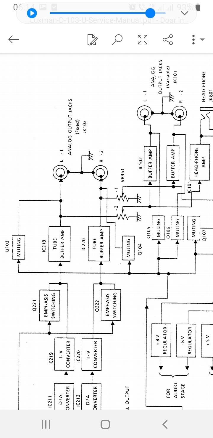

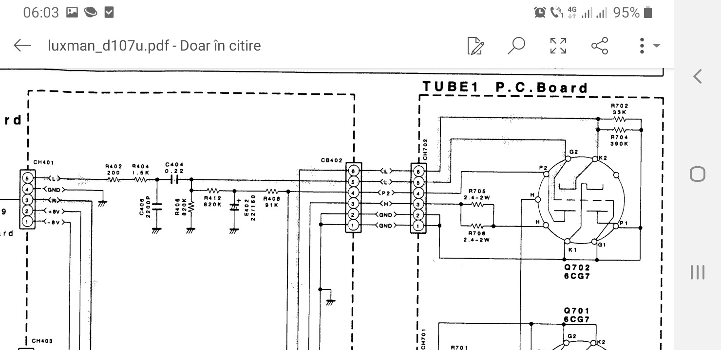

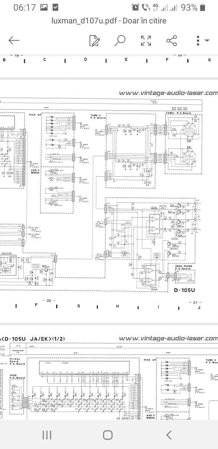

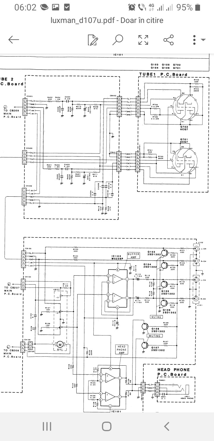

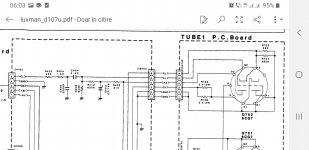

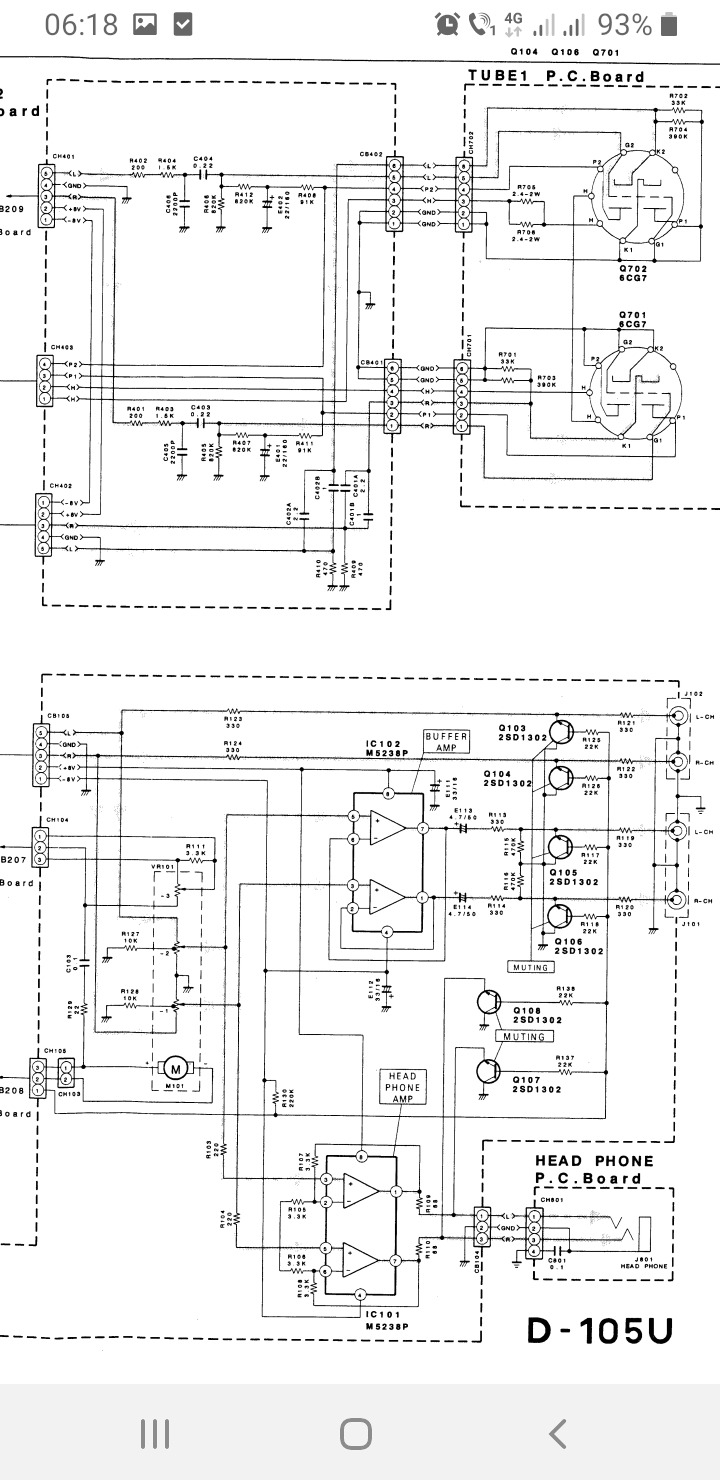

D103 doesn't show a clear cut schematic, D105 and d107 do it.
I wouldn't trust lampizator tastes...but he's the second guy to reedit Luxman's ideas, looking for the "tubey " sound...
http://www.lampizator.eu/lampizator/references/LUXMAN103/LUXMAN-D103u.html

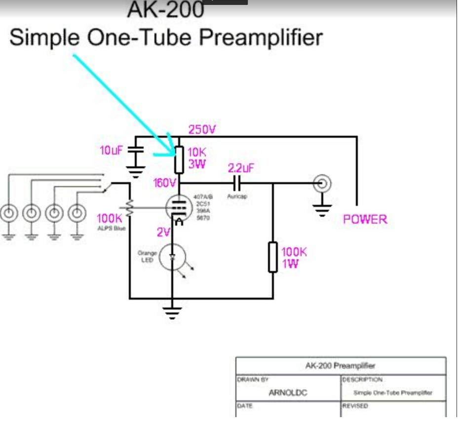

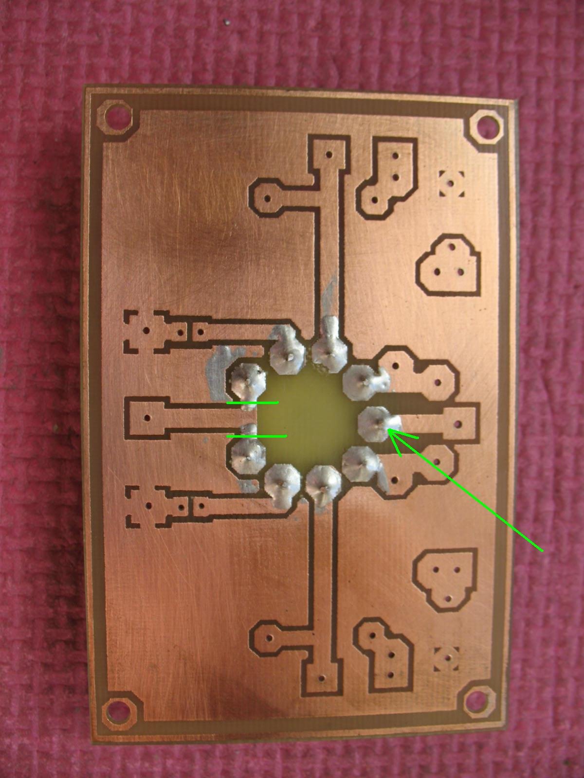

I would like to ask for help with my 5670 tube pre-amp. Someone produced me a PC board and look like it has some error on it.
The tube pin #1 and #9 which is the heater is connected together. Since the time I realized that I got discouraged. It is a simple pre-amp but I am familiar mostly DIY with semiconductors and not tubes.
Can someone help me to finish this project without burning or blowing up something. Thank you

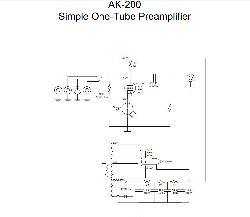

I post the schematics unfortunately The Grid stopper and Grid leak resistors are missing also. Some advise I need there to.

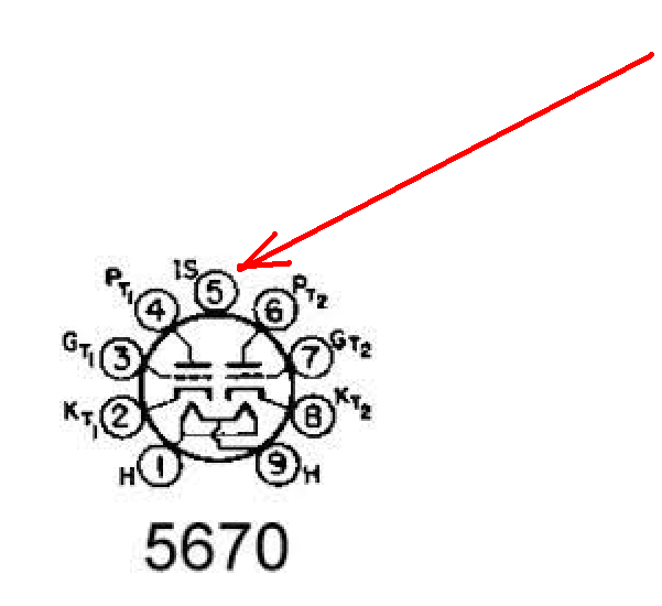

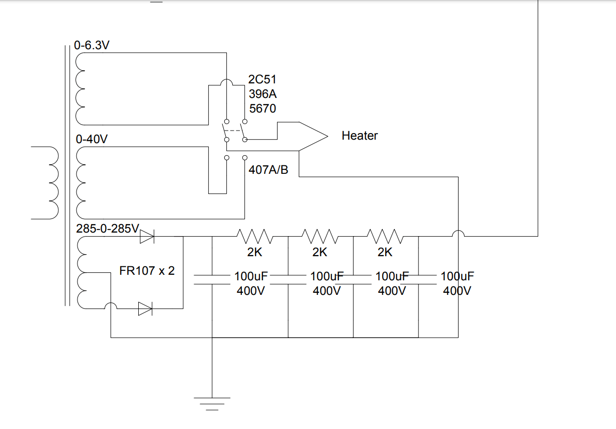

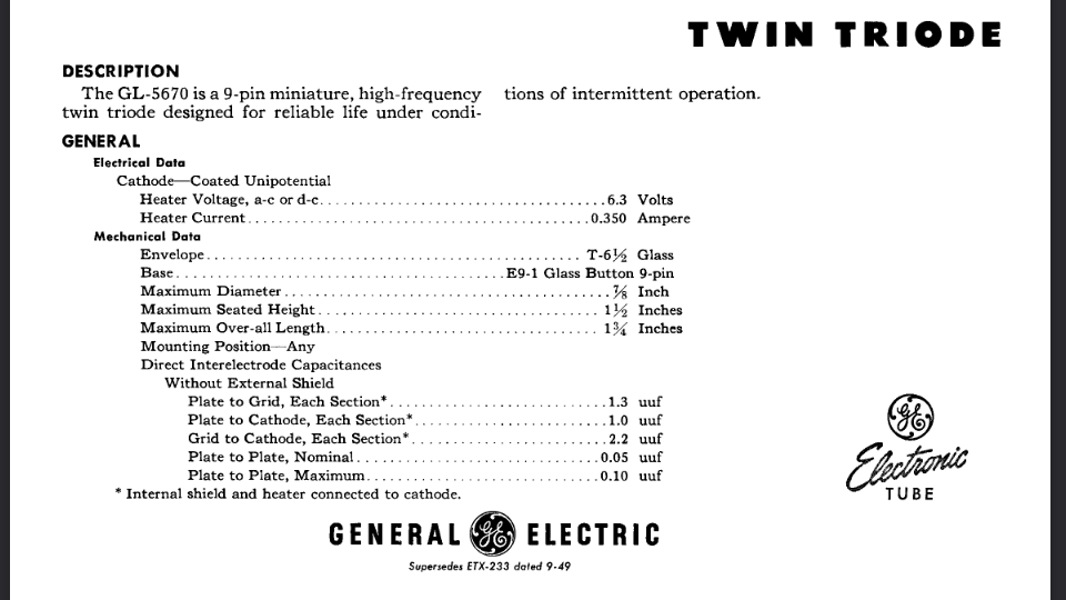

What do I do with pin number 5? 5670 has a 20V heater Voltage while the 369A, 2C51, 6N3 has 6.3V. The circuit was design with a toggle switch change the heater voltage. Should I connect PIN 5 to the ground? Please I need some help to complete these project , I have most of the parts for it.

5670 is 6.3V heater, not 20V. https://frank.pocnet.net/sheets/093/5/5670.pdf
Pin 5 is not connected or shield depending on the tube. It can be grounded.
Grid leak can be off of the board, grid stopper should have been put right by the grid pins.

Yes, that is a good idea👍, I already cut the bad traces of the heater so pin 1 and 9 will be the +/- heater connections.Maybe you can isolate the problem thru holes with the dremel and point to point them correctly?
It will be not a beautiful layout but does not matter much. It will be inside the enclosure including the tube to.
Function, sound, stability it matter.
I don't know what to do with pin 5 (internal shielding) should I connect to the ground with a resistor or with out resistor or just leave it like that.
The rest I figured it out.
I have one more question. Someone suggested to increase the plate resistor value from 10K to 18K or so.
That improve the sound and stability(?) he said. I am not sure about that. At the moment I soldered the 10K there but I have 18K at home also.
