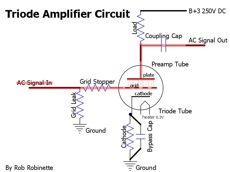

About the ground leak resistor a yes and it is for your own safety when disconnecting an tube output without ground leak resistor the output can charge a dangerous high voltage. I learned this just this summer.
Nice technics system.😎
Thanks for confirming the ground leak resistor. Would I be correct in assuming it's only required at the output terminals? Not required at the output of each cascaded pre stage, just final output?

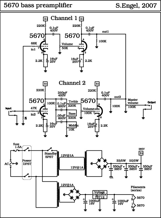

I would like to ask for help with my 5670 tube pre-amp. Someone produced me a PC board and look like it has some error on it.
The tube pin #1 and #9 which is the heater is connected together. Since the time I realized that I got discouraged. It is a simple pre-amp but I am familiar mostly DIY with semiconductors and not tubes.
Can someone help me to finish this project without burning or blowing up something. Thank you
I post the schematics unfortunately The Grid stopper and Grid leak resistors are missing also. Some advise I need there to.
What do I do with pin number 5? 5670 has a 20V heater Voltage while the 369A, 2C51, 6N3 has 6.3V. The circuit was design with a toggle switch change the heater voltage. Should I connect PIN 5 to the ground? Please I need some help to complete these project , I have most of the parts for it.

Maybe you can isolate the problem thru holes with the dremel and point to point them correctly?
Yes, that is a good idea👍, I already cut the bad traces of the heater so pin 1 and 9 will be the +/- heater connections.
It will be not a beautiful layout but does not matter much. It will be inside the enclosure including the tube to.
Function, sound, stability it matter.
I don't know what to do with pin 5 (internal shielding) should I connect to the ground with a resistor or with out resistor or just leave it like that.
The rest I figured it out.
I have one more question. Someone suggested to increase the plate resistor value from 10K to 18K or so.
That improve the sound and stability(?) he said. I am not sure about that. At the moment I soldered the 10K there but I have 18K at home also.
