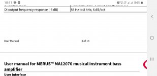

Tube preamp has bass guitar input and aux input. And preamp output. With tone control. just use preamp.

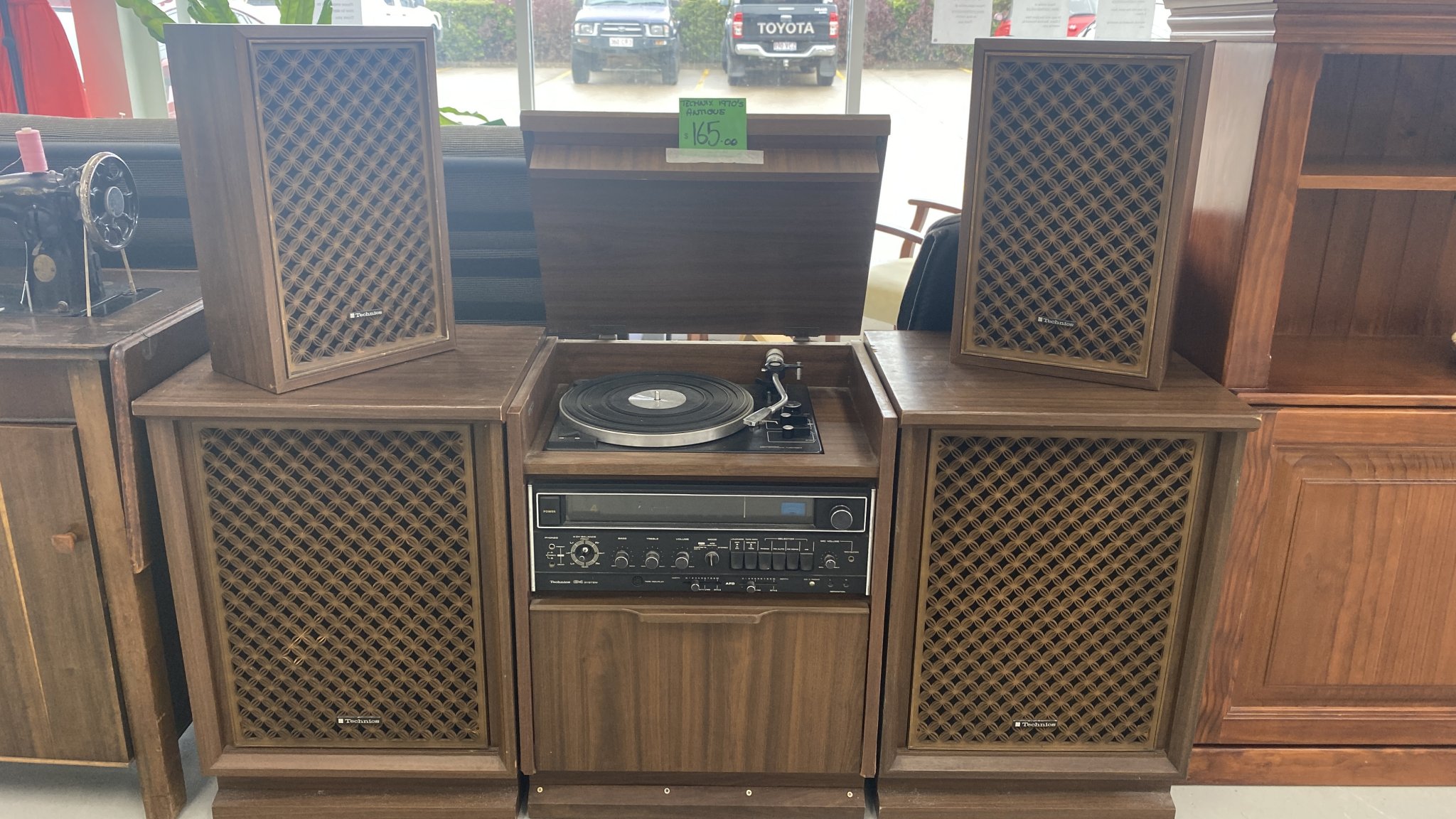

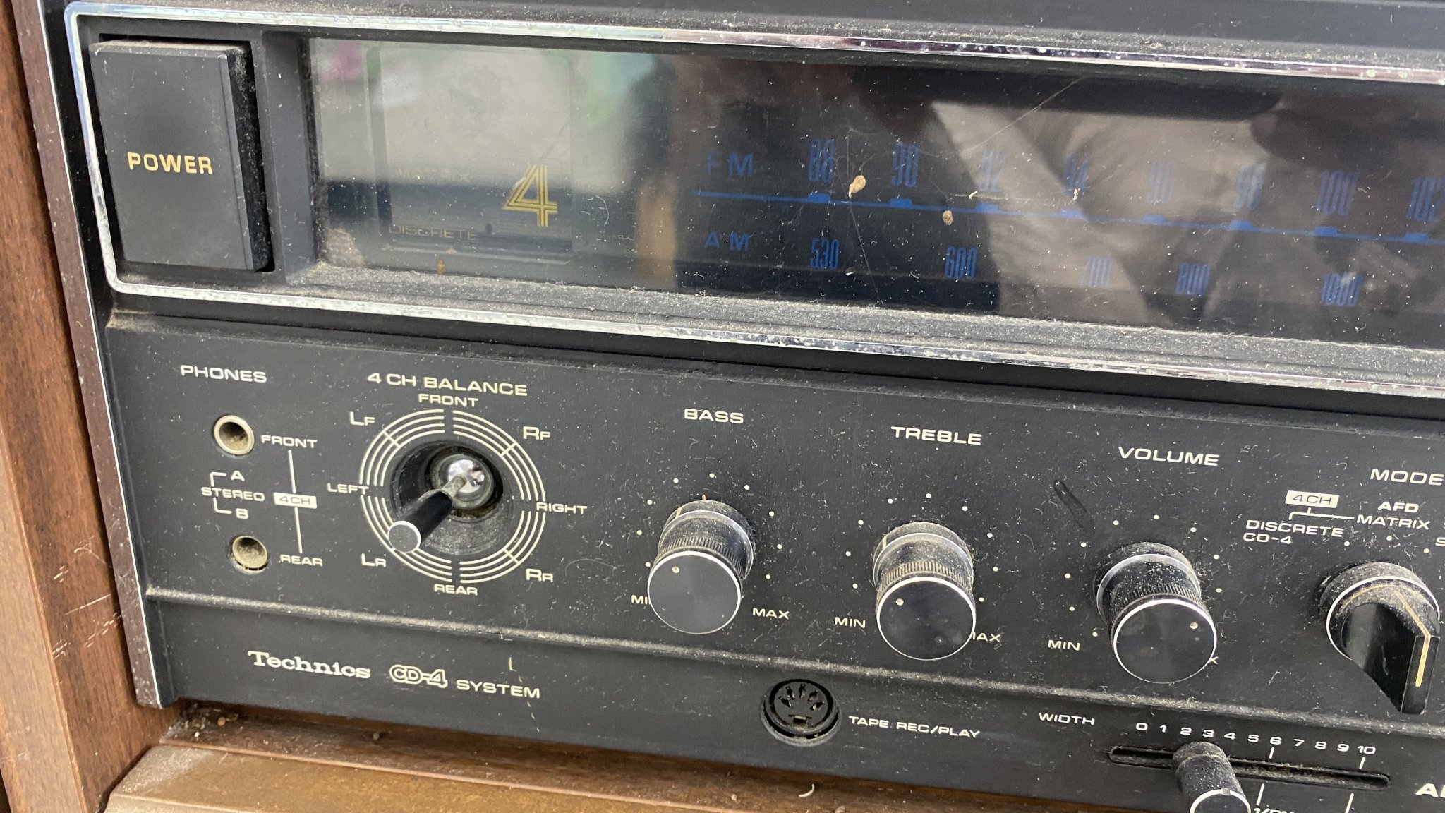

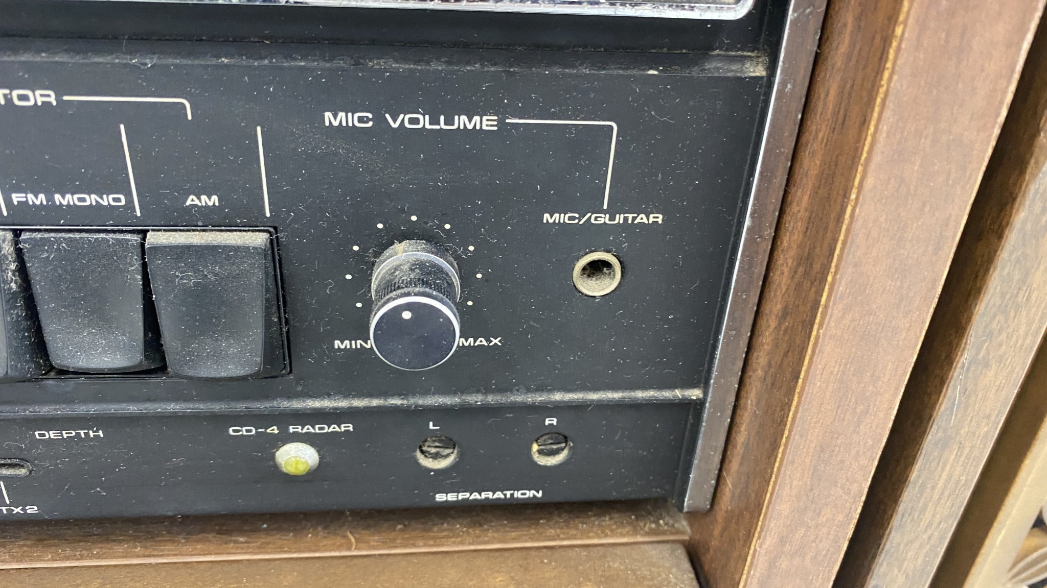

I was going past an op shop window this morning and spotted this! Looks like a fully integrated surround sound home entertainment system in fairly intricate cabinetry of that time made by a major Japanese manufacturer under their audiophile focused brand
It has a live input for mic or guitar and does a lot without menu diving!!!!!

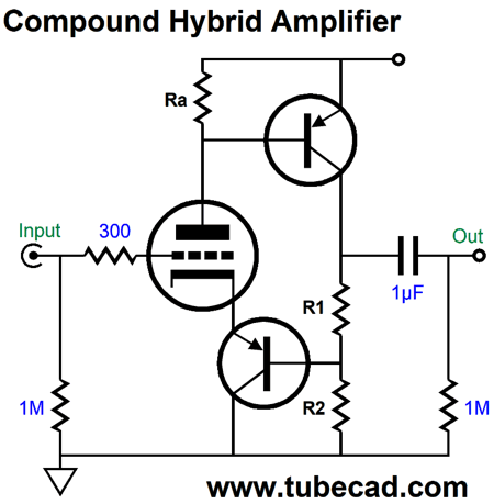

Learning about this. I can use the information presented for the top schematics tutorial to follow the circuit in the lower schematic untill I hit the 100k resistor to ground after the coupling cap. What does this 100k resistor do in this schematic?
Ground Leak Resistor
Is this the answer to my question? I am only starting out in this so would appreciate if someone confirmed this
The 100K is part of the tone stack. As all the paths after that end in a capacitor DC will not flow. AC current will but that is then shaped by the tone stack, through the volume pot and into the grid of the next tube. The tone stack provides a tuneable set of filters that all AC to pass to the next stage or to ground (actually the return to the power filter cap).
The grid leak resistors are the 1M ohm.
About the ground leak resistor a yes and it is for your own safety when disconnecting an tube output without ground leak resistor the output can charge a dangerous high voltage. I learned this just this summer.
Nice technics system.😎
Ahh the 100K pot to ground - missed that. Yup.
