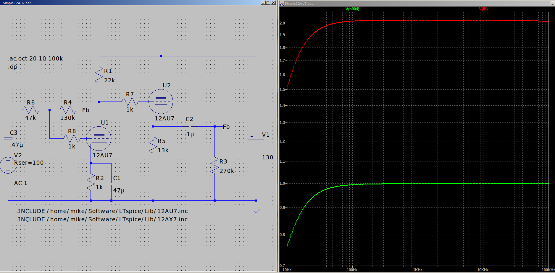

As I understand it the 12AU7 is one of the tubes that is relatively tolerant of low plate voltage. Since you only need gain of about 2 why not do an anode follower with the Rf adjusted for gain of 2. This will keep the HD in check.
Something like this.
attachment.php
