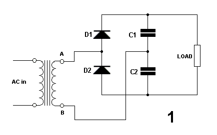

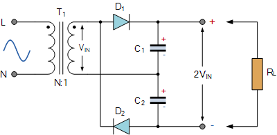

Turning your bridge rectified 150V into 300V is as simple as swapping two diodes of the bridge with capacitors. Caps cost more than diodes, but still should be affordable, no? It's only a preamp, so 22uF/350V caps would be fine.
Doublers work great for preamps. 100 uF 200V caps are less than $1.50 at Digikey.

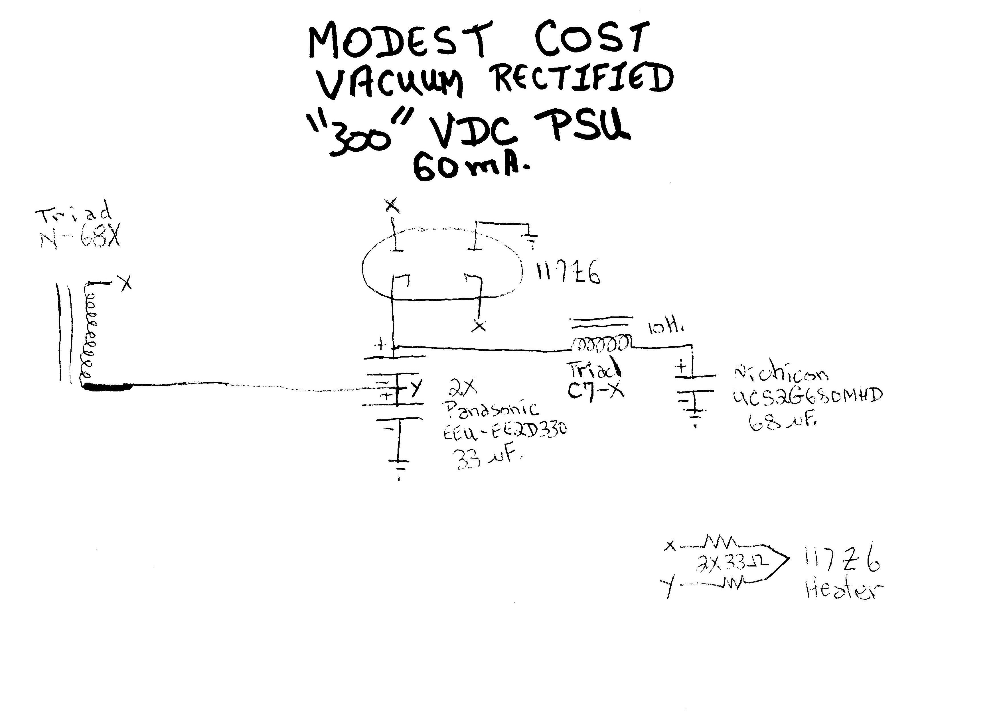

Doublers have been around longer than SS diodes. I'm providing a vacuum rectified doubler PSU that's suitable for use with preamps. The Triad N-68X isolation transformer it's designed around allows for world wide operation.
Do you need additional filter before the load?
I built a doubler, choke after the stacked capacitors, the another cap then 10k resistor into another cap, am getting horrible mains hum-
This is my first time to use voltage doubler-
Is it 50Hz or 100Hz? If 50Hz, it's not the power, and most likely a ground loop. If you have a DMM, measure the AC voltage on the B+ supply. Does the hum go away if you short the inputs?
If it's 100Hz, it's power related.
Usually, you build the doubler as if it was a diode bridge. Adding a large cap across the doubler caps might help if it's 100Hz.

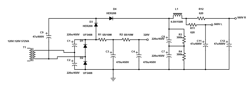

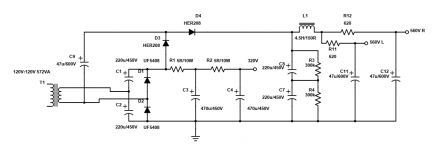

Here's an example of one of my supplies.

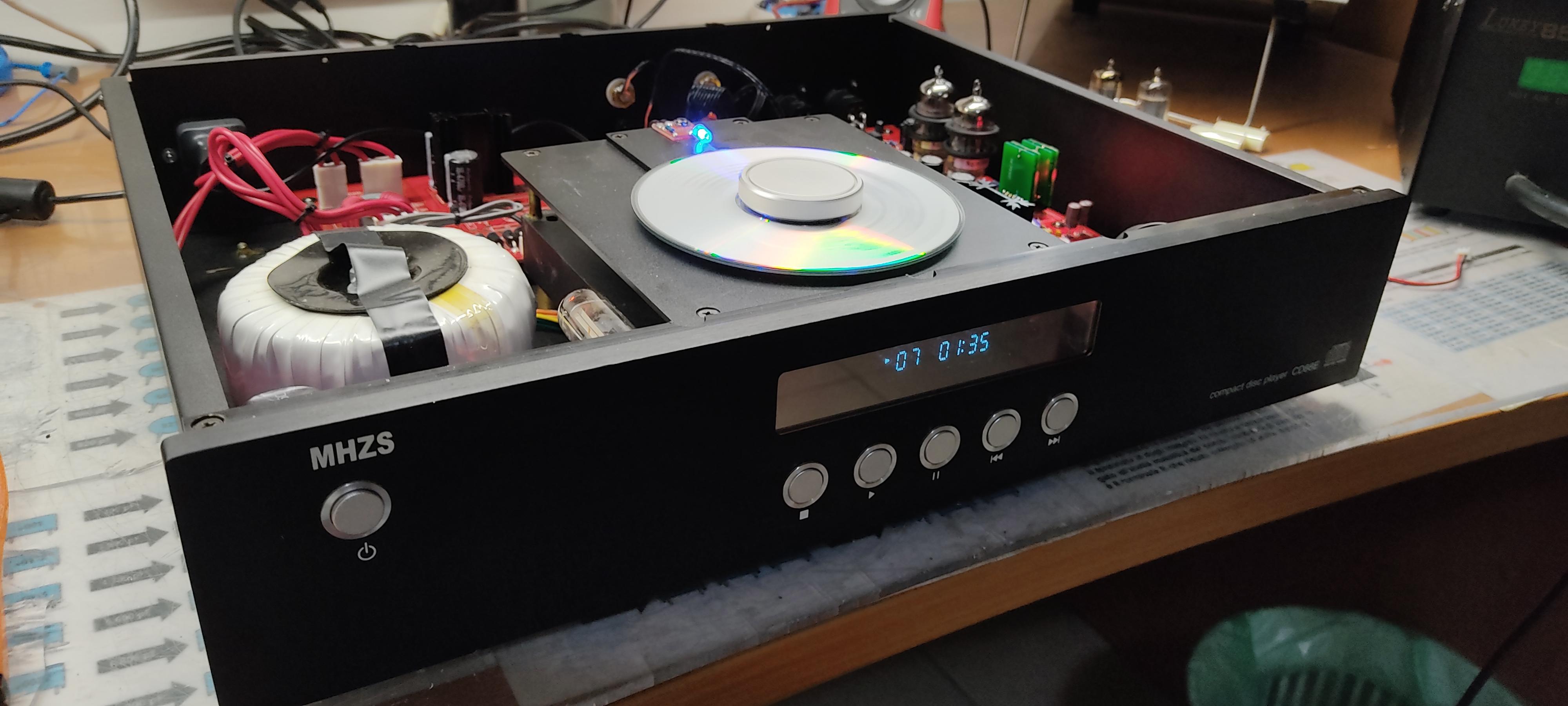

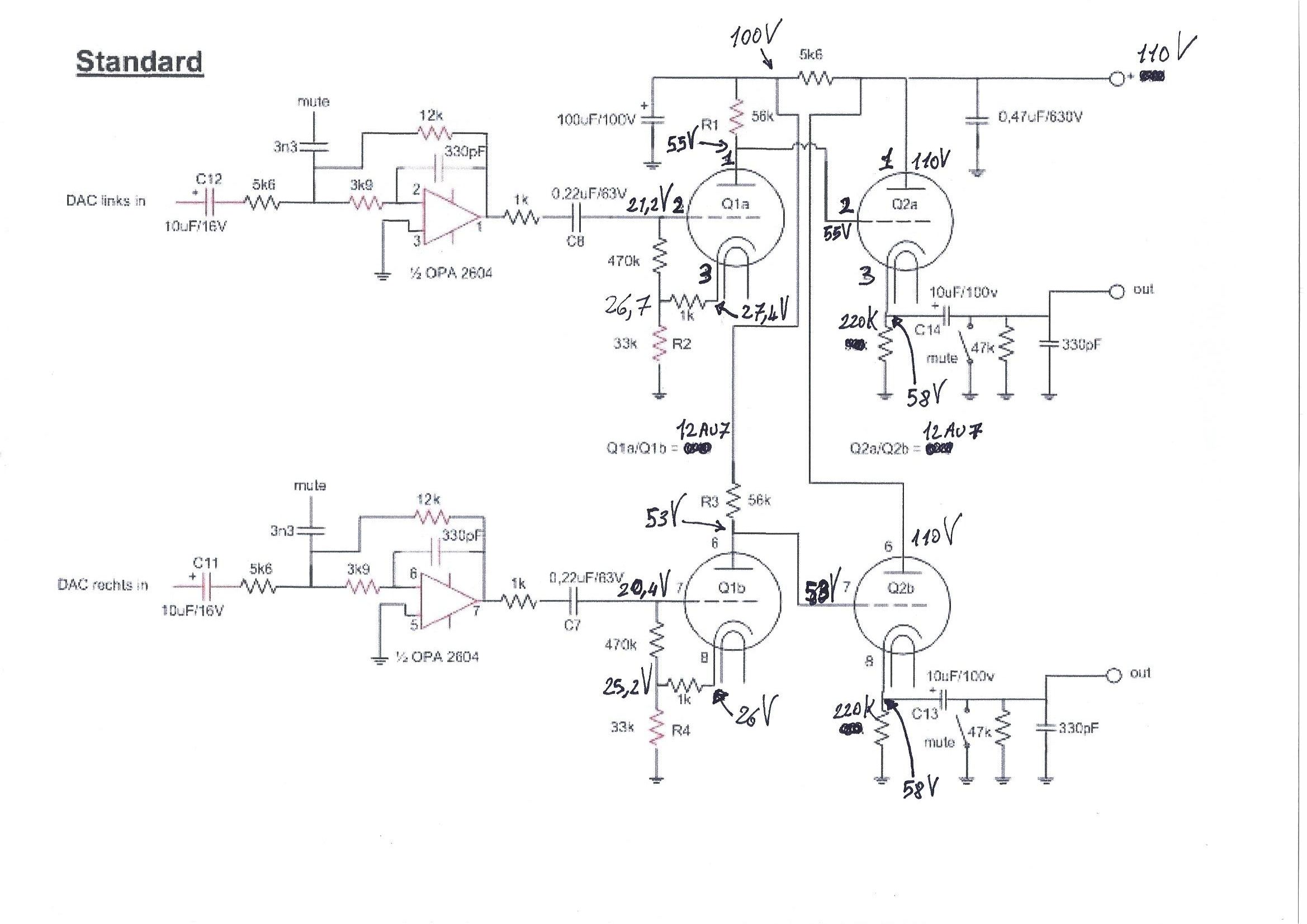

Mhzs CD 88 modding
Please i Need to calculating best resistors value for 12au7 tube instead 12ax7 original tube.
The tube out gain Is 1 , so i think is a buffer, i can also remove opamp, but in this case, i need tube stage with gain 2 , becouse opamp gain Is 2.
Please can you help me without change ht PSU value that Is 110v?
I have in my drawer also a couple of ecc88 if they are right for this pourpose.
You could try using this Universal loadline calculator for vacuum tubes - Vacuum Tube Amplifiers - DIY
or follow these steps - Load Line Calculations – wauwatosa tube factory
I Need to know if resistors value are right , this Is the Electric diagram of my MHZS cd88 , originaly with 12ax7, now with 12au7.
110V B+ is very low for tubes. Using a 12AU7 with that low of a B+ voltage, very low plate current and relatively high THD will be inevitable. What is the goal of this design? To add some audible 2nd harmonic distortion?
The gain from a 12AU7 will be in the neighborhood of 8x to 10x.
Do you need that much gain?
