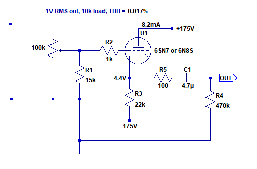

Low Z output with cathode followers are overkill most of the time. An RC loaded 12AX7 is one thing, a 300R cathode follower another.
Is adding an extra cap at the input, using a cathode follower and a huge output cap really worth it vs lowering gain in the DAC or poweramp? None of those three really improve the sound quality.

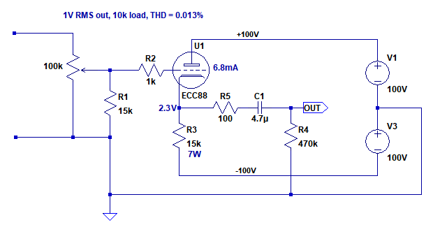

If the input cap on the cathode follower bugs you, it's easy enough to bias a CF with its grid at 0V (ground) if you use a bi-polar power supply. Say you took a 6DJ8 (ECC88) and used a +/-100V power supply. No input cap needed. Output cap still necessary.
If you'll only be feeding the buffer from a DAC or digital player, the input impedance can be down around 13k ohms with no worries. Try Rod Elliott's trick of making an approximately log-taper 13k stereo volume control by taking a 100k linear-taper ganged pot and putting a 15k ohm resistor from each wiper to ground.
The predicted THD is something like 0.013% into a 10k load, and all second harmonic. THD would be lower into lighter loads. Nothing audible.
With low voltages like that, you could make the power supplies all regulated. Or filter the heck out of them with 1000uF 160V capacitors. Like these.

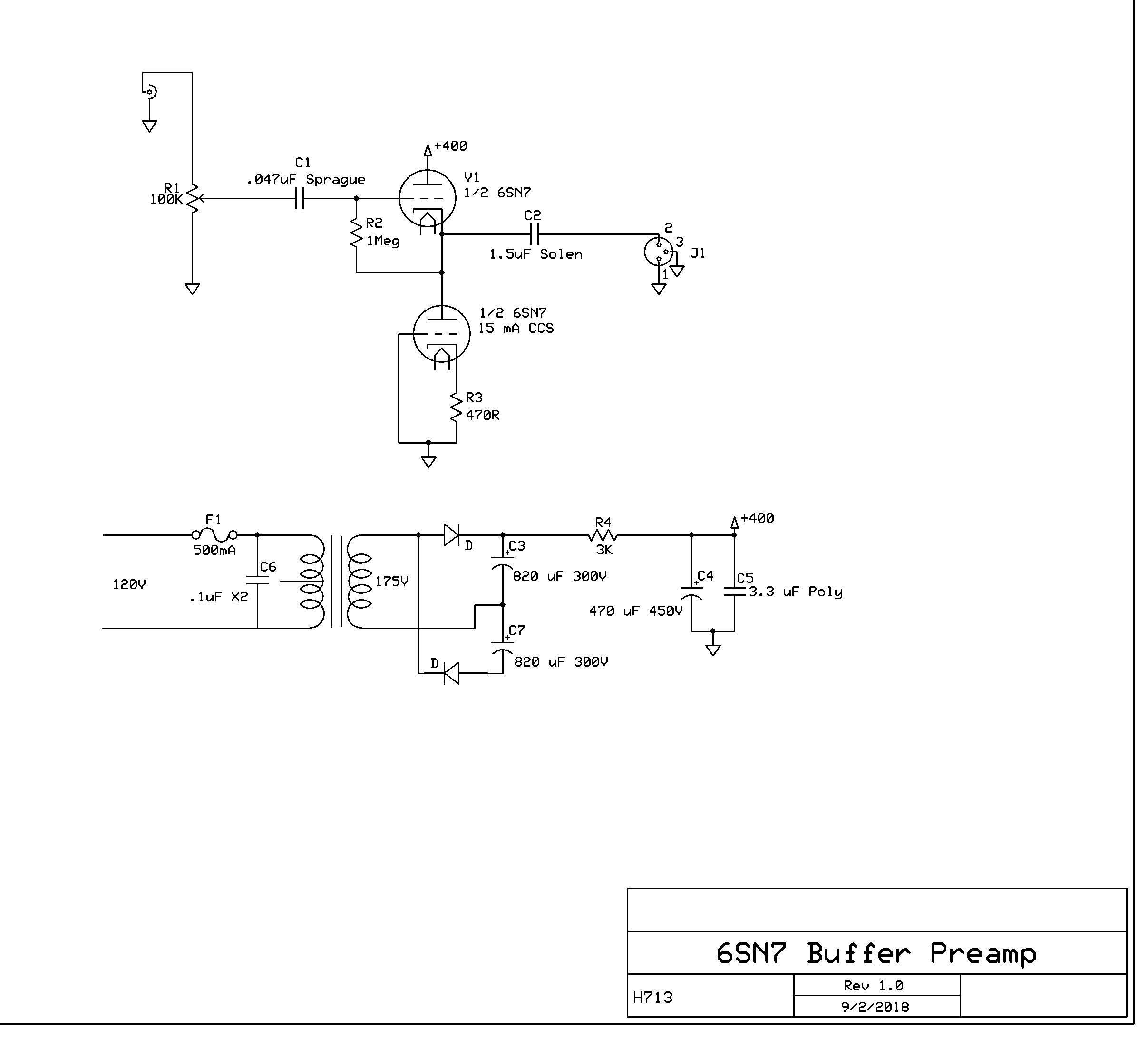

Here's where I'm at right now. I did have to abandon the idea of using the 120V to 120V isolation transformer. You could ABSOLUTELY substitute one. The distortion would rise a slight bit, however it is not likely to be noticeable. WIth 400V on the plate, the distortion is in theory around .005%, but in practice will be higher. Gain is slightly less than one. Attached is the schematic, as well as an LTspice file with the necessary models file.

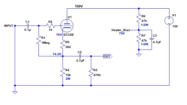

I would like to build this. I have a ECC82, and a 220 to 110 volt trato. I get a rectified voltage of 160 volts. I am not comfortable with higher voltages than this. ( newbie for tubes. No experience with voltage doublers for higher voltages. I can't read load lines and i am still learning it. It would be very useful if you can give me suitable resistor. Values for a B+ of 160 volt. I also don't understand by heater tap elevation ground,But i generally use a seperate Regulated DC supply for filament..

The heater tap elevation is to avoid exceeding the maximum heater-to-cathode voltage difference specified in the tube datasheet. The filament winding is isolated from the B+ winding. The filament winding is then "floated" so it that it has a DC potential of 100V (or whatever), but there is still a 12.6V AC potential across the tube filament.
There are ways of using a regulated DC filament supply, however, you will still need to consider the maximum heater-to-cathode voltage. As a hint, DC filaments are not always as simple to implement as they seem.
For a voltage that low (150V Ebb) I would say an ECC82 won't work very well. That tube requires a bit higher voltage to work well as a buffer.
What would you think of using ECC88 instead? That's a common enough tube, and will work well with a 150V Ebb if you use a 15k cathode load resistor, 360 ohm cathode bias resistor.
Since ECC88 has a maximum heater-to-cathode voltage of only 50V, you'll need to reference the heater supply 'ground' to +75V or thereabouts. That's easy though. Just make a voltage divider of two 47k ohm resistors
Make the output capacitor a larger value, like 4.7uF, if you're going to use it into a contemporary amplifier like one of those little class D things. 1uF is fine if you're going to use it into a tube amp.
Something like this, maybe?
