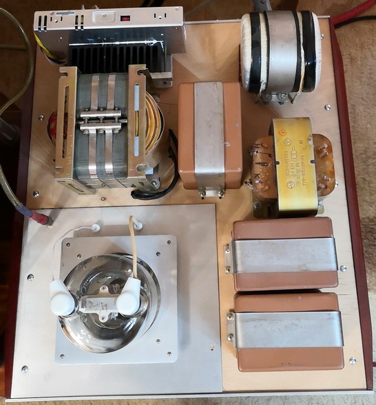

The anode power supply in the output units on the gm70 and gu48 is organized differently. In the case of gm70 (1100 volts), emitter followers on IGBT BUP314 transistors are used to smooth out ripples. For gu48 (1950 volts), the usual CLC circuit was used (100μF - 20H - 200μF, film capacitors K75-24, each 100μF x 2000 volts). Shunts made of silver-mica capacitors were installed directly on the tube panels. The anode voltage rectifiers use Qspeed series 600 volt 5 ampere diodes. For sound, both approaches give a fairly close result.
Gm70 filament heaters are made with rectifiers based on germanium diodes D305 (50 volts, 10 A).
Gu48 filament heaters are made using switching power supplies, after which RC circuits are installed to suppress high-frequency noise. Three 0.1 Ohm wire resistors connected in parallel come to each filament contact, and between the filament contacts there are three capacitors connected in parallel - silver-mica, film, and electrolytic at 3300 microfarads. The noise reduction on the filament legs was checked using an oscilloscope.

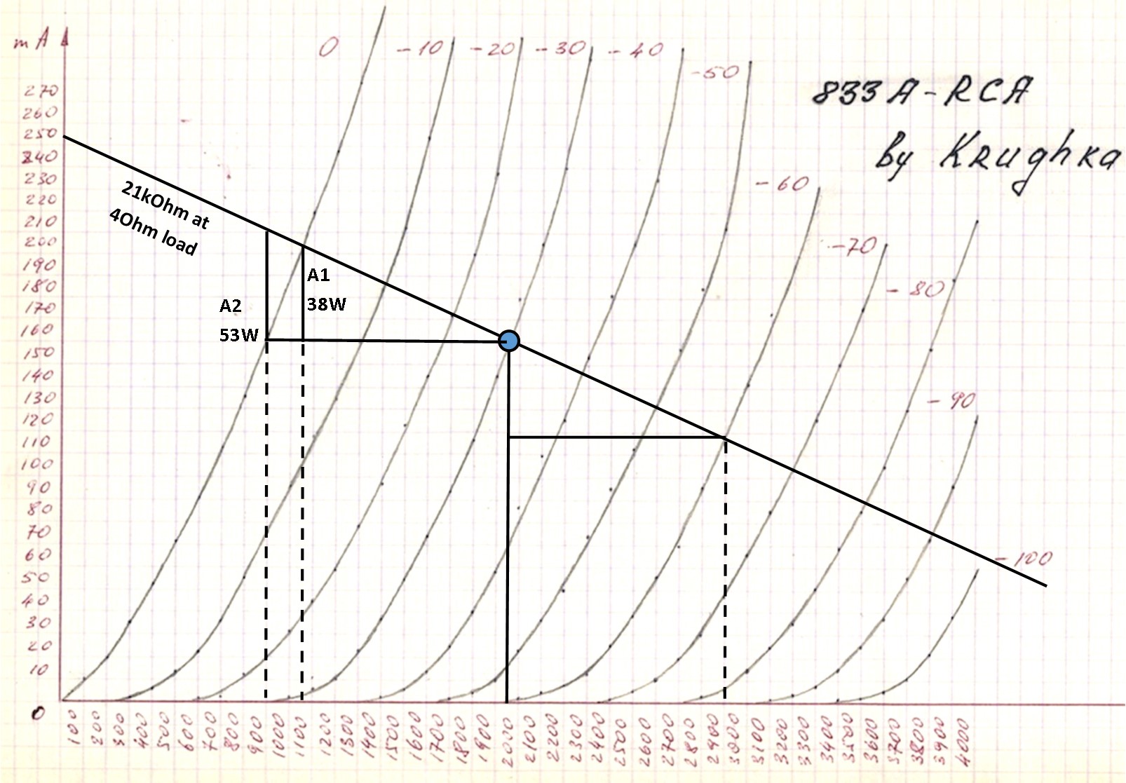

It should also be noted that the desire to lower output impedance, for better matching with loudspeakers, runs counter to the desire to increase the output power. For the gm70, output transformer with a turns ratio of 50:1 was used, while the maximum output power in class A1 was reduced to 18 W with an output impedance of 0.8 Ohm. For example, the maximum output power can be nearly doubled by using a 35: 1 turn ratio, but this increases the output impedance to approximately 1.4 ohms. Manufacturers of amplifiers based on gm70 usually use the second option, since 18W output power does not attract potential buyers.
In monoblocks on gu48, the output transformer has a turns ratio 72: 1. The output power is about 50W, but at the same time we have to go a little into class A2, with grid currents. Due to the high internal impedance of gu48 (about 4 kΩ), making an output transformer is a rather difficult engineering task. I came to a compromise and ordered transformers in Israel (several times cheaper than Monolith Magnetics).

As I have mentioned in #3, manufacturers usually put the output power on the top in their designes. From the review of WAVAC amplifier in Stereophile, "The SH-833's output impedance was on the high side, at 5 ohms from the 8 ohm transformer tap and 2.6 ohms from the 4 ohm tap." At this, stated output power is 150W. I wonder, is this situation really preferable to users? What real world speakers sound good with very low damping factor?

In this article one can find many info about possible schematics for driving 833 tube.

VladimirK, that's a very nice looking build. Interesting way to mount the, I presume, two toroidal transformers. What are they for?

Hello, Matt. The core of this toroidal transformer was epoxy-glued from three standard cores with a power of 150 watts each. The result is such a tall core and non-usual shape of the toroidal transformer. An AC voltage of 1470 volts is generated on the secondary winding of this transformer, which goes to the gu48 plate voltage rectifier. The toroidal transformer is fixed in such a position as to minimize the penetration of the external magnetic field generated by it into the output transformer. In earlier designs, when the power transformers were not properly positioned relative to the output transformer, hum due to induced external magnetic fields occurred.VladimirK, that's a very nice looking build. Interesting way to mount the, I presume, two toroidal transformers. What are they for? Cheers
