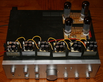

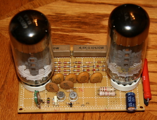

This is what I have built so far.
To assemble one board doesn't take too much time 2-3 hours.
And there is 4 boards for 2 channels. High voltage supply is cascaded
6 separate transformers each giving 800V. This is actually 220V/12V
step-down transformers put backwards and 12V side in series to
fit 110V input. Well, each transformer will see more than rated 12V
but in my case no overheating. With help of voltage doubler circuit
I was able to get over 800V from each transformer.
Power supply is around 250W, which considering max. allowed
dissipation of the 4 tubes (4x30W=120W) is OK.
To get custom made power transformer cost a fortune.

Today I put all together and it was partial success.
Amp is working, good pretty clean swing, but the bias is too low.
Probably because I am using different tubes than original ones.
Also when I play 1K sine there is sound coming from the tubes
like running water and it is pretty loud.
My main problem now is low bias, only 1.5mA instead 5-6mA.
Any advice what to do to increase bias?

sasha - perhaps you're finding out that the tube might not be the best one. If your circuit is correct, then perhaps the tubes have a different transconductance that will allow only what you're finding. That's only a guess , I'm no true expert on tubes. Not sure what else to tell you at this point besides to verify your bias circuit values.
Sasha don't let your first result let you down.
The choice for 6HV5 is a good one, altough I still have to try it.
Your bias is indeed to low, ofcourse because you are using a different tube in the circuit for 6HB5.
What you could try is to increase the G2 voltage by increasing the +150V on the bottom tube. Consequently the upper tube must change to if you use this methode. This can be done by altering the 470K resistor.
The other methode is to lower the G1 voltage on the bottom tube.
This could be done by playing with the 100k collector resistor to the -150V.
Your goal is to have 6mA bias with half of the supply voltage at the cathode of the upper tube.

Actually I manage to solve bias problem by lowering G1 voltage on the upper tube.
First I tried with bottom tube but that was no good
because preamp circuit developed distortions with change of 100K
resistor. On top of that I didn't realize that tube I am using is
triode and original one is pentode as "rcavictim" pointed out.
He suggested to connect G2 to cathode and omit voltage divider and
150V to G2 so I did. Now bias is fine.
Next problem was proximity of high voltage lines and feedback line.
This gave me some peaks in output signal when close to max swing.
Silicon should solve that problem.
I remember concern from one member regarding not enough
current produced by output needed for driving speakers on high freq.
Today I watched music signal on RTA to see how much of high freq.
is actually in real (music) signal. I compared 2K and 16K and found that 16K is on average 15-20 dB below 2K which was the strongest
in the spectrum. That means 16K has about 32-100 times less swing.
I hope my math is right. This suggest we should have enough current.
I was able to put 40mA in my tests through dummy load.
As soon as silicon I applied is dry I will try speaker load.
Distortion figures are ok. Only 0.5% THD on full swing (9KVpp) and
3% fully loaded (dummy load).
The rest is coming soon.
