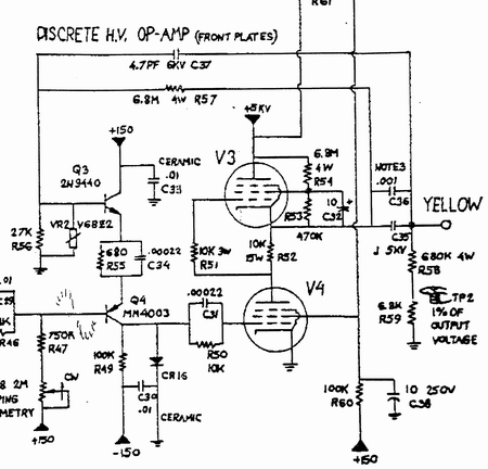

Hello all,
I am close to finishing Acoustat SC-X3 DD tube amp from 1979.
I am having problem determining what is the part on the schematic
marked VR1 and VR2 with number on it V68Z2. I believe it is a trim-pot
but I am not sure. This question would be best answered by
djmiddelkoop since he has experience with this amp. Anyone else
is welcome to help. Also, I need four 0.1mF(micro Farad) / 5000V
for this amp and if somebody has it I am willing to buy it.

VR probably means Voltage Regulator
VR1 and VR2 would normally be contractions for Voltage Regulator 1 and Voltage Regulator 2. With a name like V68Z2 it sure could be a 68 Volt zener especially since 68V is a standard value for a zener. The less common symbol sometimes used for a zener diode is a little rectangular box with a streched "Z" in it usually turned sideways, it could look like a trim pot symbol.
If I'm right, your biggest problem is in detrming the correct wattage zener to use. Find the supply voltage, between that and the zeners (in series?) will be a resistor. Supply Voltage minus zener voltage divided by resitor value equals zener current. Current times zener votage equals watts; typically one would use a zener around double this wattage for margin.
One other component often called a VR is a transient suppressor like a metal oxide varistor. These also come in 68V versions. They are designed to absorb a high transient energy and have relatively loose voltage threshold accuracy i.e. they will trigger somewhere in the neighborhood of 68V.

Arc suppresion?
ESL panels are known to arc over from excessive excursion or dirt.
I would guess that VR2 is meant to protect Q3 from large voltage spikes. There is AC feedback from the panel back to the amplifier through the 4.7 pF capacitor C37. If VR2 was a zener it would kill this feedback unless the volatge divider of R57 and R56 is arranged so that the zener normally does not conduct.

Maybe it is a thermister used to thermally stabilize circuit.

Thermistor
The traditional symbol for a thermistor is a resistor inside a circle.
Othet than that as I said earlier I'm guessing, but I am an EE and I do have 30 years design experience. I think my guess is good but unfortunately I can't guarantee it.

Another guess:
Multi turn trim-pot for tube bias adjustment. I don't see any other
way to adjust bias in this circuit and I think bias adjustment in
tube amps is a must. Since this is only one half of the one side
of the amp it is important to adjust equal bias on both sides to
achieve minimum voltage offset on the output.

Sorry for the late reply Sasha, didn't notice it before.
VR1 and VR2 are Varistors(=resistor which acts like a zener above a specified voltage) with the orginal P/N 6BZ2.
They are used for protection of Q1 and Q3.
In case you cannot source the parts, replace it with a 1N4007 diode from the Base (Anode) to the Collector (Kathode or white band on diode) of these transistors.
This will give protection also.

Thank You so much Dick,
Now I can finalize my amp. Is there anything else important I should know about it and it is not in the schematics before I flick the switch??? Are all values in the schm. correct?
And bravo to You hermanv, You were spot on regarding this mysterious part.
