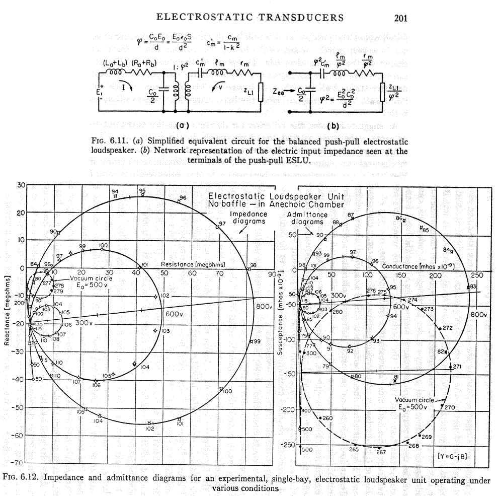

revintage said:Does anyone have an electrical model of a typical ESL-panel? This would make it easier to do a lot of the prototyping in Pspice. Do not think the model is as easy as just a capacitor.
Your hunch that an electrostatic speaker's input impedance is not as simple as just a capacitance is right on. The input impedance of an electrostatic speaker is as complicated as that of a cone speaker, depending upon many factors, not the least of which is the radiation impedance seen by the speaker (a nearby wall or object affects this). F.V. Hunt published an analysis on this topic years ago, and I've posted a composite of his equivalent circuit and impedance plots in polar coordinate form. Your next question might be "what are the typical values for each component". My answer is that there really are no typical values. Sorry, this won't be easy to plug into PSpice; there are just too many variables.
revintage said:The step-up transformers is around 1:50 I guess (4:10000 ohms). And for some reason they do not use the center-tap for the EHT, it is connected to one of the secondaries. Can supply you with a schematic of filter and transformer later today.
Great Brian! Can I humbly ask for the sides before and after from this analysis?

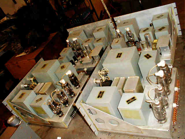

Modulation transformer from AM broadcast transmitter with ES speaker?
I haven`t read this entire thread but a search did not yield an answer.
I would like to know if anyone has any experience trying to use a plate modulation transformer to directly drive electrostatic loudspeaker panels, with the usual HV DC bias supply for the panel of course.
A plate modulation xfmer is just like a normal P-P output xfmer except instead of a low Z speaker winding for the output secondary it has a high-Z winding (often several thousand ohms), insulated for high voltage which impresses the audio modulation of the modulator to the B+ which goes to supply the transmitter`s output RF power amp tube(s).
I have a pair of really nice 1950 audio modulators from two identical vintage RCA, AM broadcast transmitters which use a pair of 809 triodes in p- p to make about 50 Watts RMS audio output power. If I replace the output transformer, a Hi-Z modulation xfmer with a normal P-P iron I could have a conventional amplifier.
I would like to know if I can use the existing modulation xfmers in a specialized application, like driving ES loudspeakers.
I do know that my modulators would be ideal to plate modulate a RF power triode used as power oscillator to power a plasma speaker. Plate modulation is more expensive and complicated but produces the lowest distortion compared to other modulation methods, like screen modulation as an example.
Pic of my two power supplies and two modulator amplifiers shown. There is more high quality oil filled iron here than in the Exxon Valdez.

revintage said:Great Brian! Can I humbly ask for the sides before and after from this analysis?
I'd like to help, but F.V. Hunt's analysis is a long and rigorous march of 44 pages on electrostatic transducers, that builds on previous chapters needed for full comprehension. Posting one or two more pages won't help, and I don't want to get into copyright infringement beyond "fair use". The book is currently published (reprinted) by the American Institute of Physics for the Acoustical Society of America (or it was when I bought it several years ago).
Anyone with reasonable technical and mathematical skills who is serious about understanding electrostatic transducer theory should consider buying the book. It's not an easy ride, but Hunt published the most rigorous analyzes available on the subject, at least to my knowledge:
Electroacoustics by F.V. Hunt
Yes, and it's probably PCB oil! Watch out for leaks!
Will order at once! Seems to be the loudspeaker bible.
Lars
revintage said:Will order at once! Seems to be the loudspeaker bible.
Good. I don't know if I'd call the rest of the book "the loudspeaker bible", though. It's a rather idiosyncratic book, picking and choosing its topics in a less-than comprehensive way. But, again, for ESL understanding, it's required reading for math-oriented types.
Re: Re: Modulation transformer from AM broadcast transmitter with ES speaker?
Brian,
Thanx for the reply. I hadn`t considered that these mod xfmers would use gapped cores but you are absolutely right. Interesting. I wonder what else one could do with them as a result. One idea is a SE to P-P (or SE) grid driver xfmer for a large class A2 output stage. Operating at reduced current would improve the bass extension!
I need to slide these amps out from under the bench and measure the transformers as you suggest.
Fortunately none of the xfmers has any seepage or leaks. It is my opinion that the only hazard from PCB oil is not from contact with the oil, but from contact with the EPA when they discover you are in possession of it.

Brian,
...but from contact with the EPA when they discover you are in possession of it.
I won't tell them, promise. I have several chucks of iron that have PCBs within them, and I keep a wary eye on them.
I wouldn't let the gapping turn you off. Let's see what you measure. I think the idea has real merit. The turns-ratio will be of primary (pun) importance of course. The secondary is probably not center-tapped, so to bias the ESL diaphragm, you'll need to create a pseudo-CT with a pair of high-value resistors. No big deal.
In fact, there may a number of complete old plate-modulation tube amps that are ready for direct ESL use as-is (or almost as-is). What a thought! Now we may have created a run on modulation amps. I've got some old mod amps myself in my musty pile of boatanchor carcasses, and probably some modulation transformers too. If I had any free time, I'd look them over. Please report what you measure in your own amps.
