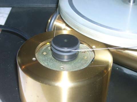

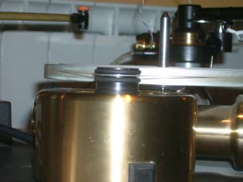

Clack said:I also have a TT with domed pulley. As I like very much the way it sounds with a belt made of dental floss I placed 2 o rings of the right diameter in the pulley, so they keep the belt in the right position. It works on my TT, I will use them as long as I will be able to have a separate PSU with speed control

mm, this may not work in a TT with a suspension like the LP12 or ariston RD80/110. The reason is that when the suspension rocks a bit the string (which is not elastic) will slip. The normal rubber drive belt has enough tension to keep it held in place.
i once made a belt from 6mm tape (cassette tape) but it wouldn't work because of this.
If its not suspended it will work AOK though. I've used floss, thread and now 20mm tape as drive for my Teres deck.

Regretfully I am connected with a mobile phone. It cannot send pics. Anyway I take some and will post them soon from an internet cafe. Basically the trick works this way: the o rings stand at the upper and the lower edge of the pulley, that is high enough to leave some room (3-4 mm.) for the belt. So the belt is forced to go in the wider part of the pulley. I still have a speed slightly lower than 33 1/3, checked with the strobo of my old RD 40, but it is unnoticeable. My TT is rigid, Kuzma Stabi S, but I think this could work also on suspended TT, as long the belt is not too tight. The suspension rocking is very slight in normal working condition, i.e. not bounced to check its adjustment. Regretfully I am connected with a mobile phone. It cannot send pics. Anyway I take some and will post them soon from an internet cafe. Basically the trick works this way: the o rings stand at the upper and the lower edge of the pulley, that is high enough to leave some room (3-4 mm.) for the belt. So the belt is forced to go in the wider part of the pulley. I still have a speed slightly lower than 33 1/3, checked with the strobo of my old RD 40, but it is unnoticeable. My TT is rigid, Kuzma Stabi S

Thank you Nanook, I was breaking my head because having listened the sound of my TT with dental floss belt I would never go back to the rubber, but the speed was too low. While searching a DIY PSU to build (too difficult for me? the Kuzma one is about 1000 euros here) my eyes fell down to my tube phono preamp that uses o rings to reduce the microphonic effect of the tubes. I took one and it was just the right size, so I placed the second and it worked. Anyway I hope to realize my own PSU. Perhaps you like Zappa? Me too, quite a lot.

the solution is nice and simple. I have used a very strong nylon thread that upholsterers use here for car interiors and items to be left out in the weather. It has something like a 125 lbs "test weight" if comparing top fishing line, and doesn't break down over tiume (my spool of thread has lasted over 20 years, has done innumerable car interiors, clothing and audio "repairs. Any time I need good solid "thread" that's what I use.
The issue of getting good pulleys can be tough. But not anymore, thanks to you... a simple wooden dowel of an appropriate size, drilled for a motor shaft (even glued if need be), and a couple of O rings. Great.
