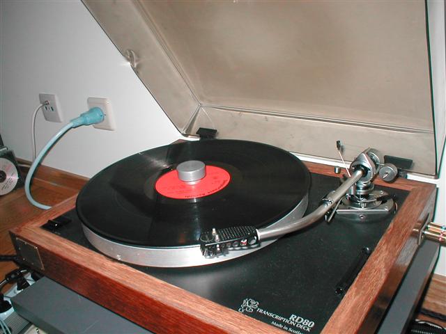

The RD80 has the motor connected directly to the mains (220v 50Hz). From what I read, I must power it wih only 65-70v ??
I need to read a lot before I start this project. I must fully understand how this motor works. Could you please point me in the right direction ?

The motor is set to run on 110V supply and either 50 or 60 Hz. What happens is that in the control circuit, a capacitor causes a phase shift in the AC sine wave. This means that before and after this cap, the sine wave will be opposite. One of the windings of the motor is connected before the cap, and the other after the cap. The other 2 motor wires are connected to the other leg of the mains supply (eg neutral).
Heres the heart of the improvement however. At 110V the motor will vibrate quite a bit. So the idea is to use a power resistor to drop the voltage which will reduce the vibration, hence improved sonics. Drop it too much and the motor won't start the platter on its own, drop it too little and you don't get all the benefits.
Just use a 5W resistor to do this drop. If you buy say a 3K, 6K8, 8K and 9K resistors, you can try each one and see what voltage you get in the circuit. If you go much below the 70V mentioned above, the platter may not reliably start.
So the circuit works like this:
Designate one wire from the transformer as "positive" and one as "negative" (even thought this is AC, not DC). Join the 2 grey wires to the "negative" wire. Add the dropping resistor to the "positive" one. then add the capacitor (0.22uf). One of the remaining motor wires goes before the cap, and the other after the cap.
Size the resistor to give you ~70V - measure the voltages while the motor is actually running the platter.
Thats it really!

Now I understand perfectly what to aim for.... less voltage = less vibration.
So the transformer is needed to get 110v from mains 220v and then do a voltage drop using only a resistor !

I still cannot figure out my TT motor setup:
The motor is connected directly to the mains 220.
If the motor is set to run at 110v, how does the voltage drop happen ?
I hope this question does not sound stupid.... I must understand the basics first.
Best regards
Ricardo
No, you will find its not connected directly to the mains.... if you have a look underneath you will see that the power cord goes to a circuit board embedded in the left hand side of the plinth. In there is a big power resistor that drops the voltage down. You will also see the cap for adjusting the phase for the second winding.
What you are doing is using a big transformer to drop this most of the way and then using a smaller resistor to fine tune the voltage.

Just found a suitable TX in RS.
They sell a 220v primary - 2x55v secondary for 45€...
There is a 300VA and a 500VA option. What should I choose ?
Now about the resistor and cap:
What should be the best resistor wattage ?
Can I place the cap + resistor inside the outboard PSU ? Or must the cap be near the motor ?
I understand the cap makes a 90º schift in the AC phase.
What is the purpose of this schift ?
I believe the RD80 uses a synchronous 24 pole with two windings, so one is in phase with the mains and the other advanced 90º right ?
Is this intended to reduce cogging ?

Whatever one of those transformers is best value. I don't think there will be a big difference between them, so just pick the biggest one that is best value for money.
Get at least 5W resistors, say 2 x 1K, 1x 3K, 1x 6.8K and one around 9K. With those in parallel or series you should be able to hit the right voltage.
Yes the cap and resistors can all be in a box well away from the TT.
Yes, you are right. What happens is that the phases work on each winding alternately so that the motor turns at the correct speed depending on the mains frequency.
