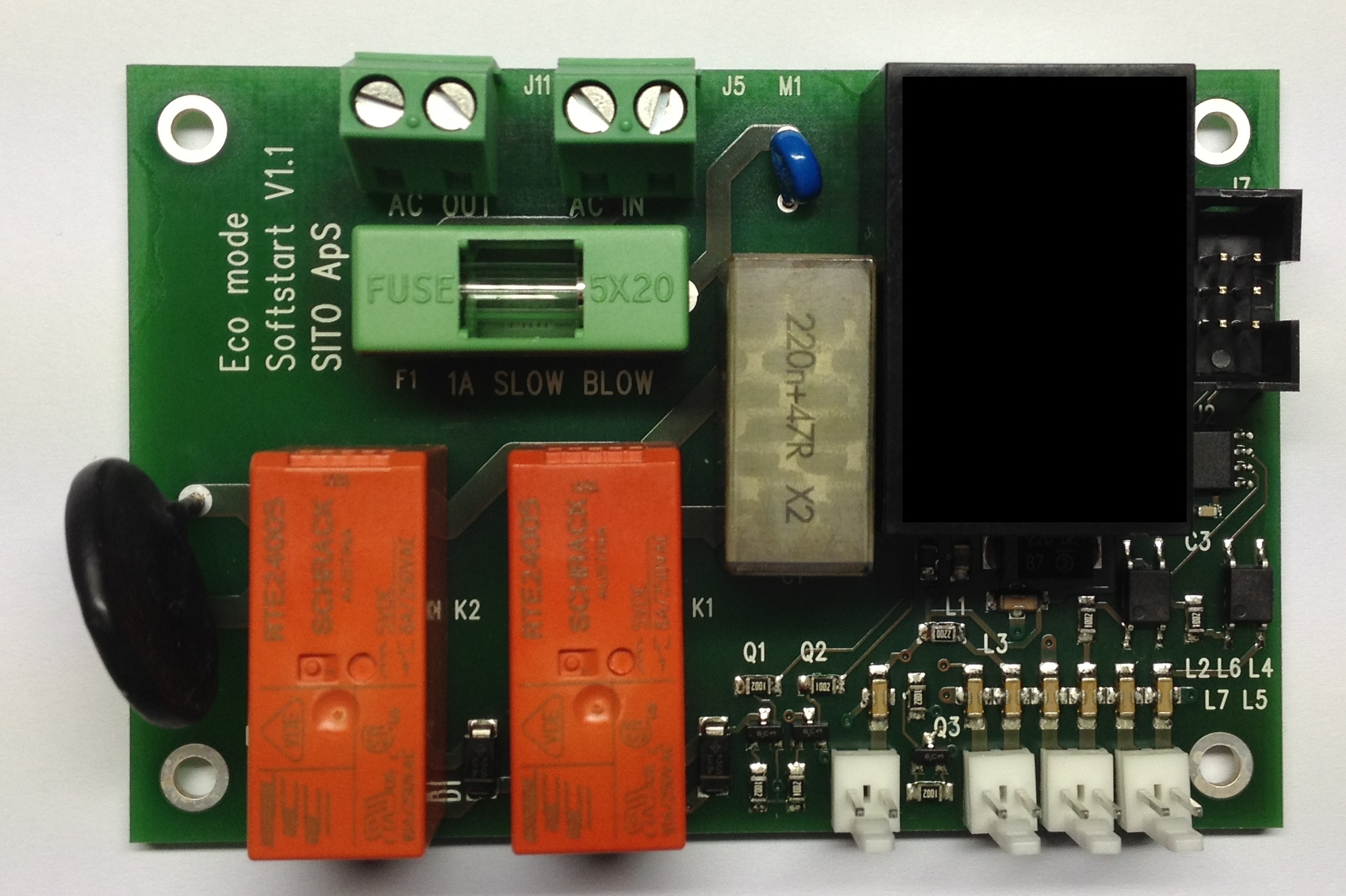

Regarding my softstart module:
Normally the software on the microcontroller on the softstart is configured in such a way that connector J9 is for remote start (That is if you have an preamp with an remote output to enable an power amp).
I can offer a different software for this module which make it possible to use the output DC protection from lazycat to switch off the amp is case of DC on the speaker terminals.
By using J1 and J9 together with an new software it is possible.
By the way. The Softstart modules i ship is black to match the TSSA V1.7 boards.
- Sonny
- Sonny
