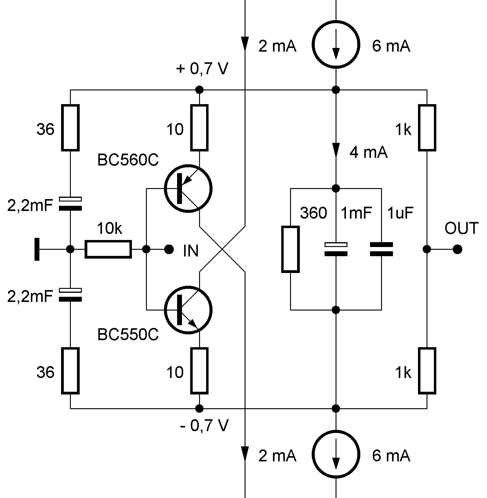

Let' s just not forget what's SSA principle all about, it's all about simplicity in symmetry. Basic input current feedback SSA core from the pic is well tested and can be the base for many type of VAS front-end-s. Forthcoming CSA will be the most complex version based on SSA core and I believe also the best all-rounder of them all. 😉

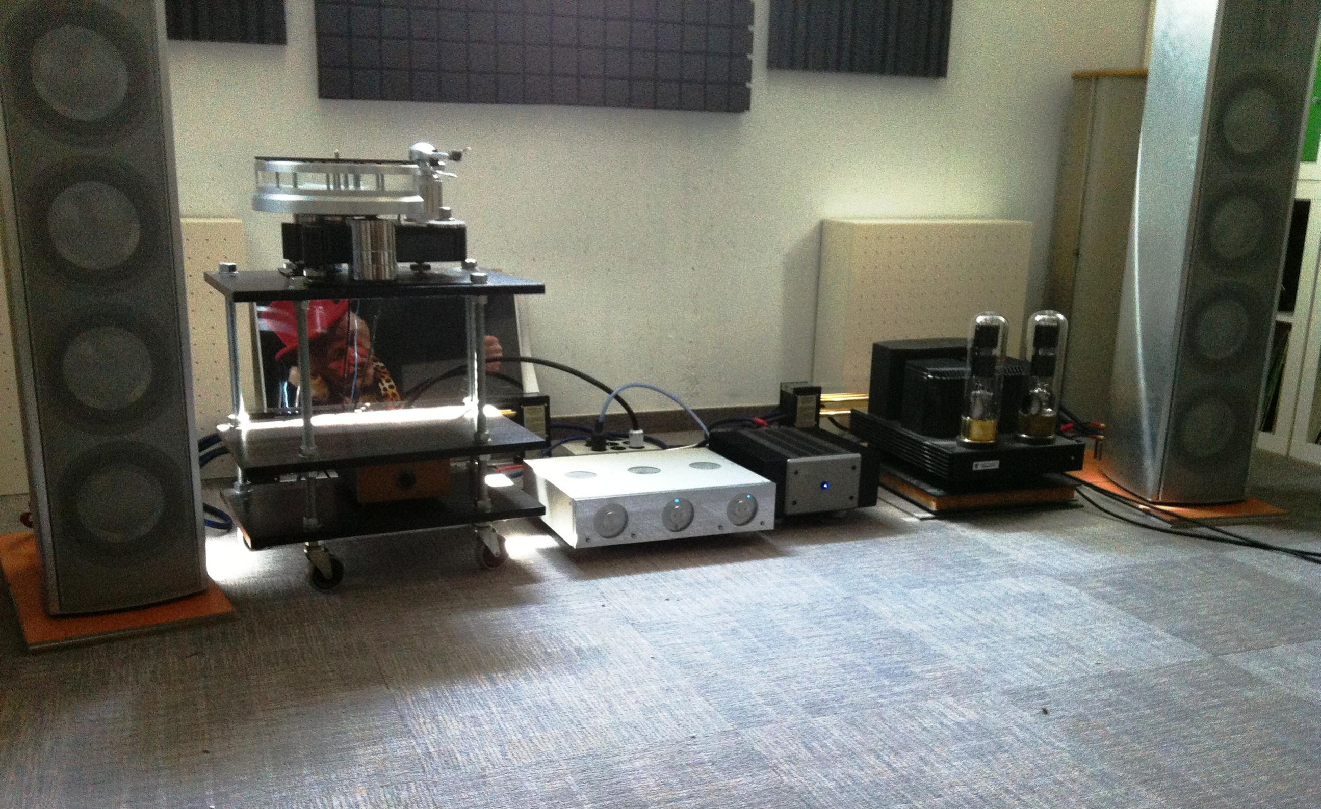

This Wednesday it will be tested against an AR VT100 on JMLAB grand Utopia.
I am excited to get the judge!
So it is judge day. 😀
It was compared against the AR system with AR preamp, AR VT100 and AR cd player as source.
In comparison with his signal path from CD to speaker it has the exactly same sound profile as the AR.
There was no presence if audible range at all.
He said it was like listening in slowmotion. You can here everything so that it feels like slowmotion.
There was only a little less wide stereo image but we are talking micro differences.
The level of detail is very high. The AR did have a little more fairydust.
But we talk a AR preamp and power amp worth >20000€
A wish would be a little more headroom -> more power.
