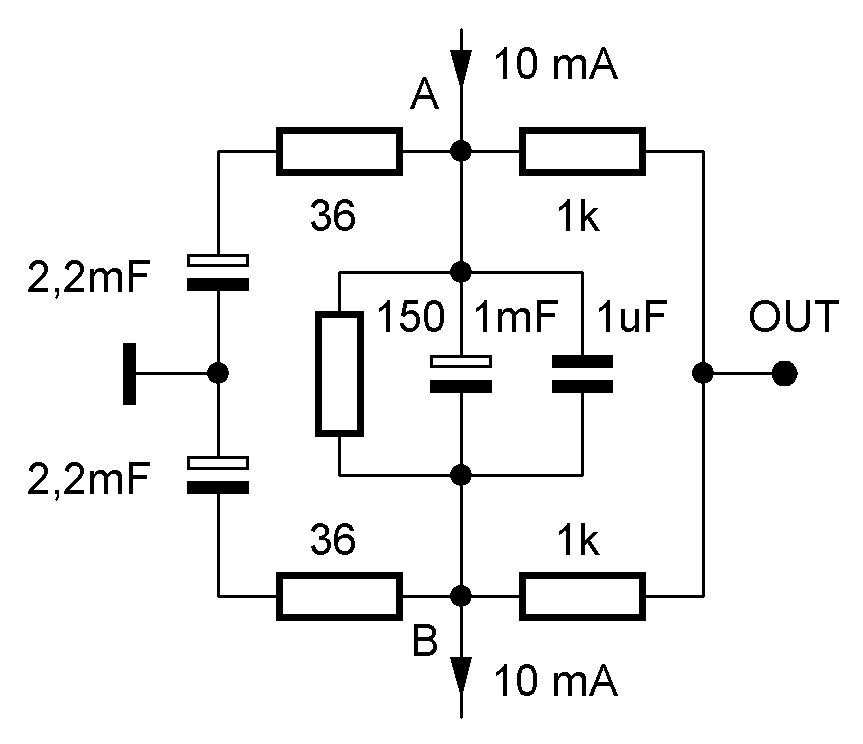

I played with your schematic and found while running Monte Carlo that a practical imbalance in the mirror currents can cause quite severe cross-over distortion. When I say practical, I mean real life components.
Hi Nico 😉
I think the effect of increasing current through TSSA mid-bridge load would result in the same bypassing way like all CCS-s Sonny choose. Collector load resistor (Rgs) can also be 10 k or any other prefered value (defined by mid-bridge load value) in this much more simple solution, which only aim is to prevent mid-bridge DC potential (bias current) from being unstable. Also because the mid-bridge resistance is positioned symmetrical to GND, no imbalance (DC offset) can be expected out of this variant, hopefully. 🙄

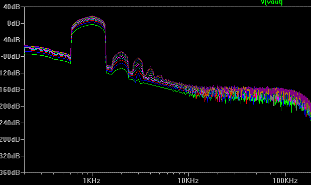

Hi, thanks Sonnya. I have simmed your circuit with 2N5401 and BD139 for the drivers. 1.5% THD at 20kHz. I think it's good for a hexfet (should be lower with laterals). And it is fast too. But too many stages, even tho the topology is a plus. And I can see what was mentioned by Nico. I don't know if it has audible effects but believe it or not top amps just don't have "issues". Later I will build this and compare it with my version of Mooly's M1 Hexfet.

Yes the SS frontend (and FB) I think gives the unique character. I don't know which part of the simulation data is responsible for that. The phase data is I think unique. Almost no issues with 4th order and higher. The spectrum is consistent with power. I like this amp except the 20kHz distortion, and the relatively high noise floor that has effect with bass quality (but can be minimized by careful choice of bypass capacitors and power supply). I have seen tho in my simulation, that this can be cured with integrated J/FET front end.

May be I'm using a wrong terminology when I say "noise floor". May be I'm doing it the wrong way, but I cannot see the effect of power supply on what I think is the noise floor in the chart I posted. My Mimesis clone for example, has the "base" for the FFT chart at -240dB. I have seen correlation between this and bass quality.
So from the chart I posted, whatever power supply that I used, the bottom of the 1kHz signal for example won't go down to -180dB.

I was confused also reading that thread. Kenpeter modified your circuit and showed the FFT chart. To me the result is reasonable knowing the topology. But you mentioned on that thread that your circuit has better result and you showed an FFT where the noise floor is at -240db! I thought that was magnificent but seemed to good to be true. That kind of performance imo is possible only if the output lacks drive.
But my quick simm was different with yours. And you are talking about fewer parts than TSSA? 😕 I was talking about your amp in the pdf above. It is no simpler than TSSA. I don't have pdf reader here so I attached Kenpeter's version:

You have stated that the Sauermann has tighter/better bass. I believe this can be seen from the simulated noise floor. In general, simple class-A amps have this similar problem. And I think F5 should be used as a reference in this league.
And you have stated also that these amps probably not good enough for rock (fast and complex music). That's the challenge. Good enough is not good.
