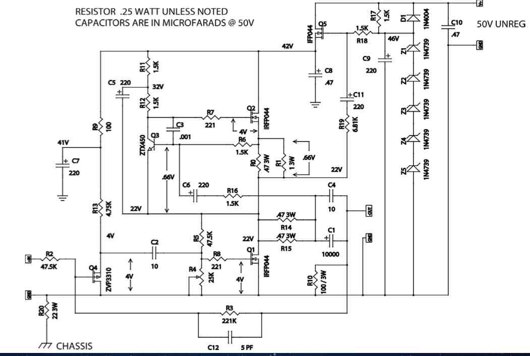

Here is the Zen 4.0
Would it be possible to run this balanced and using two positive supplies only, in the process make it DC coupled ?

Open up a new can of worms ?
I just put this circuit online as a diversion.
What i really would like to do is making the simple symmetric as good as we can.
I have a weak spot going out of the drains. That reminds me of work i did on phono stages.
The current mode approach. It holds some promise.
My question is : what happens if we connect a real speaker and not a dummy load ?
A current output with current feedback is superbly immune to loading.
