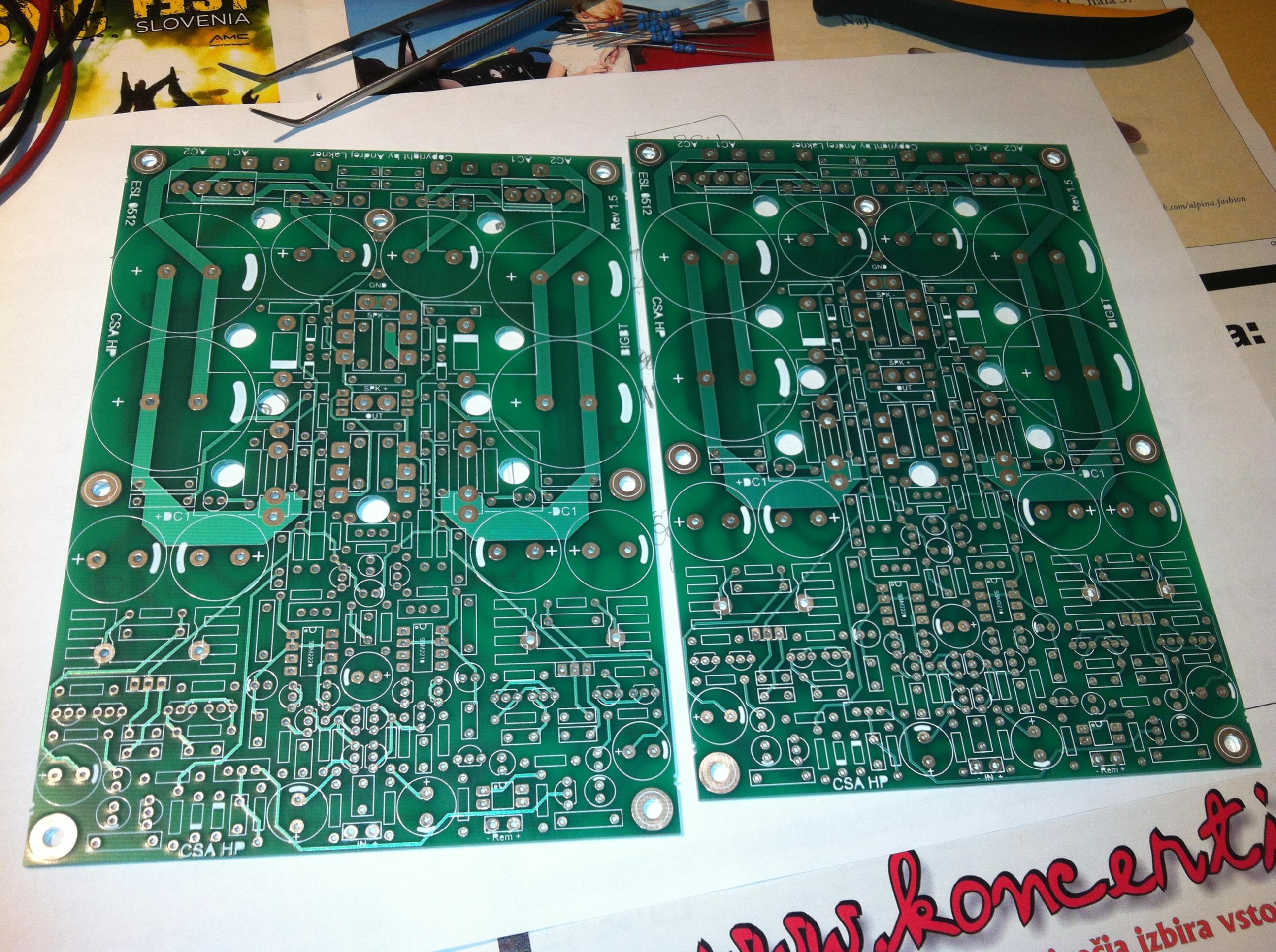

Now I am at final QC of CSA PCB-s which will go into production next week.

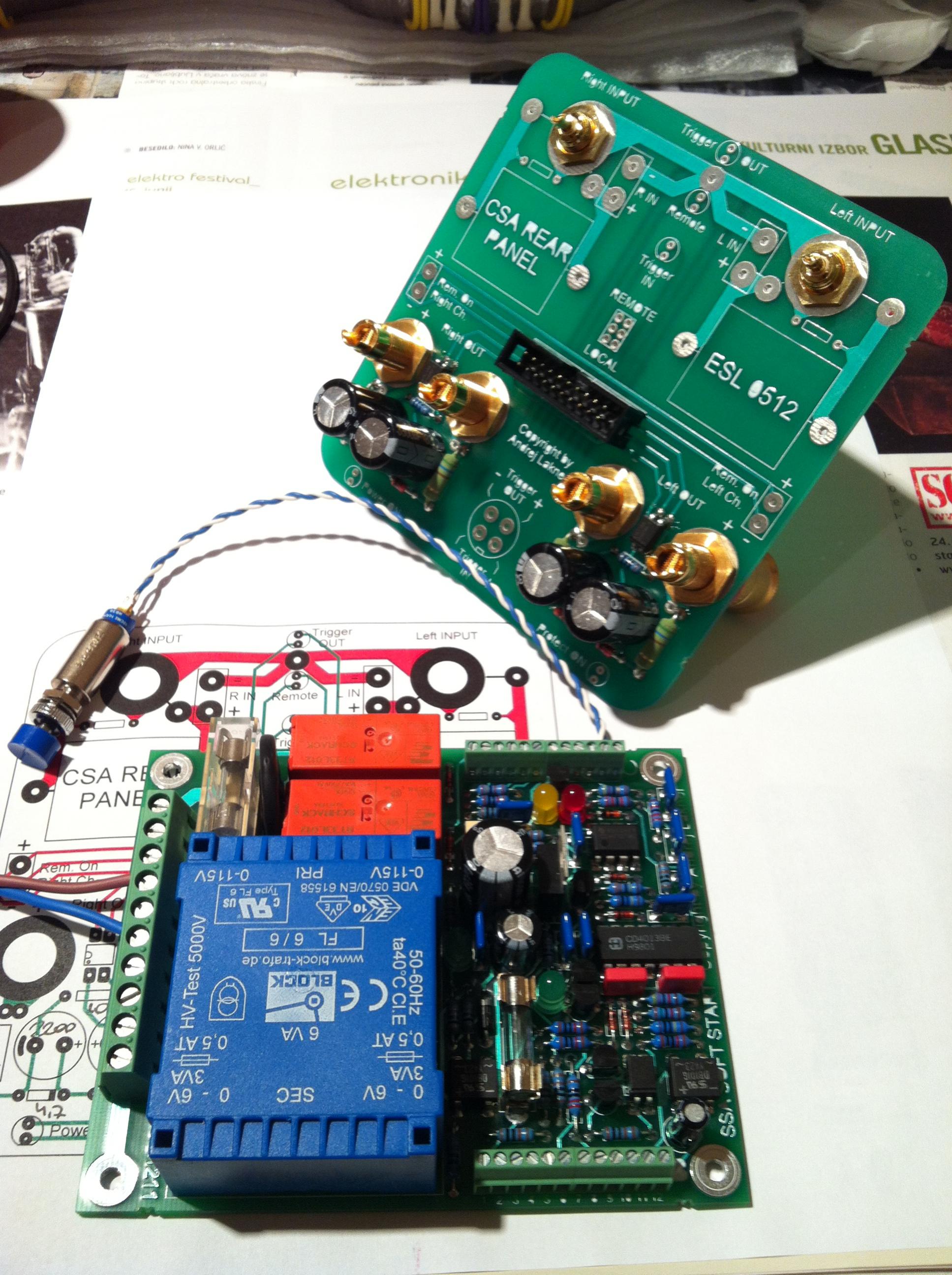

Michael i Think you should be proud of your latest layout. It looks good and it does Sound good as well.
Andrej i Think we need to meet some day. Your assembly skills looks good. Very good.

Great news, LC! Boards look....simple 😀
