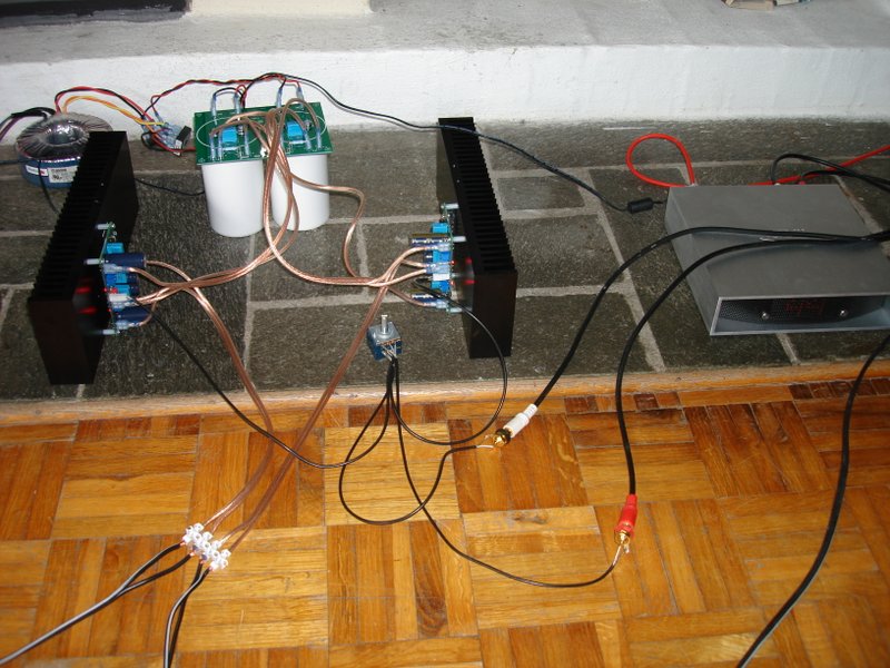

There is a way to get the second harmonic away ( e.g. not totally ).
Use two TSSA amplifiers in a balanced setup per channel. I would do it with a Thats chip or even better with a transformer but then a good one is expensive.
Many DACs give a balanced o/p so going balanced from DAC to Speakers is in fact the simplest option - I will be testing this option later this year.
I guess if you need transformers you have either have a S/E o/p DAC or an analogue S/E source.
I will try that idea. First with many small input transformers that I have on hand (but never tried to find out how bad they really are). Next, with JFET circuit (the TSSA benefits from such circuit in the input)

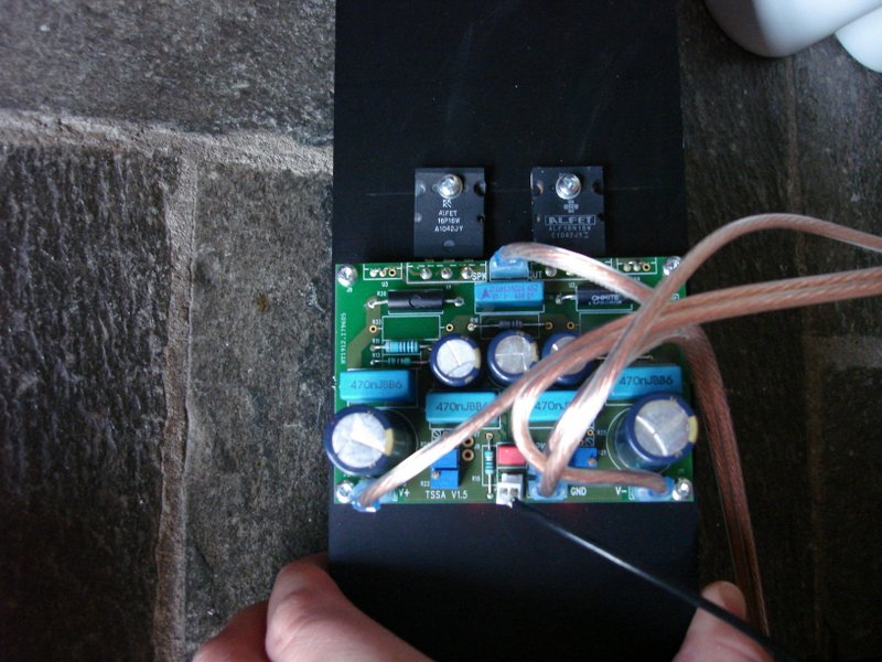

The boards are 75mu copper, and NiAu plated.
The boards without SMT Will cost 21€ each.
With SMT They Will cost 39€ each.
With All parts They Will cost 103€ each and it is without heatsink.
I Can also deliver Them assembled and testet on a heatsink.
This is for the TSSA board only.
The psu board needs to be calculated.
It May Sound expensive but there is No cheap parts in this one. Only good quality parts.

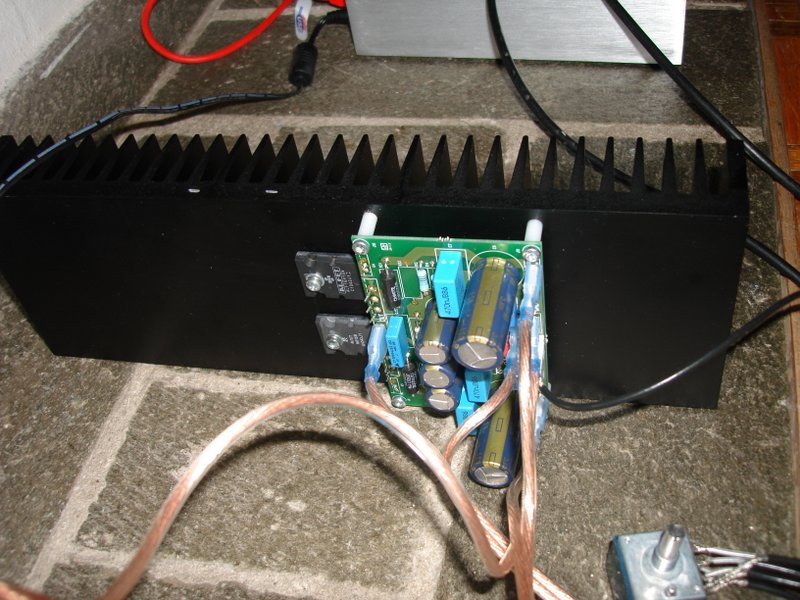

One benefit of a balanced amp i was told is that pollution from the PSU into ground does not reach the speakers. My TSSA prototype is dead silent though, it does not even have on ON-Off thump.

Hi all.
They have been working for 4 days with no issues at all.
Beautiful soundstage.
No noise at all.
No pop on noise.
